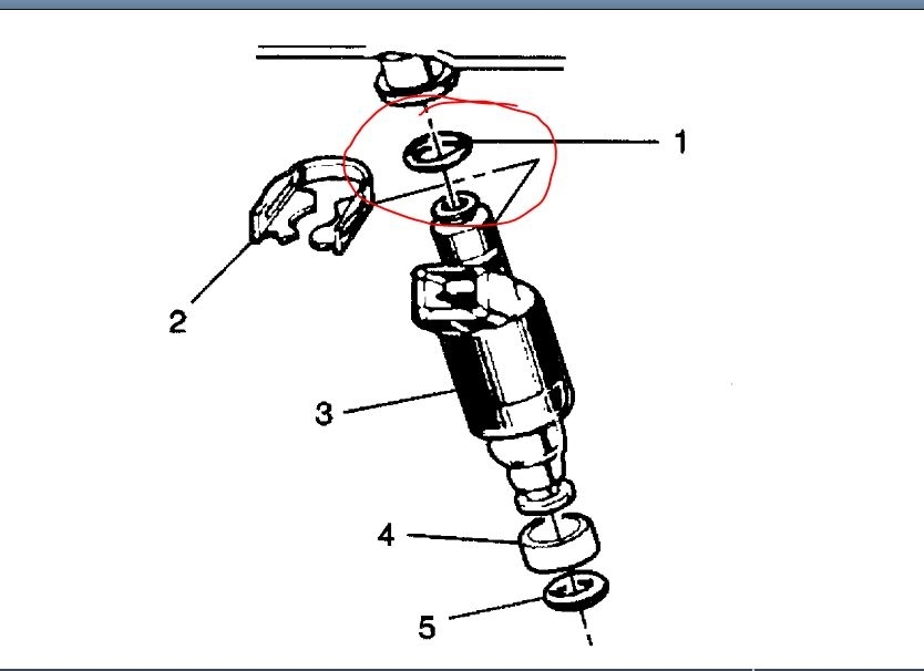

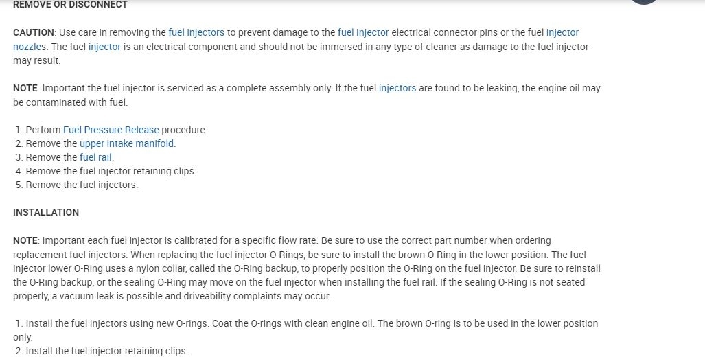

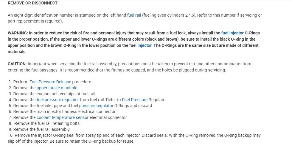

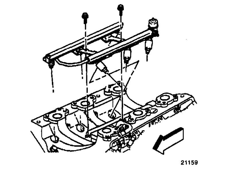

You need to remove the fuel rail from the car and do this on a bench. You remove the clip that is shown in the picture and the injector will come out.
When installing the new o-ring, use Vaseline to lubricate the o-ring so it does not get damaged when you push it up and in. Then reinstall the clip to hold it.
