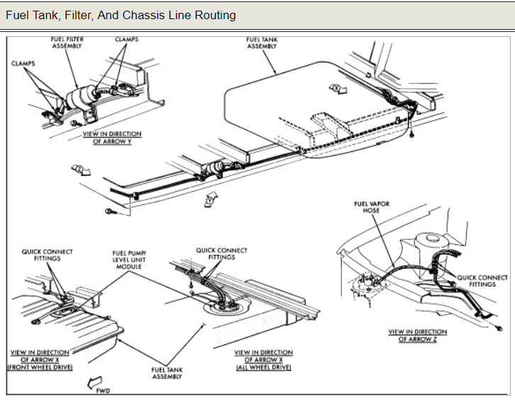

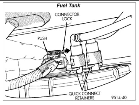

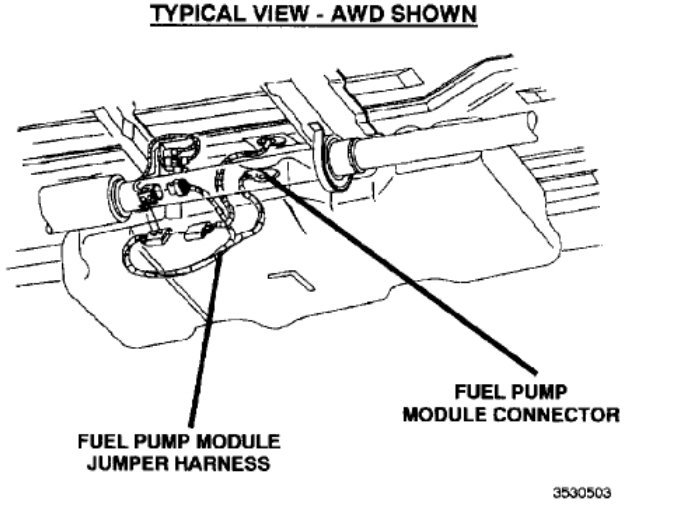

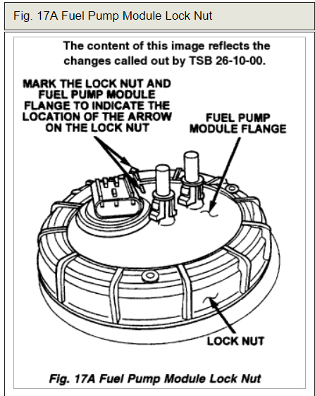

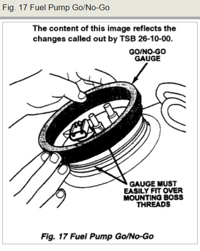

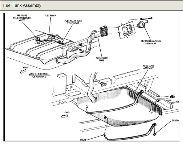

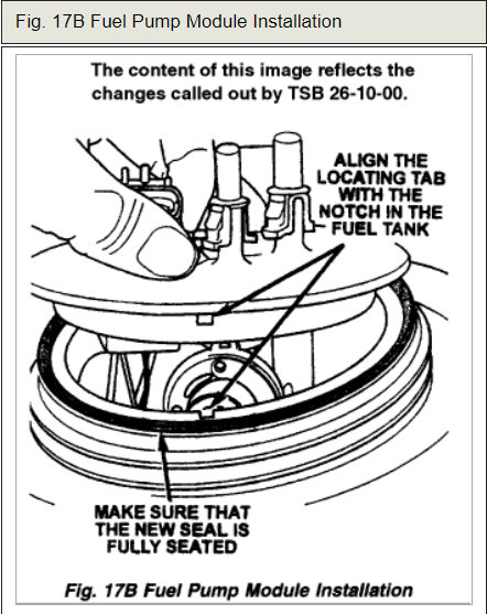

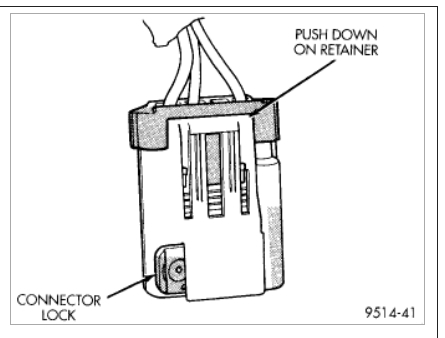

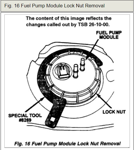

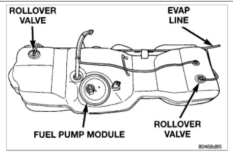

This is common when the fuel level sensor goes out. I have included instruction in the diagrams below to help you fix it. You will need a new fuel pump module. Check out the diagrams (below). Please let us know what happens.
