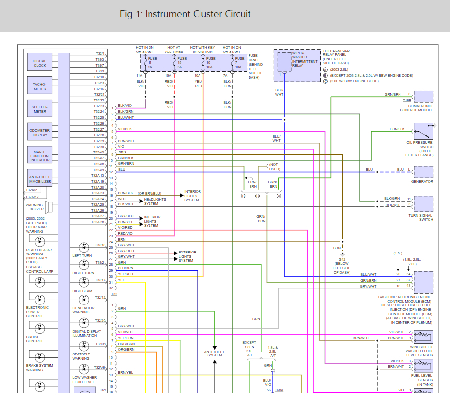

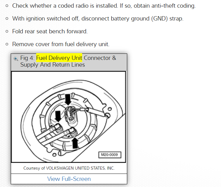

Hey guys,
The fuel gauge on my car will only go to half full. If I fill the car up it will stick at half, and when I go below half the gauge will go down as normal.
Anyone any ideas?
Thanks
