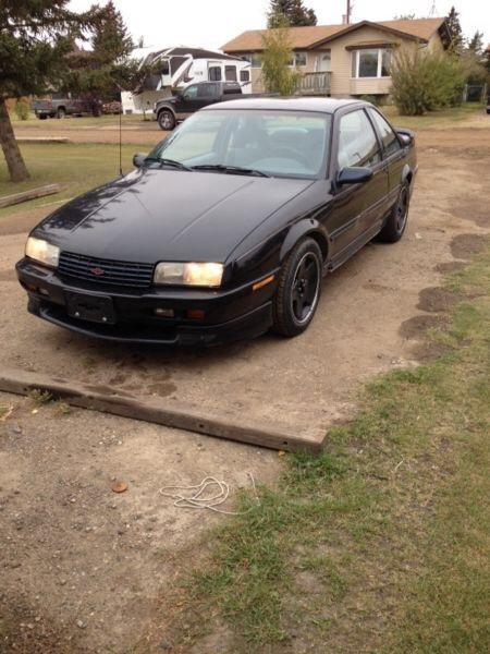

"My fuel gauge in my 91 beretta GTZ says it's half full no matter how much fuel I put in. I just replaced the fuel pump along with the fuel float. Before I did that it was reading full but there was no float, and my oil pressure gauge goes up beyond max when I step on the gas, it's like it is attached to the tach, also my engine comes on once in a while, only after the car has warmed up to running temp. And it doesn't stay on. It shuts off after a bit. What could my issues be?
