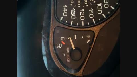

Ever since I replaced my original pump with a brand-new OEM pump, my fuel gauge has been moving up and down sitting still and going down the road. I already checked the float arm, and everything appears to be fine. Not getting hung up anywhere.
Jan 31, 2025 at 2:37 PM
Thanks for the video, it helps. this happens when the small ground wire going to the fuel tank sender is not connected to ground. Can you confirm? Also, when you say the OEM pump was it the complete pump module with fuel level sender?

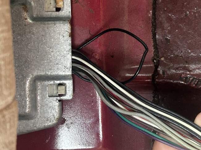

I pulled my seat, and I saw these bunch load of wires. Which one would we need to check?
Feb 1, 2025 at 1:02 PM
Did the new unit come with the sender as well? It should be blk or blk/wht wire. Also, there might be a ground wire at the fuel pump module as well, black signal wire.

Yes it did. It was a complete assembly. And what I found out is the back seat is causing it to go out of control. When it’s out, it stays fine. I wonder if a ground wire in that harness is being pinched.
Feb 2, 2025 at 9:16 AM
A pinched wire can cause this issue yes, also recheck the ground wires.

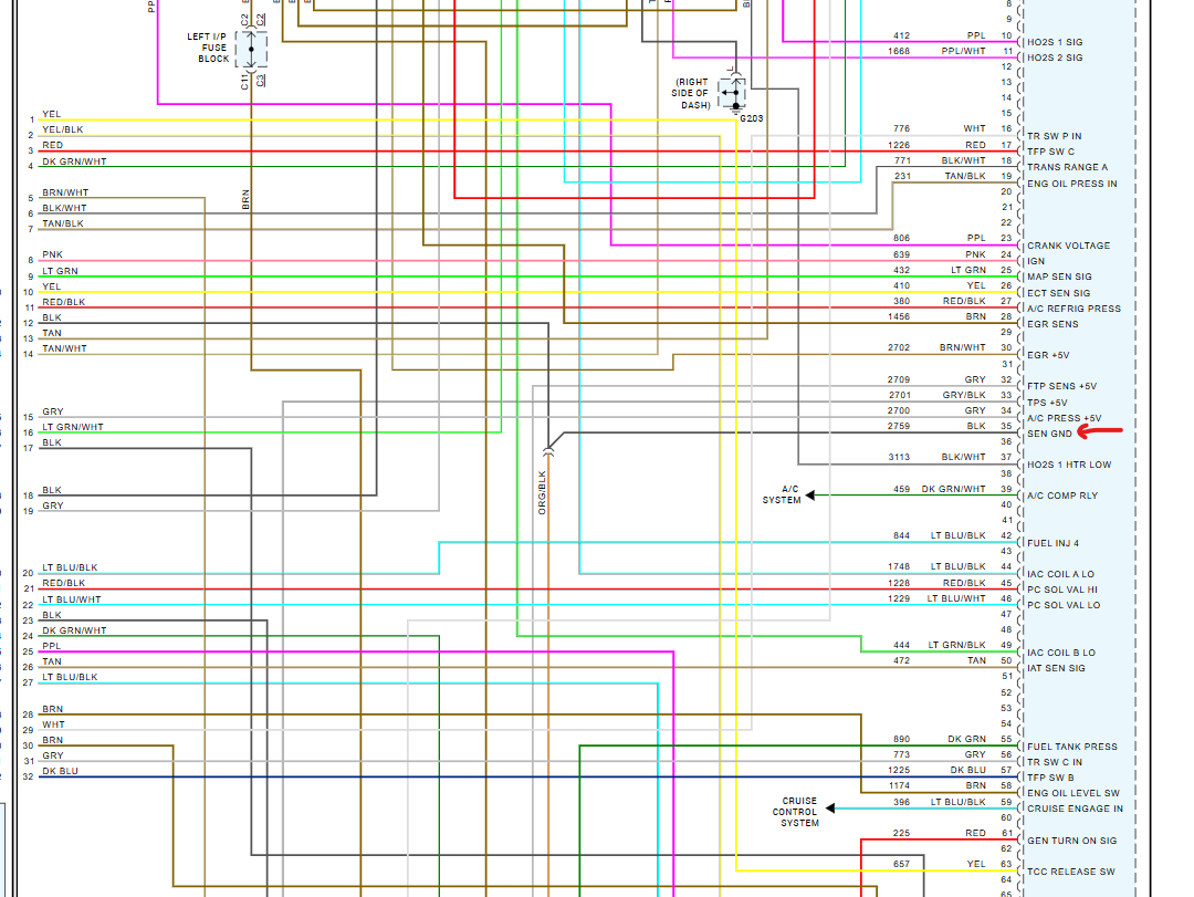

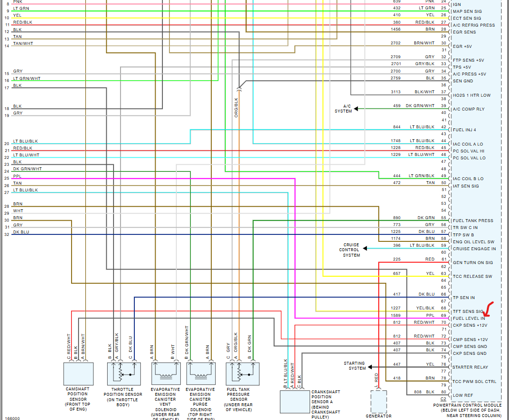

Yes, the sender has a ground that goes to the PCM, I would check this wire, I have a guide to help, and I included the fuel sender wiring diagrams for clarification.

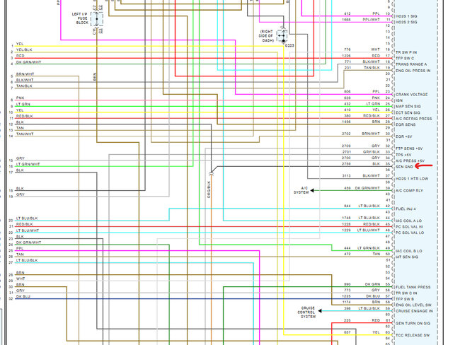

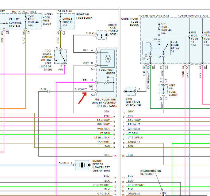

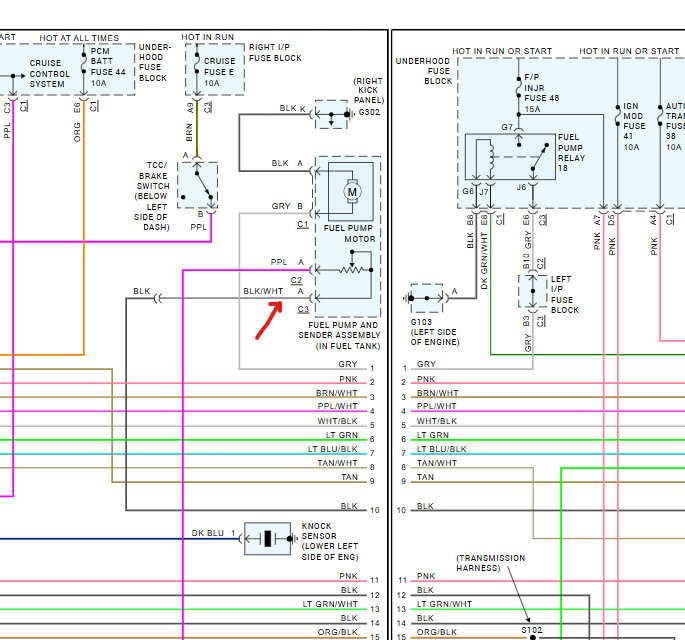

Yep, that would be an open wire, Let double check the blk/wht and purple wire from the sender to the PCM, here is the other wiring diagram you need besides the diagrams above, use the guide above as well. Pleas let me know how it goes. Check out the images (below).
Jun 8, 2025 at 2:36 PM

Yes, from the fuel sender to the PCM.
