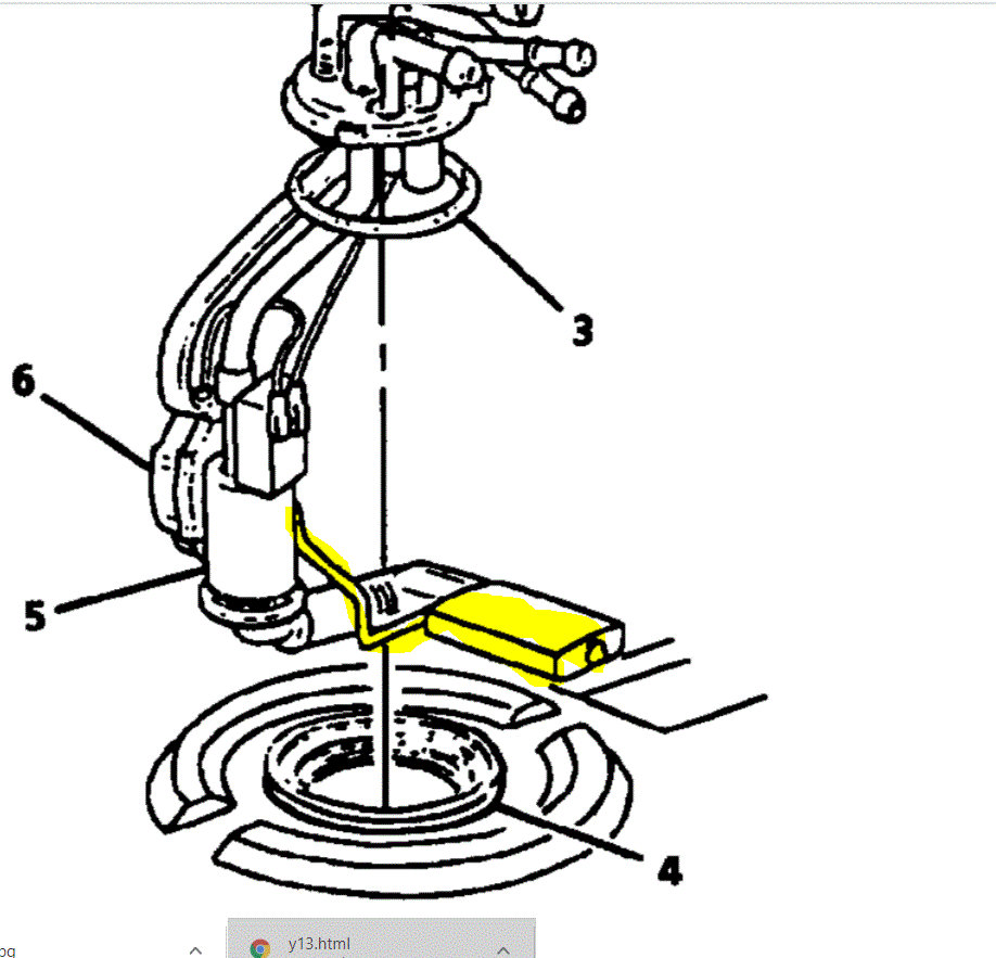

When you replaced the pump, was it a complete unit including the float and rheostat assembly for the fuel gauge? Does it stay on full and never move?
If it is staying on full and not reacting from that point, it's easy to snag the float when installing it causing it not to move. Take a look at pic 1. When you reinstalled the pump assembly, was the highlighted component free?

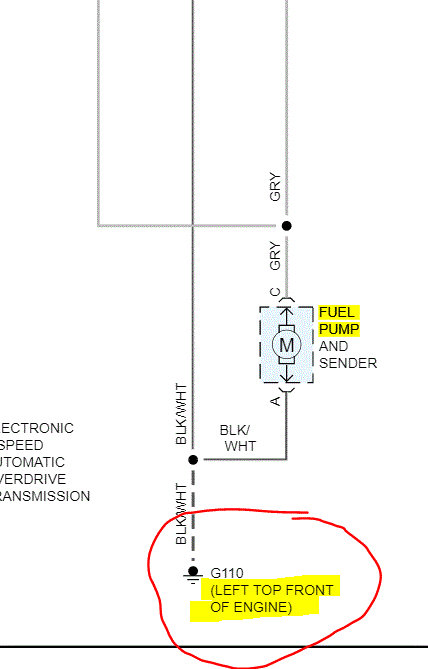

Is the fuel pump working? If it is, then the ground is good. They both ground at the same point. As far as the ground, it is at the top of engine. See the attached pic.

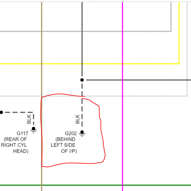

That ground is on the left side of the instrument panel. See the attached pic.
Let me know if that helps.

Hi Joe thanks! Couldn't make out last word of ground location. I can make out " right behind left side of ?" Can't make out last word even with magnifier.
Can you please help?
Thanks,
Mark
Aug 13, 2020 at 7:29 AM
CERTIFIED EXPERT
110,175 POSTS
I see that. It can't be read. It says of IP which is instrument panel.

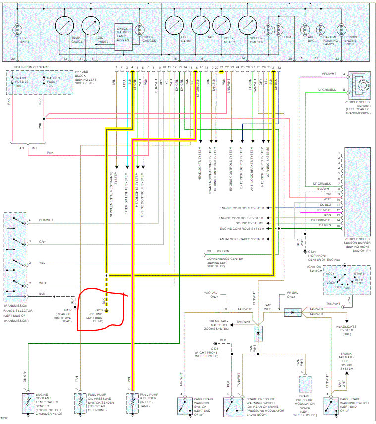

Hi Mr Joe! Thanks again for info.
I found grounds as diagram shows. The ground to rear of right cylinder head was broken in half. Can I ground this wire elsewhere? Exhaust manifold? Intake manifold?
