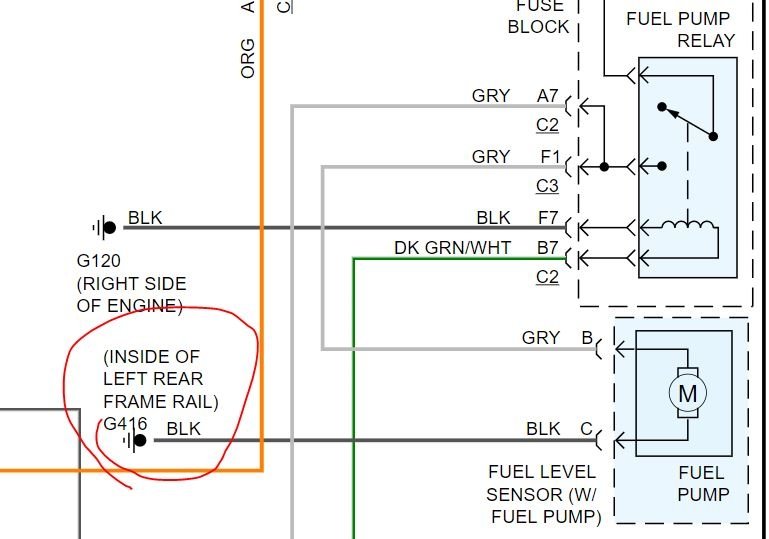

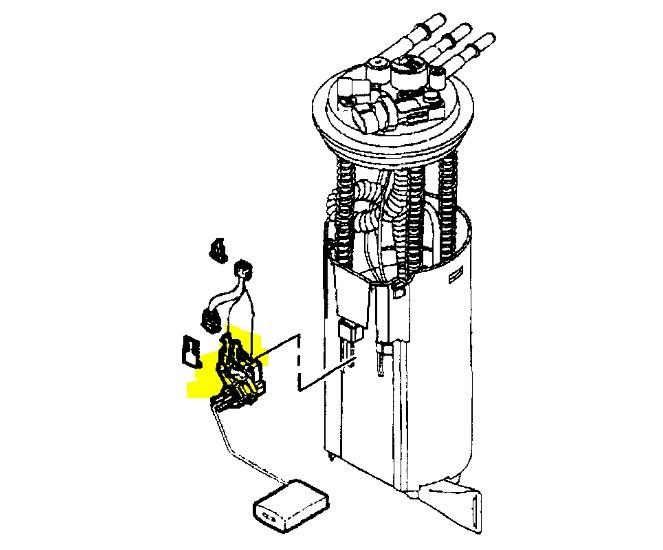

Most of the time the tank registers full tank, every now and then it will register empty. Before replacing the fuel pump I was wondering if there might be a bad ground causing the issue. Any ideas on what to look for
