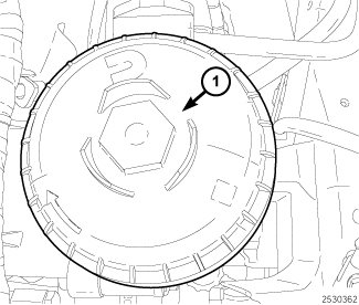

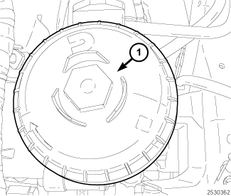

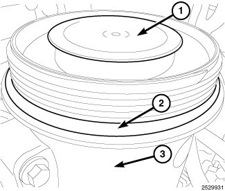

Filter 1
FUEL FILTER 1
NOTE:
Refer to maintenance schedules in this manual, or the Owner's Manual for recommended fuel filter replacement intervals.
Clean all debris from around filter canister (1) and canister cover.
Using a socket, rotate the fuel filter housing cover (1) counter clockwise and remove cover (1).
Remove and discard the O-ring (2).
Remove fuel filter element (1).
___________________
Here are the replacement directions. At the end of the directions, it explains how to reset the computer for the service. See picture 5 for reset.
FUEL FILTER 1
CAUTION:
Do not pre-fill the fuel filter with fuel. Severe damage to fuel system and injection system components may result.
NOTE:
The engine has a self-priming low-pressure fuel system (Refer to 14 - Fuel System/Fuel Delivery - Standard Procedure) .
NOTE:
DO NOT USE brake cleaner, carburetor cleaner, or similar harsh solvents for cleaning the internal housing walls.
Ensure that the internal housing wall is clean of debris before installing a new fuel filter cartridge.
Install fuel filter element (1).
Lubricate with clean engine oil and install the new O-ring (2).
Install the fuel filter housing cover (1) and tighten to 31 N·m (23 ft. lbs.).

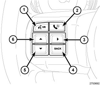

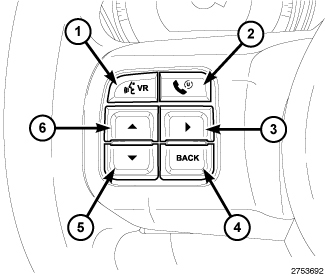

_________ Reset
Once the fuel filter maintenance has been preformed, the Fuel Filter Life monitor can be reset by:
Vehicle in RUN with engine OFF (no RPM)
Hold the right arrow (3) down to reset the monitor.

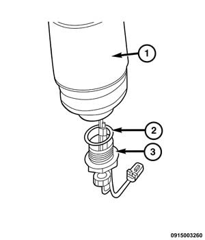

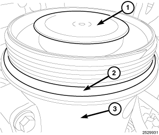

Filter 2
FUEL FILTER 2
NOTE:
Disconnect and isolate both of the negative battery cables.
Raise and support the vehicle (Refer to 04 - Vehicle Quick Reference/Hoisting/Standard Procedure) .
Clean all debris from around the secondary fuel filter area.
Open the drain and drain fuel from fuel filter.
Disconnect the water in fuel sensor wire harness connector.
Remove the fuel drain/water in fuel sensor assembly (3).
________________________________________
FUEL FILTER 2 install
Install the secondary fuel filter element (1) and tighten finger tight. Tighten the fuel filter an additional ½ turn.
Using a new O-ring seal (2), install the fuel drain/water in fuel sensor assembly (3) and securely tighten.

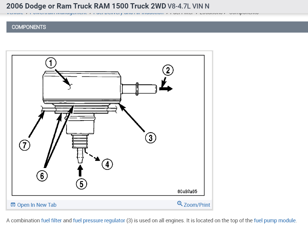

where is the gas filter located ?
Aug 27, 2020 at 11:47 AM (Merged)
RASMATAZ
  • 75,992 POSTS

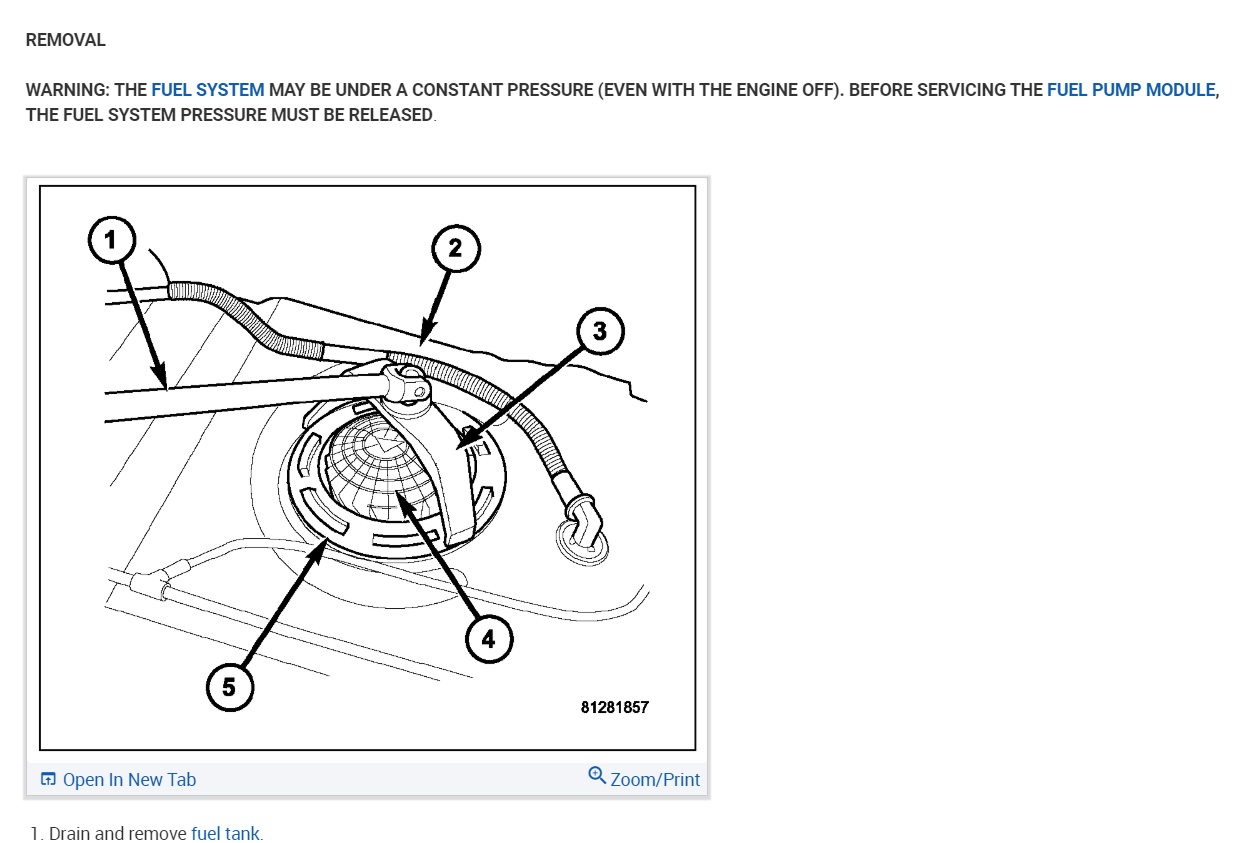

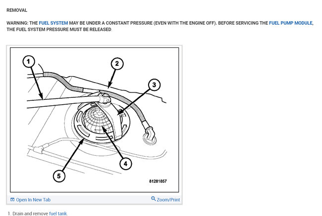

The fuel pump module assembly is located on the top of the fuel tank. The complete assembly contains the following components:
This video will help
https://youtu.be/6de-1mIpzi8
A combination fuel filter/fuel pressure regulator
A separate fuel pick-up, or inlet filter
An electric fuel pump
A lockring to retain pump module to tank
A soft gasket between tank flange and module
A fuel gauge sending unit (fuel level sensor)
Fuel line connection
The fuel gauge sending unit may be serviced separately. If the electrical fuel pump, primary inlet filter, fuel filter or fuel pressure regulator require service, the fuel pump module must be replaced.

fuel pump is in the fuel tank and the filter is back there as well.

fuel filter is located on top of the fuel pump in fuel tank

What's the symptom? Except for the diesel engines, you will never solve a running problem on a Chrysler product by replacing the fuel filter. On the newer trucks, the filter is inside the gas tank.

Its right on top of the fuel tank with the fuel pressure regulator.
