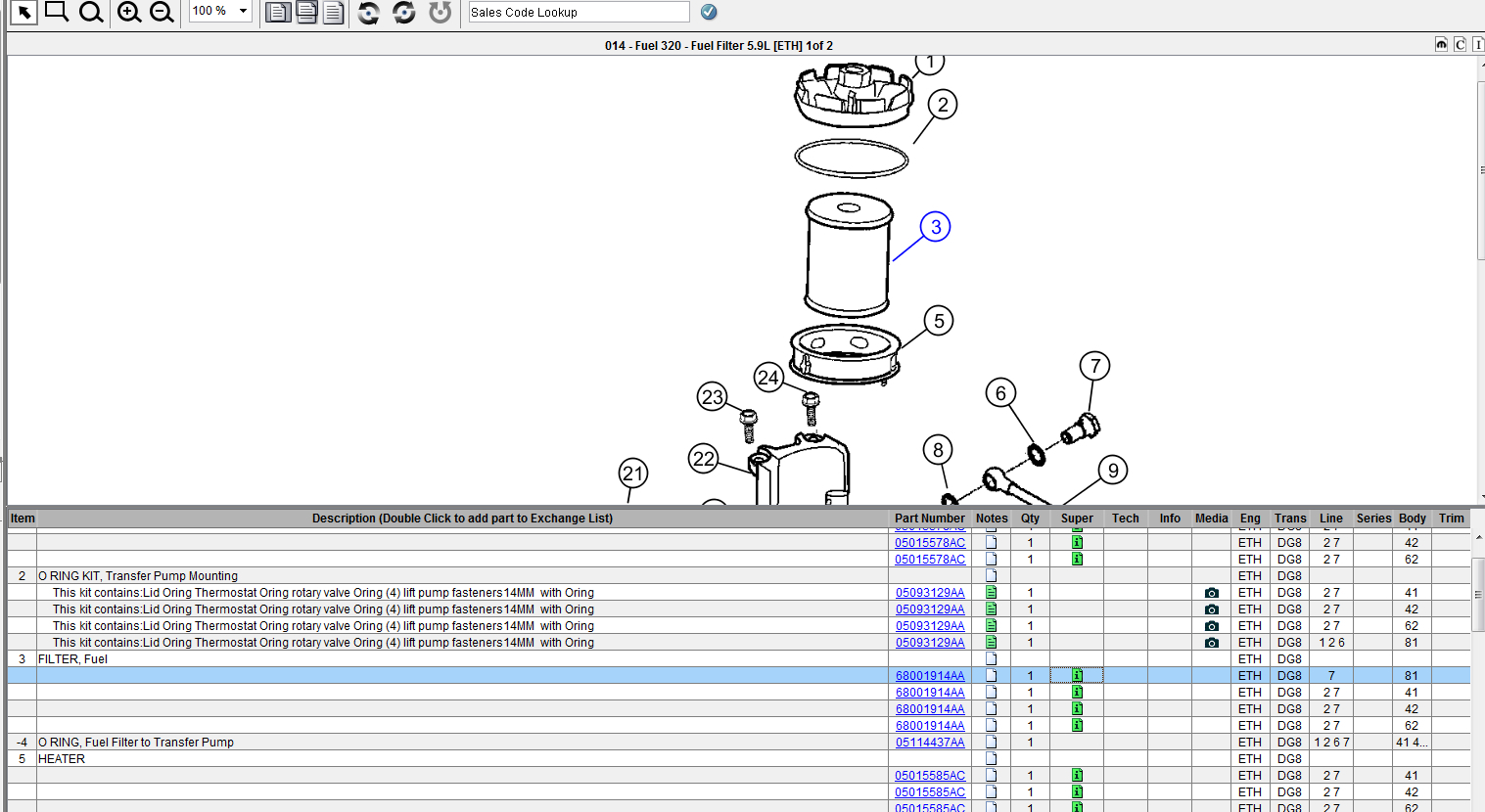

What is the part number and manufacturer of the filter that you bought? Most likely they "think" that this filter will fit the 5.9L and 6.7L or their book is wrong and giving you the part number of the other filter for the 6.7L. Or they simply looked it up wrong. This year was an odd year. You could still get the 5.9L in a 2500 but you could also get the 6.7L.
The Mopar part number for this is 5015581AB and that should be used as other aftermarket filters just don't filter as well.

When I looked up the Mopar filter for my truck, it gave me this: 68001914AB.
Aug 29, 2020 at 4:45 PM
I looked it up directly from Mopar's site and I get the same number. Did you just purchase this truck? What is the last 8 of the VIN and I will look it up directly from you VIN but I imagine it will be the same.
