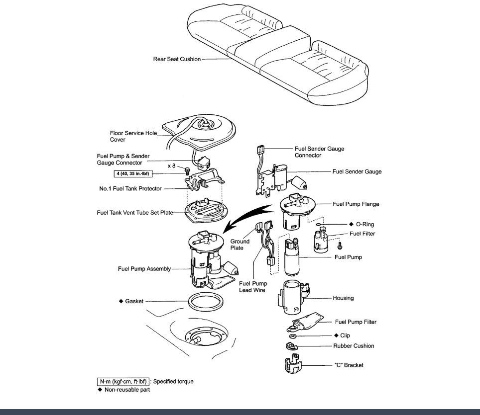

I am having trouble finding the fuel filter.
Nov 28, 2019 at 8:14 AM
SCGRANTURISMO
  • 4,897 POSTS

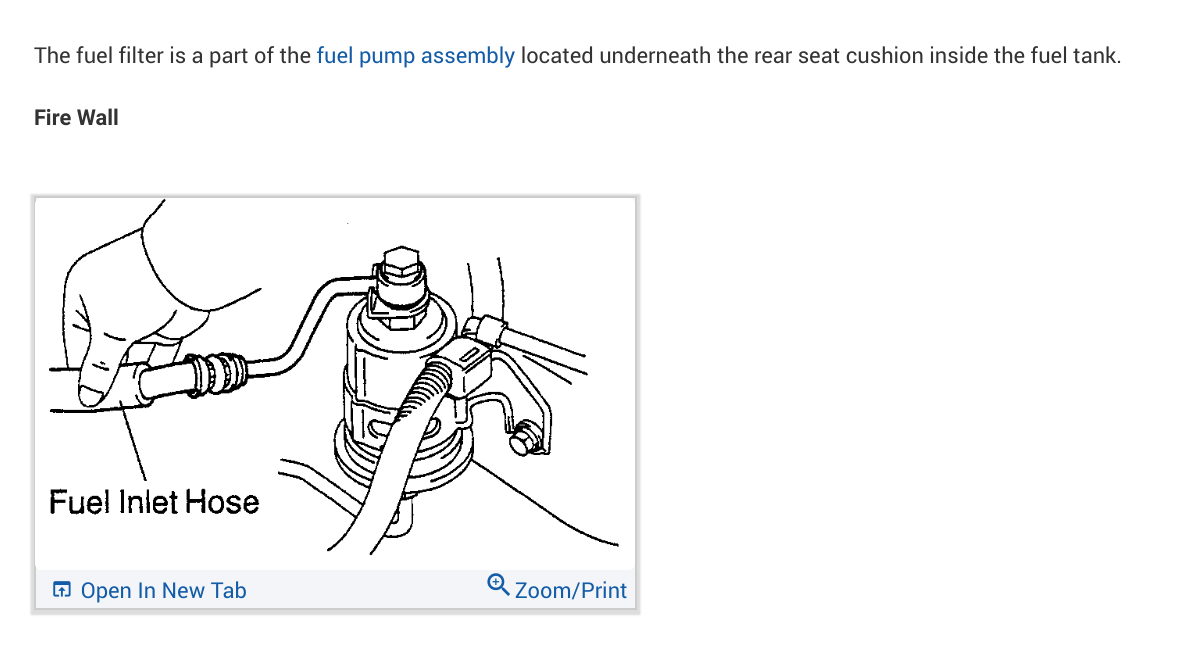

The fuel filter is an integral part of the fuel pump, which is located in the fuel tank. In the diagrams down below I have included an exploded diagram of the fuel tank/fuel pump/fuel filter assembly for you. I hope this helps.
