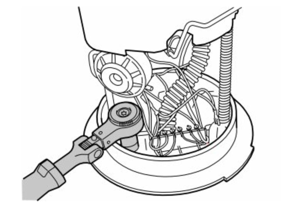

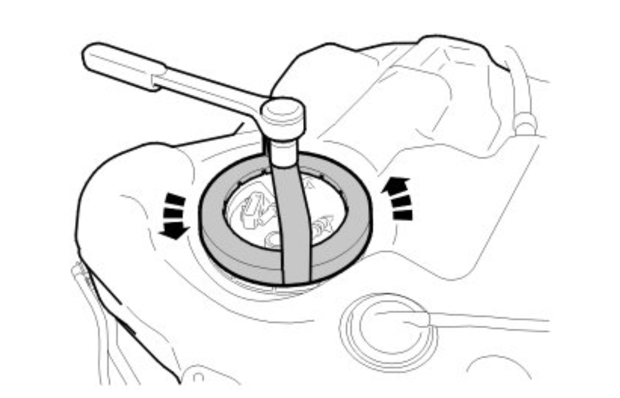

Remove:
the large plastic nut, 1 pc. Use: 999 7111 Spanner See: Vehicle > Electrical / Mechanical Repair > 999 7111 Spanner
the pump.

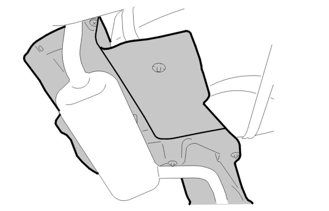

Removing the heat deflector plate
Remove:
the 7 plastic nuts
the heat deflector plate.

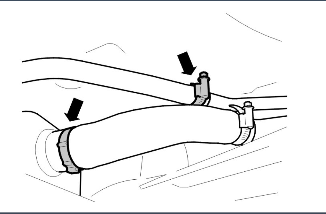

Detaching the hose connections
Remove:
the hose clamp for the evacuation pipe at the fuel tank
the hose clamp for the hose to the fuel filler pipe.

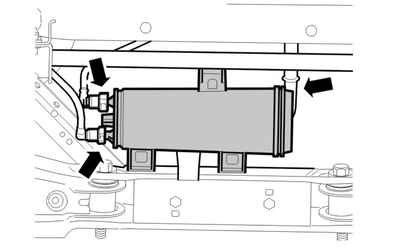

Removing the carbon filter container
Remove:
the hose (1)
the 2 pipes, secured using quick-release connectors (2).

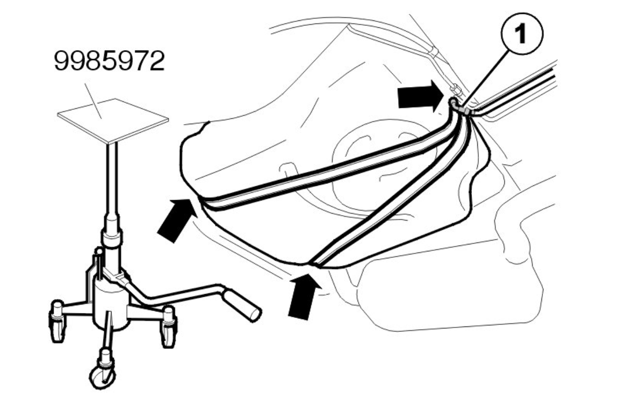

Install a mobile jack with fixture 999 5972 FIXTURE See: Vehicle > Electrical / Mechanical Repair > 999 5972 Fixture under the fuel tank.
Disconnect the fuel connection (1).
Remove the screws for the fuel tank straps, x 3.
Remove the tank retaining straps. Lower the tank slightly.

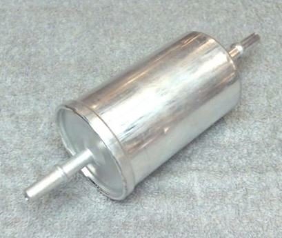

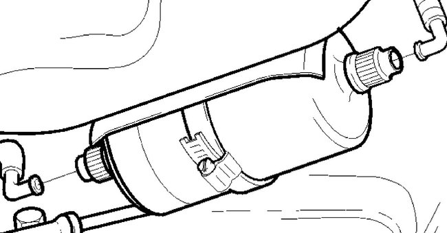

There are two filters on that car. One is inside the fuel tank as part of the pump assembly. To replace it you need to drain the tank and remove it. Then once it's out you can remove the retainer ring and remove the pump. The second unit is an inline filter located on the frame rail near the drivers side rear wheel. It has quick disconnect fittings on it.
When you say bad fuel, how is it bad? Something get into the tank like water, oil or diesel or? I ask because unless it's something real bad you could likely just use air pressure to blow the fuel back through the fuel lines, then pump the "bad" fuel out of the tank and replace the external filter if needed. Then add fresh fuel.
