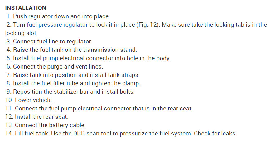

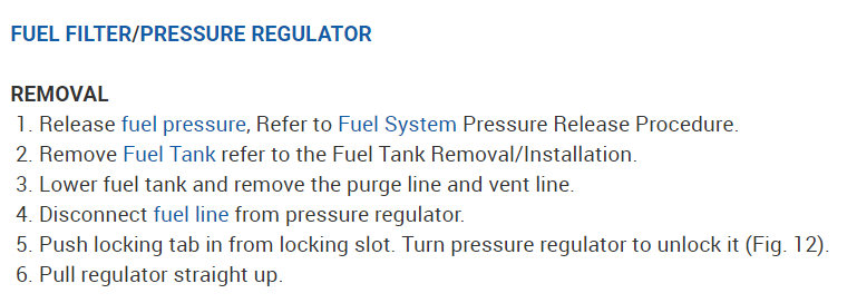

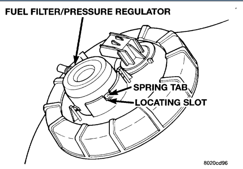

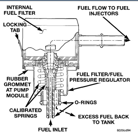

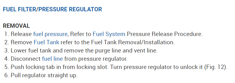

There is no filter located in between the pump and fuel rail. The filter is built into the fuel pressure regulator assembly that's mounted on the top of the fuel pump assembly that is mounted in the fuel tank. I've attached picture steps below showing how to replace the fuel pressure regulator assembly on your car. Hope this helps and thanks for using 2CarPros.
