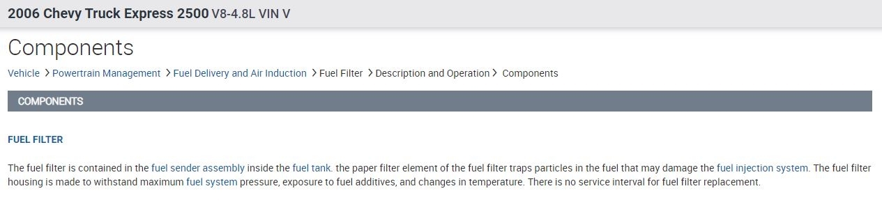

Fuel filter location on 2500.
They sold me one at O'reilly.

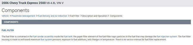

Hi, I'm Dan. The only fuel filter on your van is located inside the fuel tank on the fuel pump module. It's a strainer that usually is only changed during a fuel pump replacement. See the attached paragraph from AllData.
