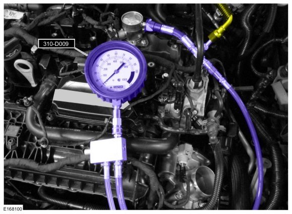

pic 1

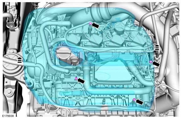

4. Remove the engine cover.
pic 2

6. Install the Fuel Pressure Test Kit between the fuel jumper tube and the fuel tube.
Use Special Service Tool: 310-D009 (D95L-7211-A) Fuel Pressure Test Kit.
pic 3
