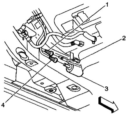

The fuel filter is located on the inboard side of the left frame rail. Attached is a picture of the filter and it's location. I've also included the replacement procedure below.

3. Disconnect the quick-connect fitting (4) at the fuel filter inlet.
4. Disconnect the threaded fitting at the fuel filter outlet.
