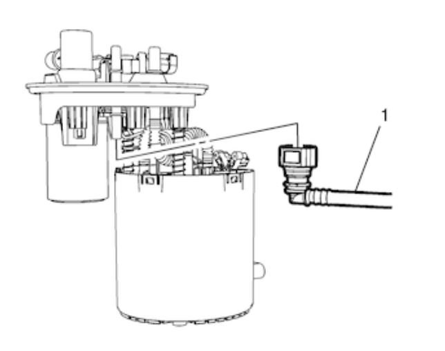

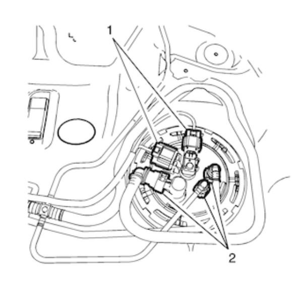

Anyone know where is the fuel filter located in the car listed above?

Good afternoon,
GM no longer has an external fuel filter. The filter is now part of the fuel pump assembly itself.
This guide should help
https://www.2carpros.com/articles/how-to-change-a-fuel-filter
It is not recommended to be changed unless the fuel pump itself is being replaced.
Please check out the diagrams below. Roy
