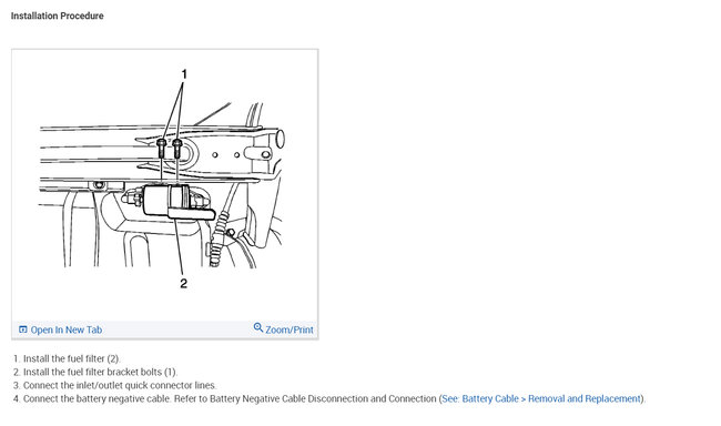

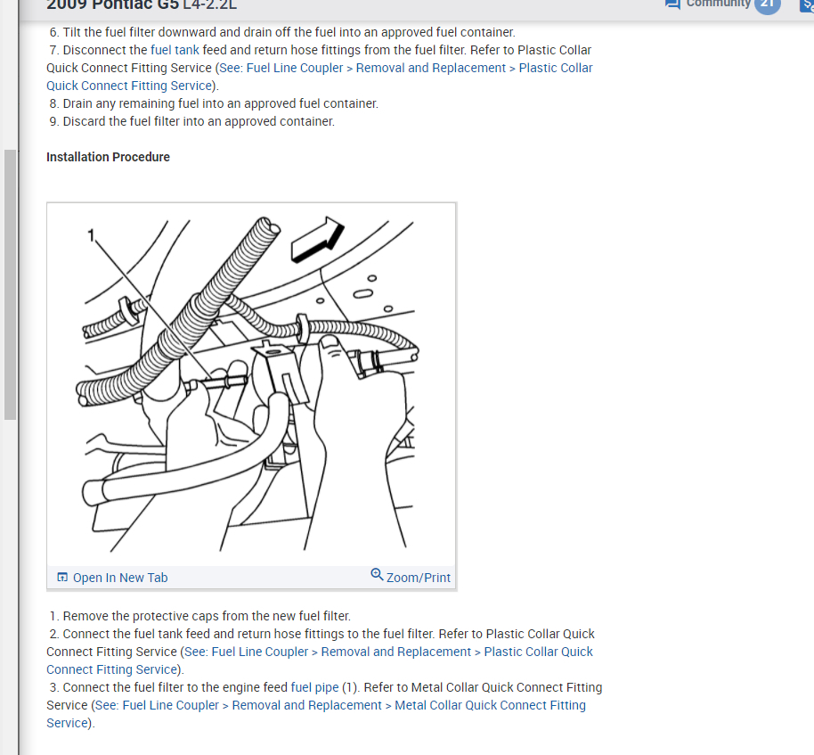

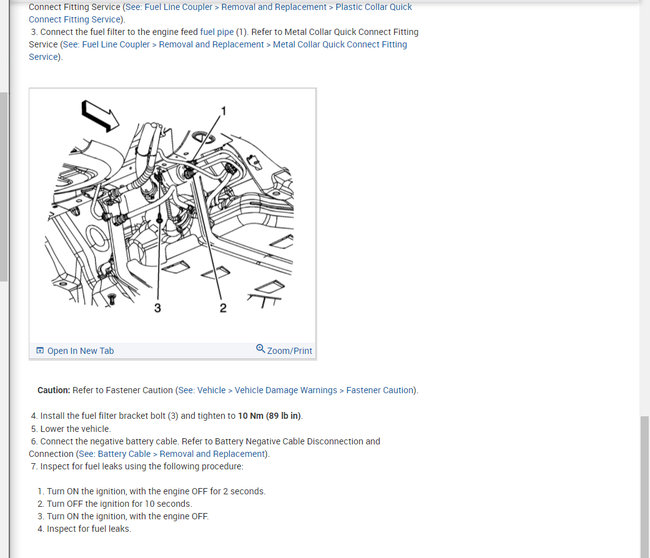

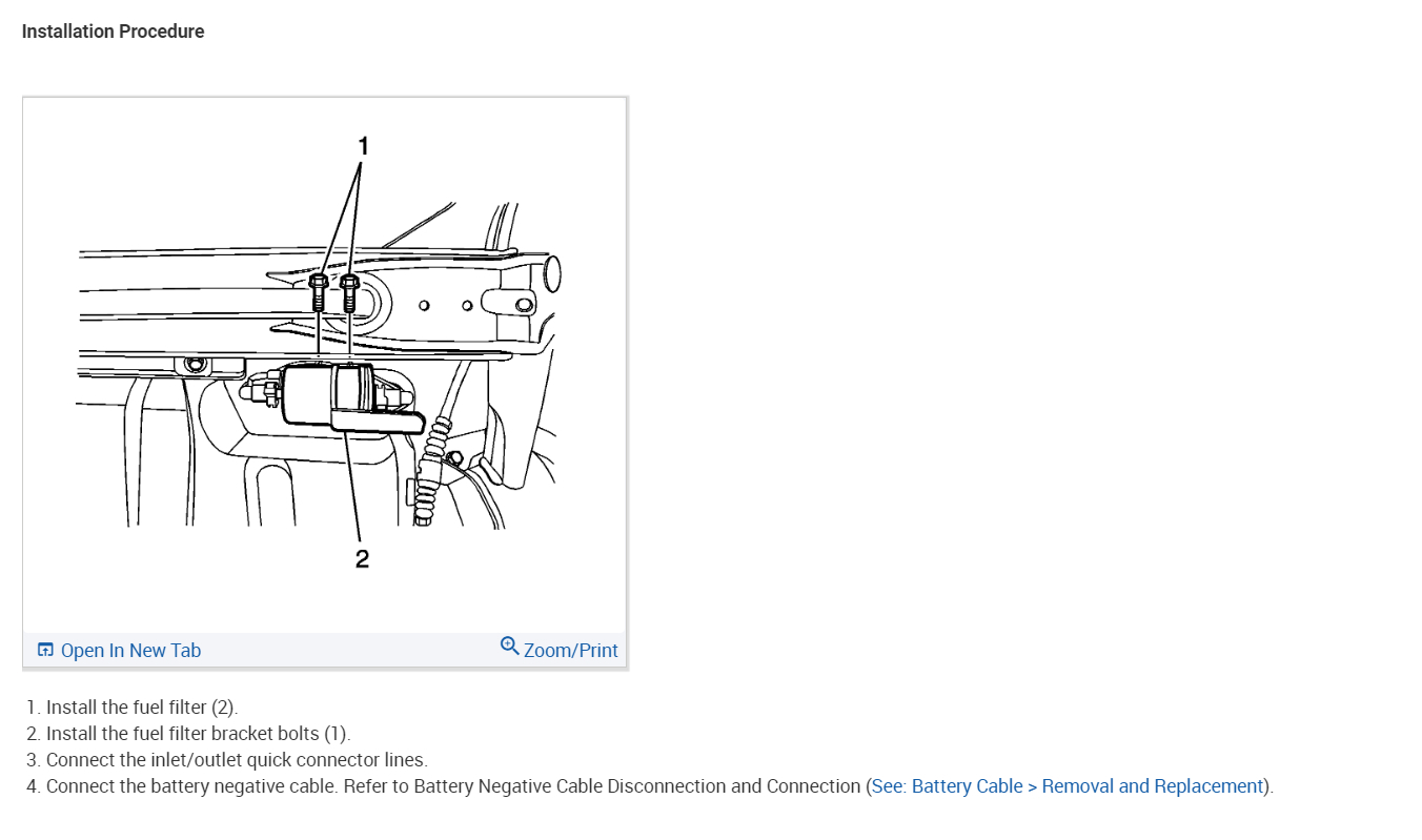

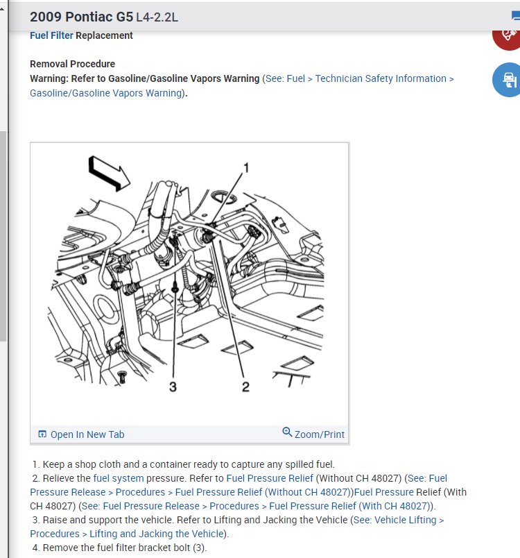

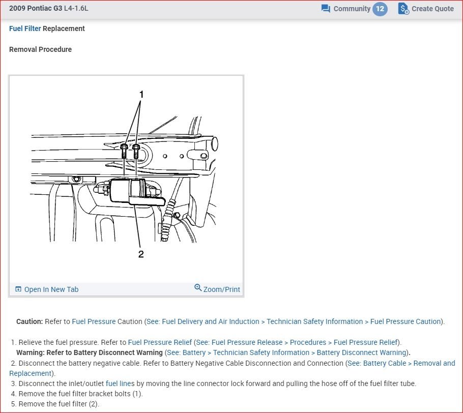

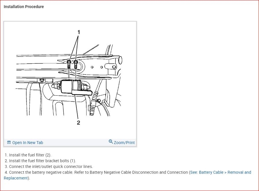

You noted that this was a G5 with a 1.6L. This combination is not accurate. Is this a G3 with a 1.6L or a G5 with a 2.2L?
Either way, here is the procedure for the fuel filter replacement for both.

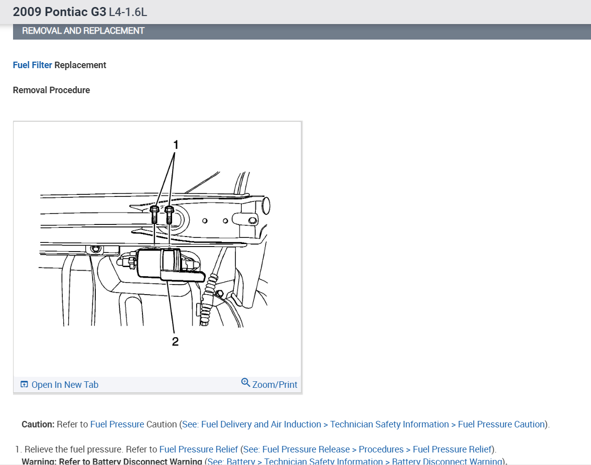

For the 1.6L it looks like the filter is just below the frame rail on the side that the fuel lines leave the gas tank and travel to the engine.

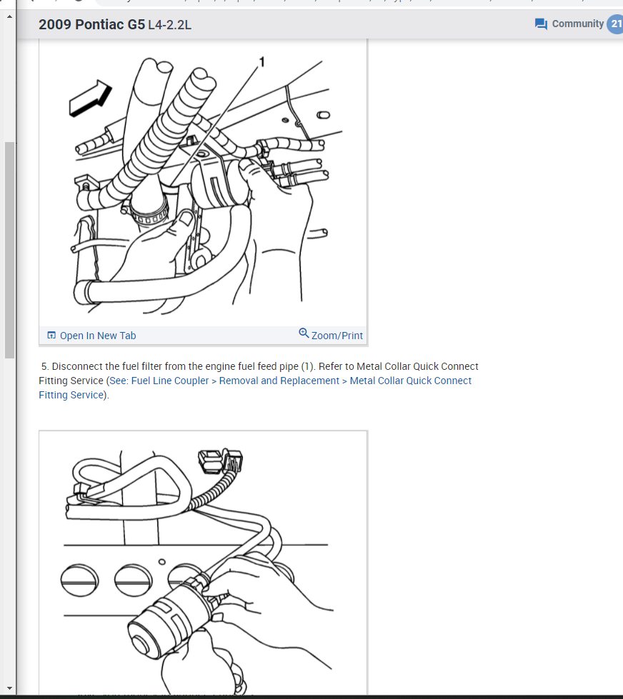

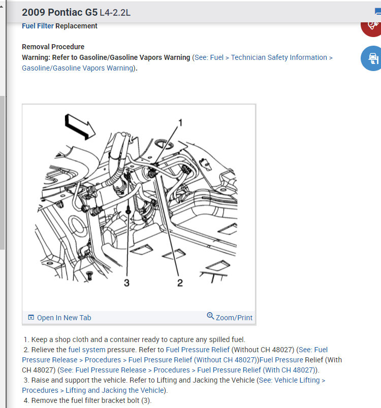

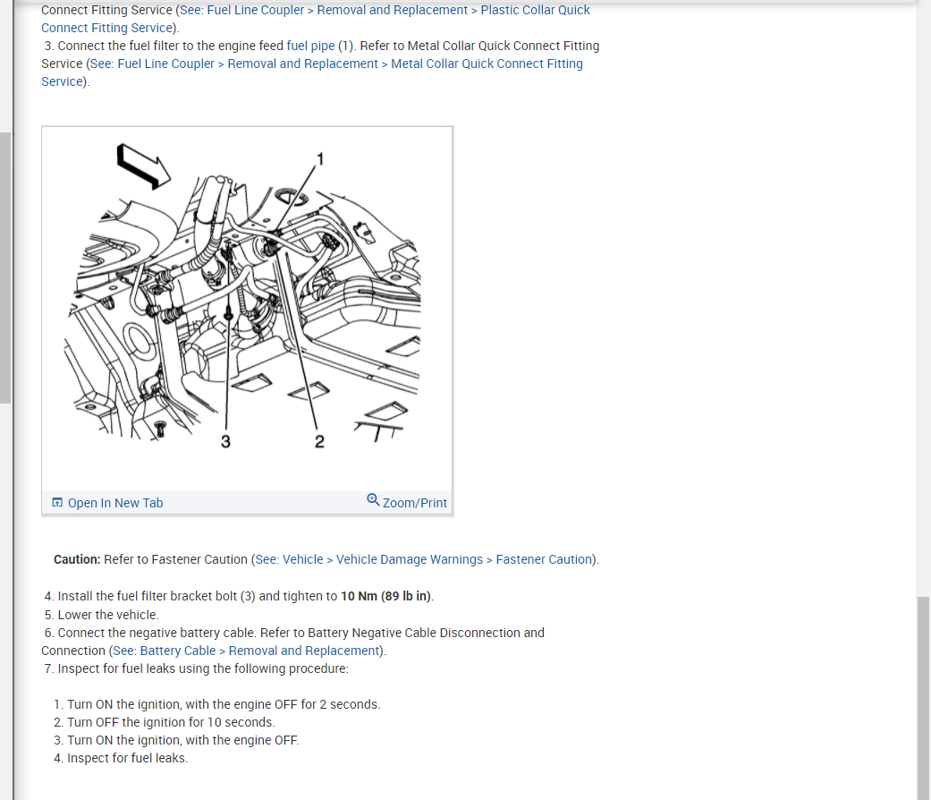

The 2.2L the filter is held in place by a single bolt.
Both processes are below.
Let me know if you still need assistance.
