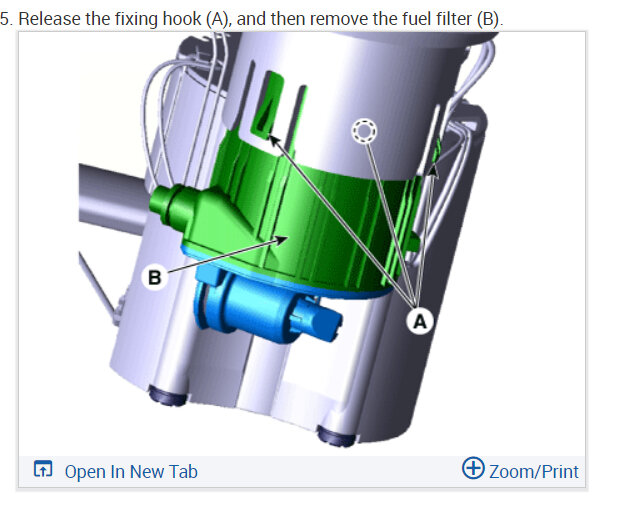

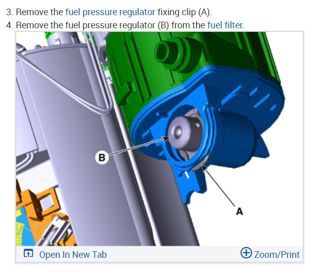

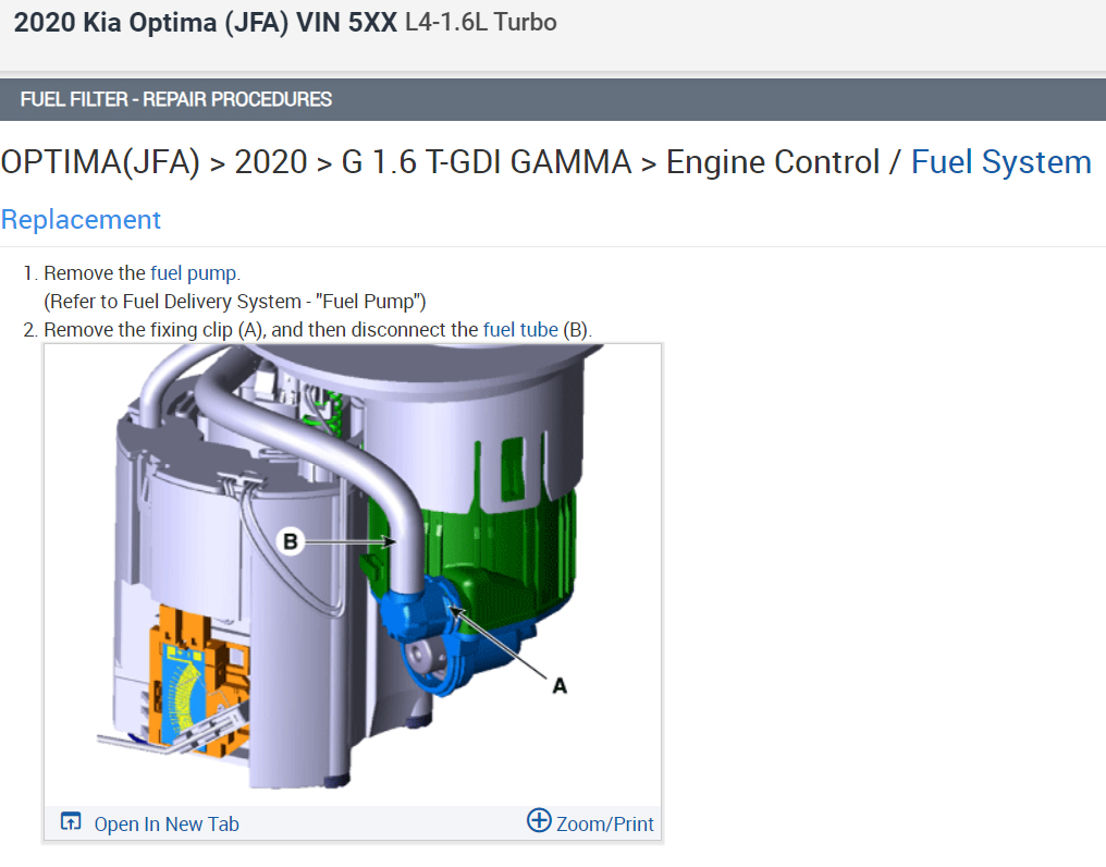

The fuel filter is attached to the fuel pump inside the fuel tank, they relay don't use a fuel filter anymore it is more like fuel strainer and is meant to last a lifetime of the car. Check out the images (below). Let us know if you need anything else.
