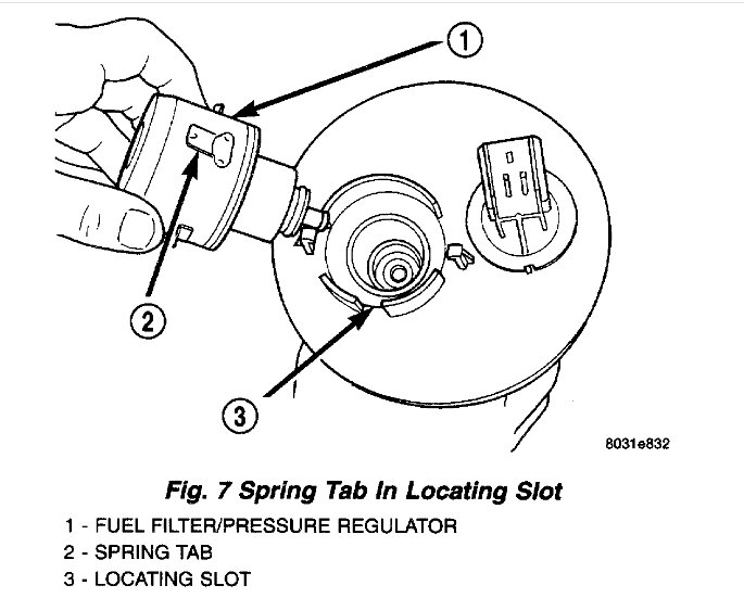

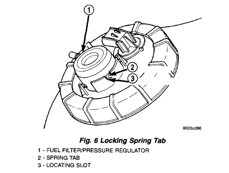

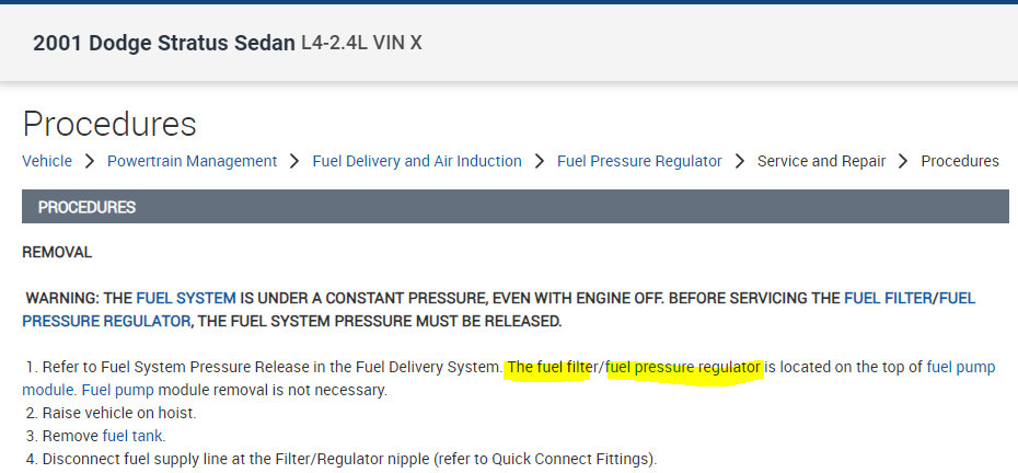

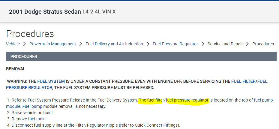

The fuel filter is located on the top of the fuel tank and attached to the fuel pump module. The filter and fuel pressure regulator are a single unit. The filter is integral to the regulator.

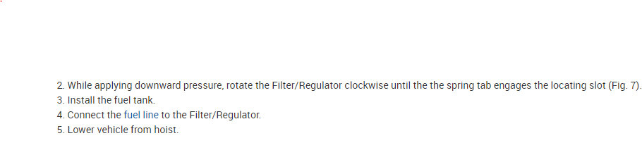

If you look below, I attached the directions for replacing it. However, to access it, the fuel tank needs to be removed. If you do remove the tank, I would also recommend replacing the pump itself.
See pics below.
