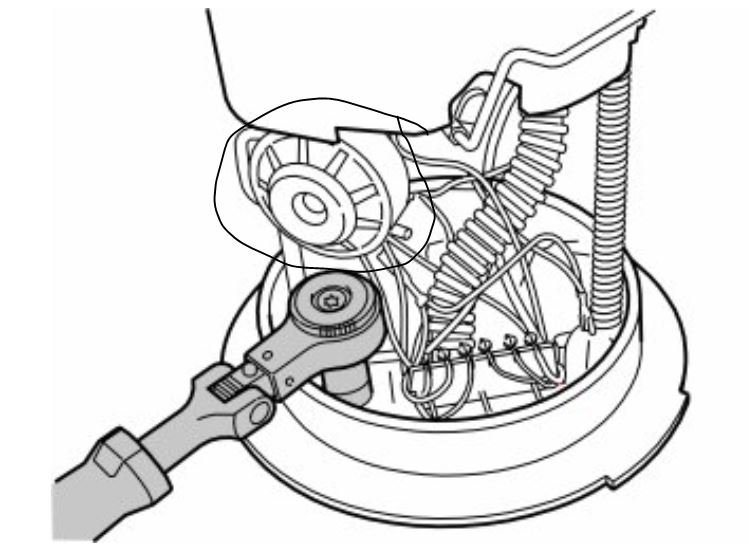

The filter is part of the fuel pump assembly.
Models with ON-DEMAND FUEL systems. The fuel filter is integrated with the Fuel Pump Unit. However, some models continue to incorporate an external fuel filter. If the external fuel filter is not found it should be assumed that the fuel filter can only be replaced by renewing the fuel pump.
