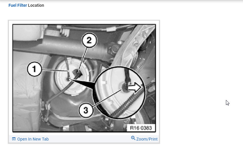

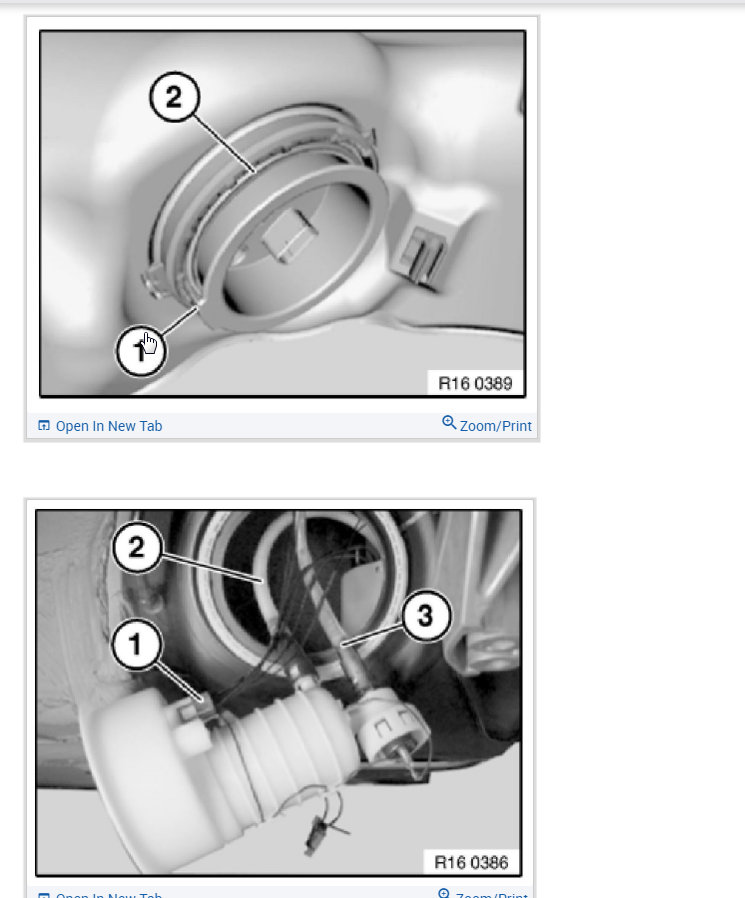

The fuel filter for this vehicle is in the fuel tank and part of the fuel pump assembly. See the attachments. The only time it requires changing is when the fuel pump is removed or there is another issue that has you take it out.
Let me know if you have other questions about this. Thanks

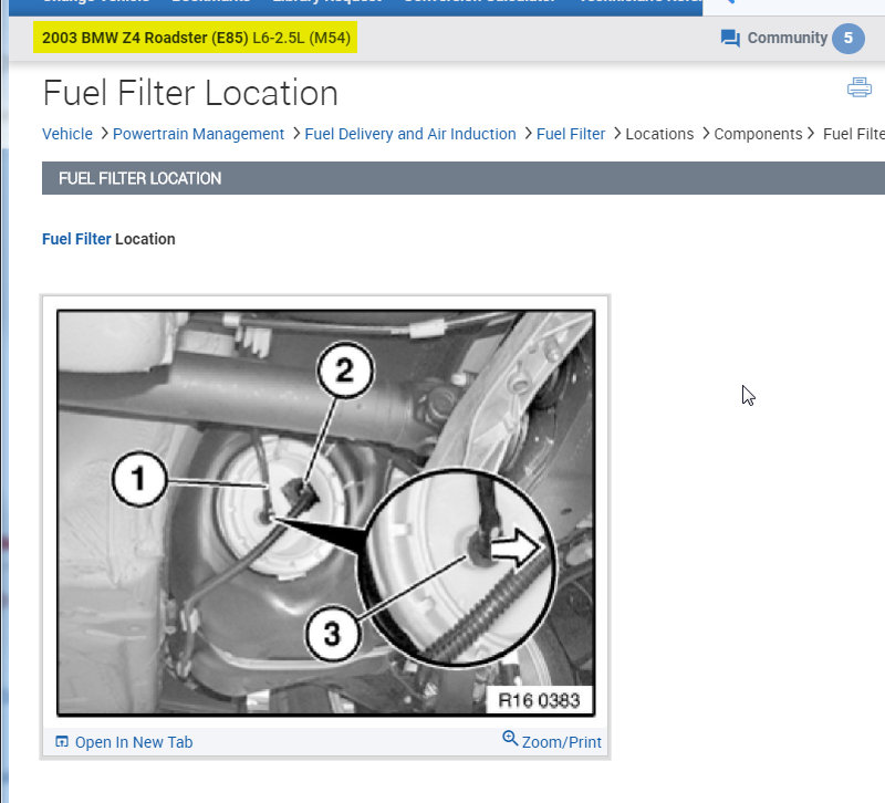

I have checked Alldata and Mitchell and they do not show an inline filter.
I highlighted the vehicle selected vehicle just below. Let me know if this is not your vehicle. However, I would suggest just following the fuel lines from the tank to the engine and you will run into a filter if it is there.
