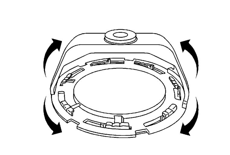

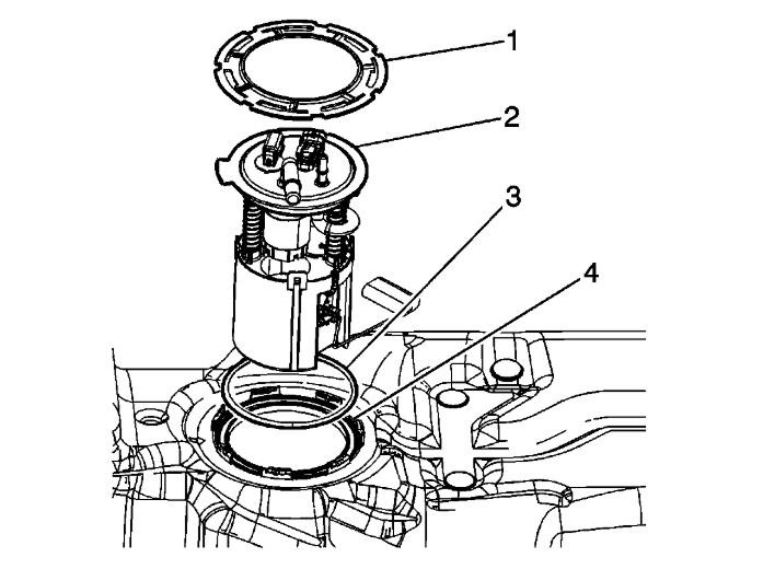

Good morning,
The fuel filter is part of the fuel pump. There is no external filter in this truck.
FUEL FILTER
The fuel filter is contained in the fuel sender assembly inside the fuel tank. The paper filter element traps particles in the fuel that may damage the fuel injection system. The filter housing is made to withstand maximum fuel system pressure, exposure to fuel additives, and changes in temperature.
Yes, it sounds like you need the pump replaced.

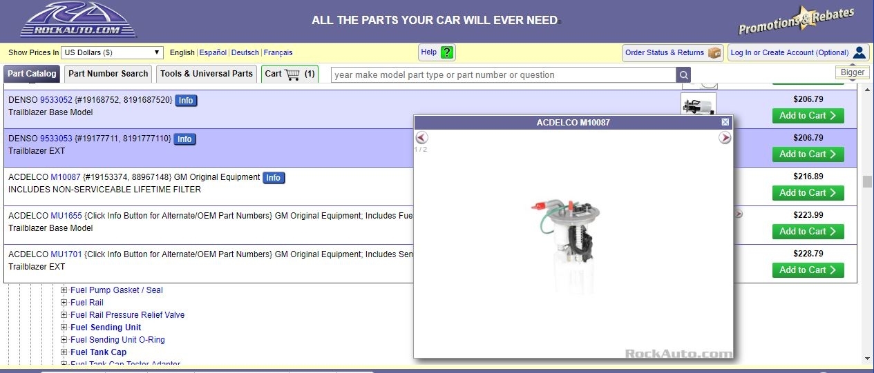

Thank you very much. Do you have any recommendations where to go for the part? I'll be ordering online and like to stick with original parts. Maybe she will listen to an expert because she won't listen to me. She likes running her vehicle all but bone dry all the time. How hard is it on the pump to run it so low on gas so much?
Apr 28, 2019 at 9:59 AM
Running low on fuel is hard as it overheats the pump and causes it to fail.
I attached a pump from rock auto. It is the AC Delco original pump. I doubt you will find a better price.
