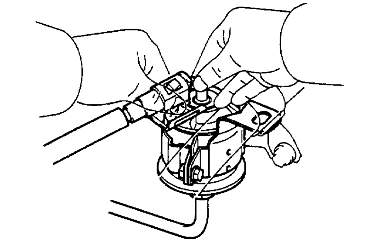

Where is the fuel filter??
Oct 25, 2020 at 12:39 AM
Good morning,
The filter is at the left front of the engine compartment down low. It is difficult to see but you can access it from the bottom or top.
The fuel filter is located on the driver side of the engine compartment, low on the firewall. Also see Fuel Tank and Fuel Pump.
Fuel Filter To Fuel Pump Bracket 17 in.lb
Fuel Inlet Hose To Fuel Filter 21 ft.lb
