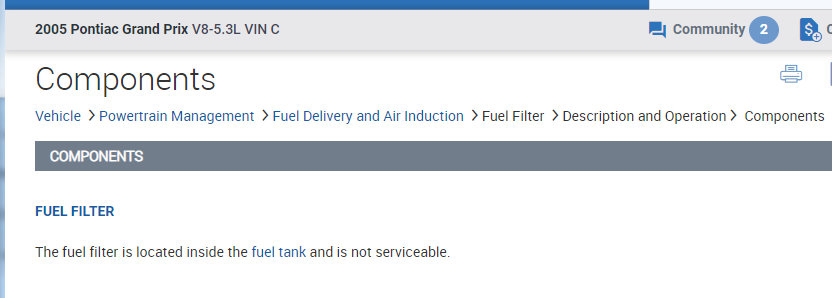

You did not note which engine you have but , if you cannot find it I assume you have the V8 engine. If this is the case then you do not have an external fuel filter. It is inside the tank and part of the fuel pump.

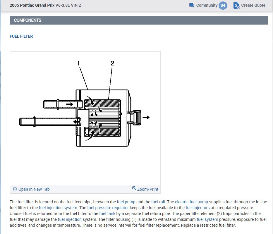

However, if you have the 3.8L then I provided the location information below.
Please review this and let us know if you have other questions.
