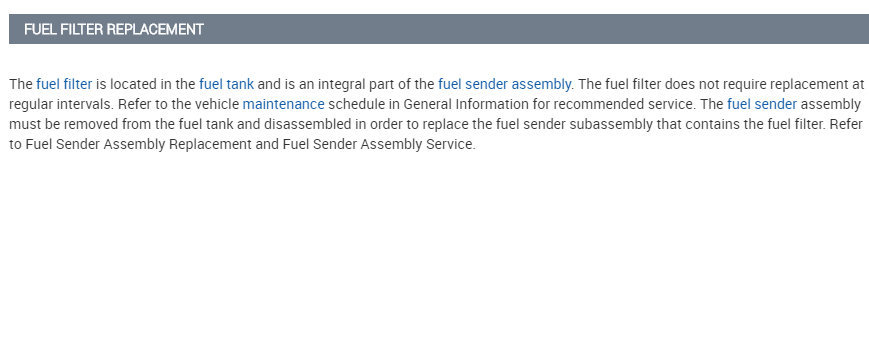

Where exactly is the fuel filter located?
Nov 28, 2019 at 5:31 AM
Good morning,
There is no external fuel filter for servicing. The filter is part of the fuel pump assembly in the fuel tank.
What is the issue that you are having?
Nov 28, 2019 at 5:49 AM
VICKIENEWMAN
I'm not having an issue, I simply wanted to know where it was.
Nov 28, 2019 at 7:53 AM
Okay, just wanted to be sure you did not have any type of issue.
