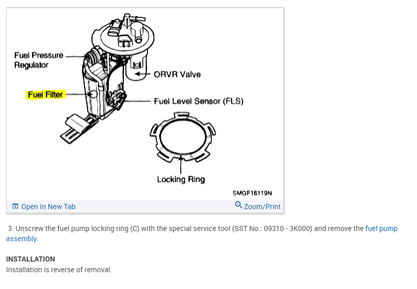

I am replacing the fuel filter on the car listed above LX model. I need to know where the fuel filter is located.

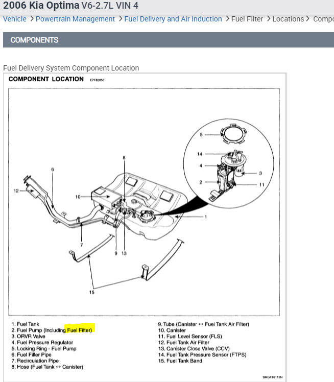

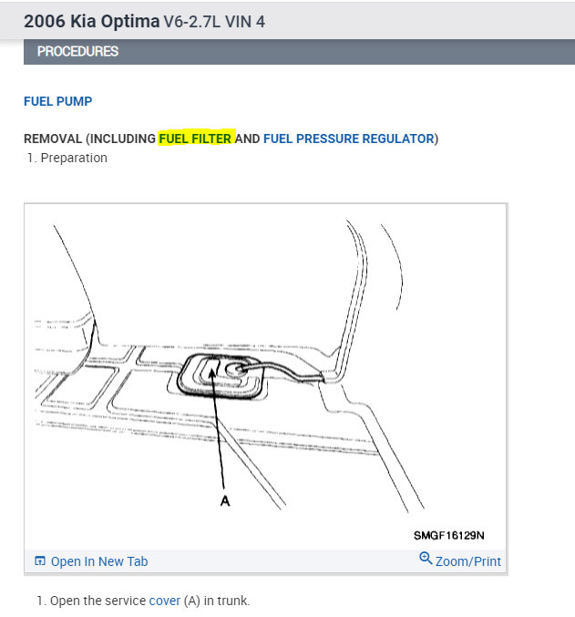

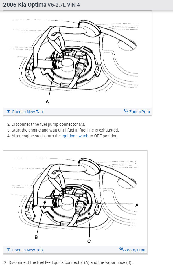

This vehicle does not have an inline fuel filter.
The filter is mounted on the fuel pump, located in the fuel tank.
It can be accessed through the service port that is located in the trunk. You will see the access port after removing the carpet.
I have attached diagrams below for your reference.
Thank you.
