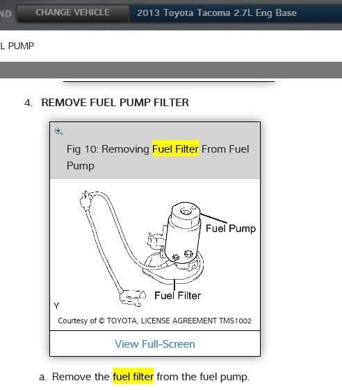

Where is located on the vehicle?
Feb 11, 2019 at 8:08 AM
PATENTED_REPAIR_PRO
  • 1,853 POSTS

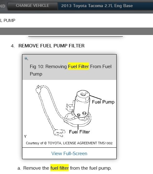

Shown on the diagram below the fuel pump is located in the gas tank.
Feb 11, 2019 at 9:29 AM
MIKE RAMEY
Thank you for the information. so there is no inline fuel filter?
Feb 12, 2019 at 5:37 AM
PATENTED_REPAIR_PRO
  • 1,853 POSTS
You are welcome and no there is not an inline fuel filter. The older trucks had one under the manifold pipes but these trucks only have one as part of the pump assembly.

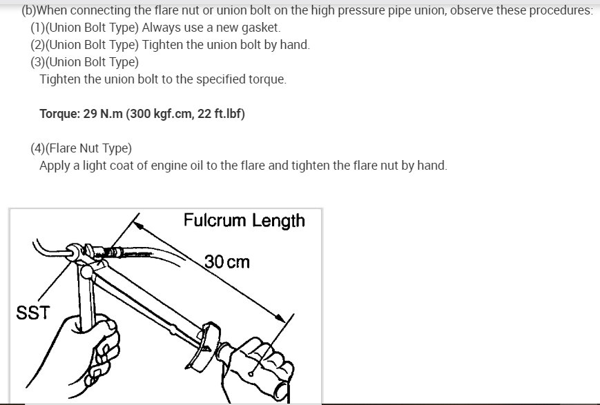

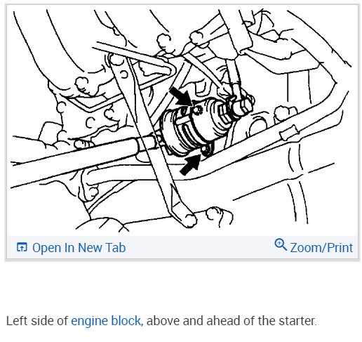

The fuel filter is located on the frame rail on the drivers side right about where the passages seat is. Here is a video of the job being done.
https://youtu.be/OPbnlCpRans
Please let us know if you need anything else to get the problem fixed. NOTE Fuel filter on a 4 cylinder 2.4l 2wd Tacoma is located on the driver's side portion of the engine block under the intake manifold difficult to reach.

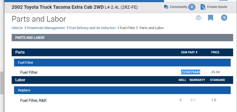

Its in the fuel tank below the fuel pump. However, if you have the 2RZ-FE engine then you have a filter under the intake manifold as well.
The other engines only have one in the tank. I included info on this filter as well below. Please let us know if you have other questions. Thanks

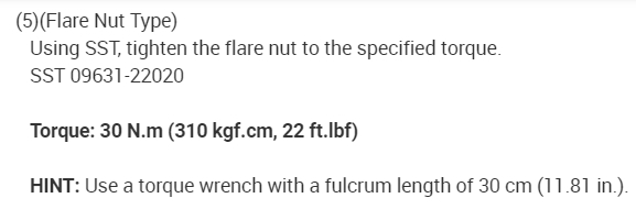

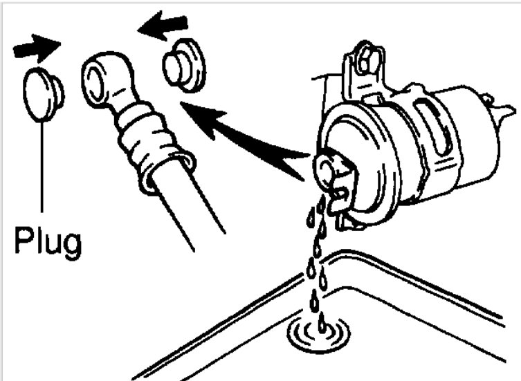

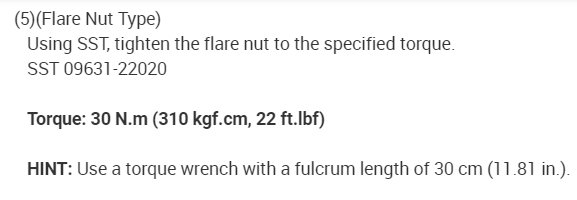

Here is a basic fuel filter tutorial for you to view for filter replacement:
https://www.2carpros.com/articles/how-to-change-a-fuel-filter
I've attached the location and picture steps on how to replace the filter for your truck below.Hope this helps and thanks for using 2CarPros.

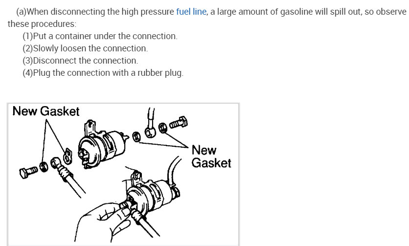

I just changed my fuel filter on a 95 Toyota pickup if you look on the passenger side in front just right above the oil filter its in a tight place so you have to look really in there if its not there look back by the gas tank on the frame but if its like my truck its right above the oil filter
Mar 6, 2021 at 10:32 AM (Merged)

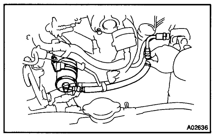

DANNY77762
the fuel filter is located up under the intake manifold, if you have big hands i wouldnt attempt to change it. you need 2 hands to work with it. good luck
