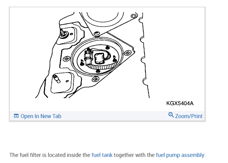

I need to know where the fuel pump is located on order to replace the fuel filter.
Aug 11, 2019 at 5:30 PM
SCGRANTURISMO
  • 4,897 POSTS

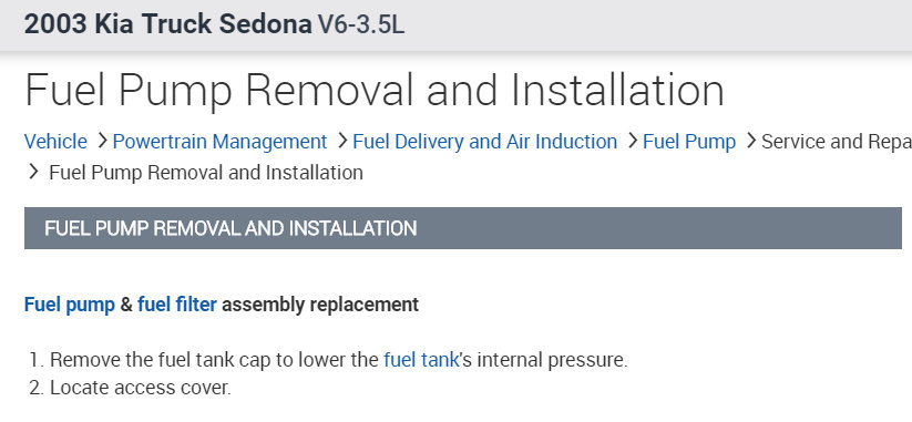

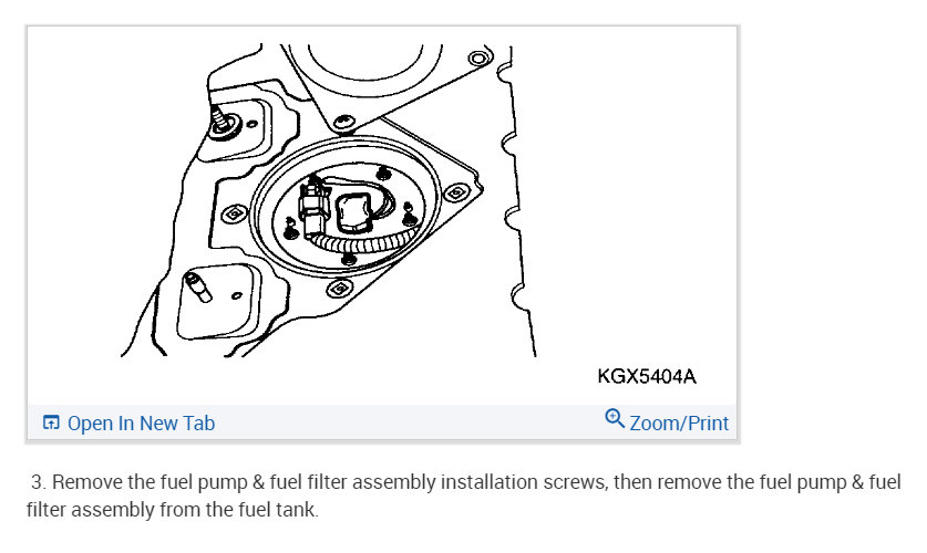

I have included the information that you requested in the diagrams down below. Please go through this guide and get back to us with how everything turns out.
