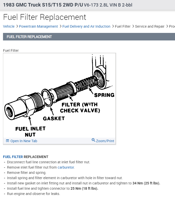

Where is filter in the truck listed above?

The factory fuel filter is located where the fuel line to attached to the carburetor.
See attached diagram for reference.
Let me know of any questions.
