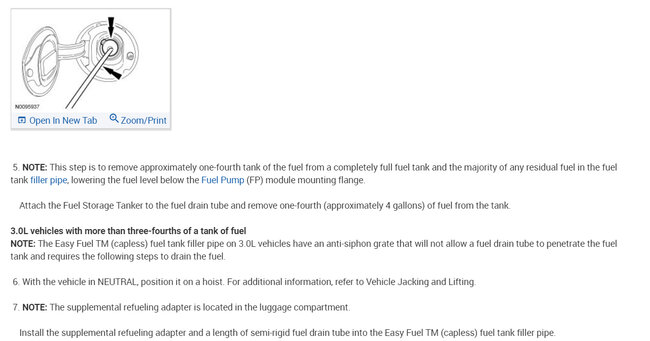

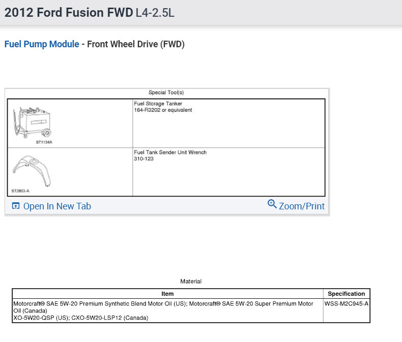

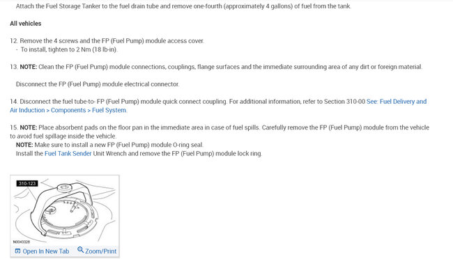

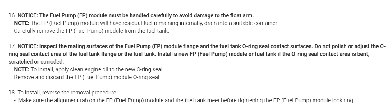

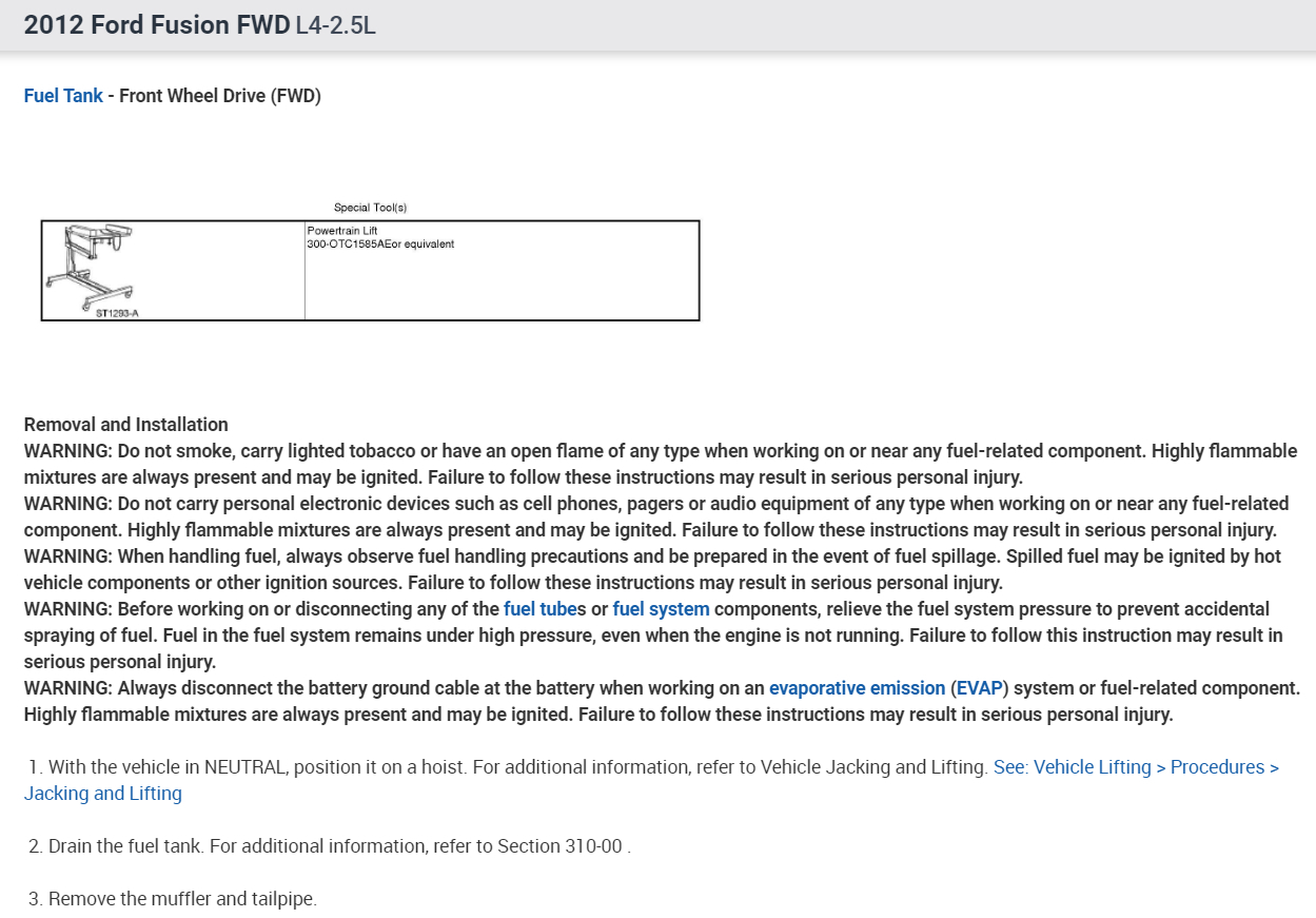

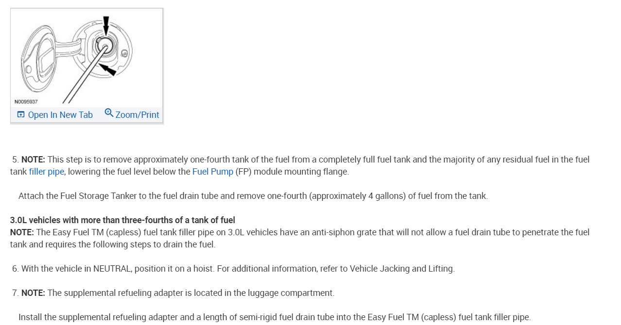

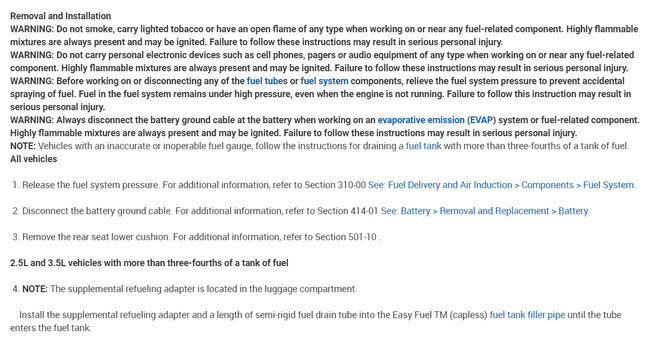

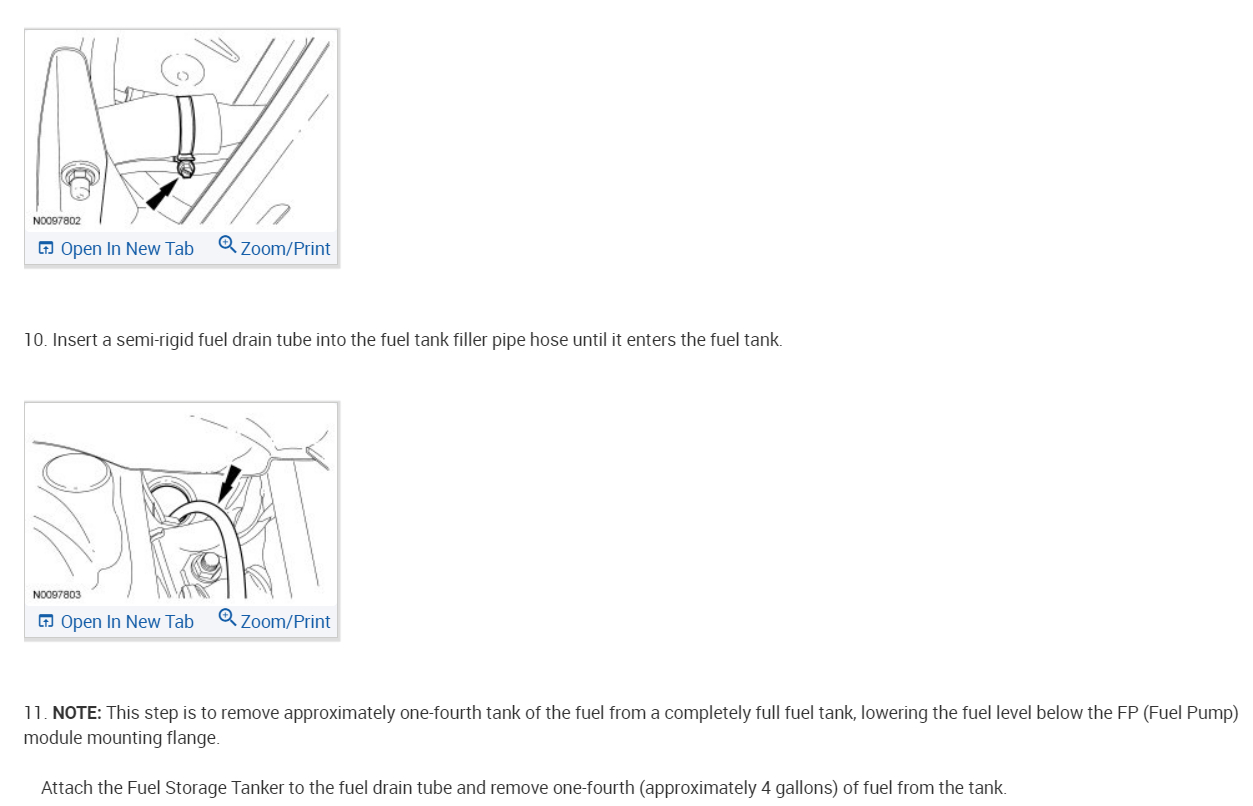

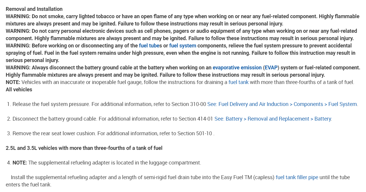

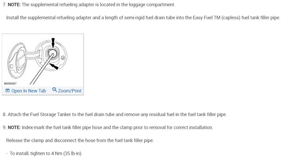

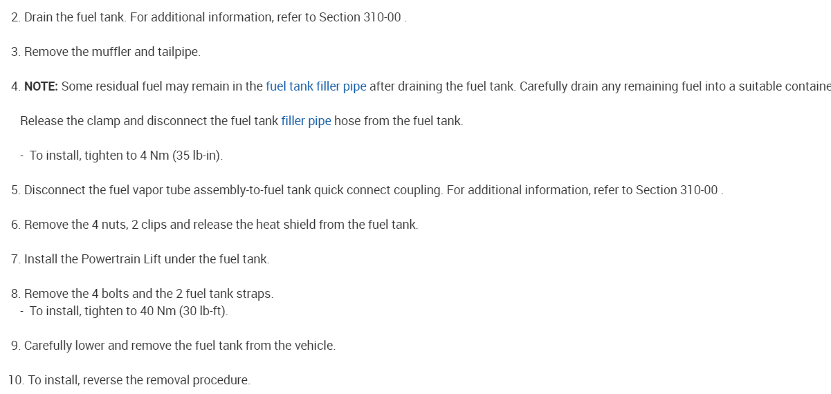

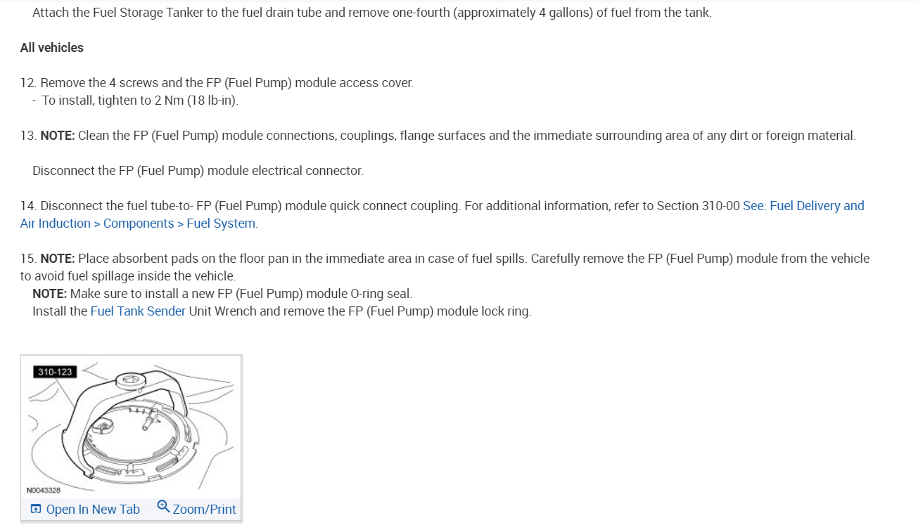

The fuel filter is in the tank attached to the fuel pump; here are the instructions on how to change the pump and filter out, which means the fuel tank will need to be removed. Please check out this video:
https://youtu.be/Q5MH2gnyFH0
Check out the images (below). Please let us know if you need anything else to get the problem fixed.
