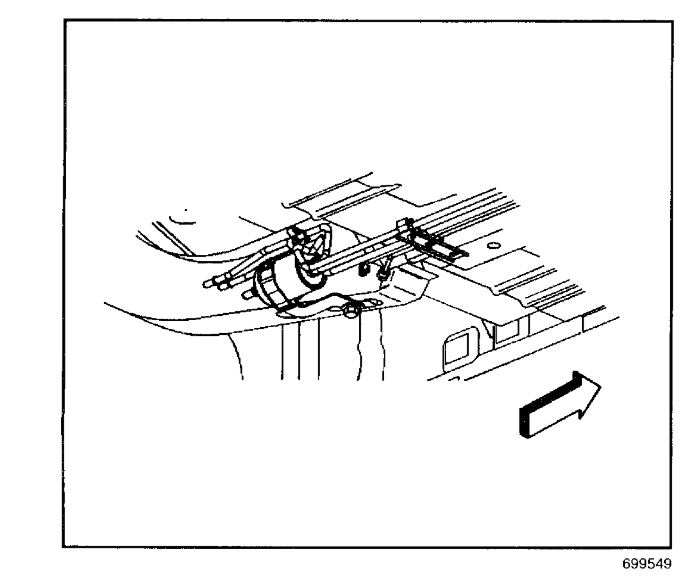

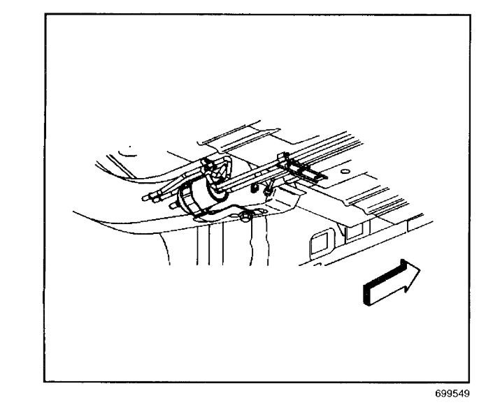

Where is the fuel filter located in my car? I have looked in all of these suggested areas and do not see it. Is it inside the fuel tank? If yes, how do I access it to change the filter myself?
Jul 17, 2019 at 2:11 PM
Good evening,
The filter is located just in front of the fuel tank under the car. This guide will help walk you through the repair with diagrams below to show you how on your car
https://www.2carpros.com/articles/how-to-change-a-fuel-filter

The fuel filter is located on the fuel feed pipe, between the fuel pump and the fuel rail under the car toward the fuel tank. You will need to raise the car in the air to get to it.
Here is a guide that should help.
