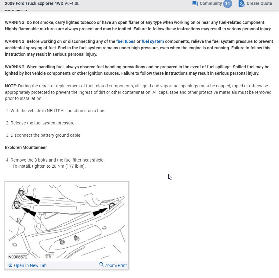

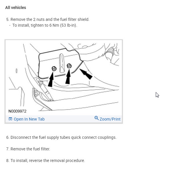

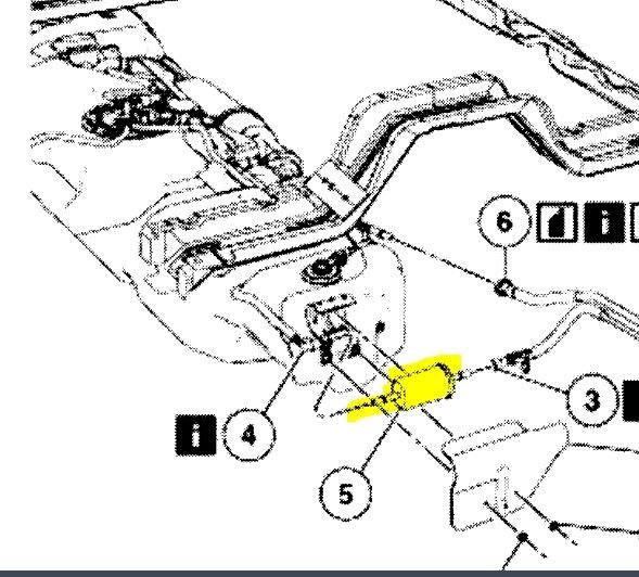

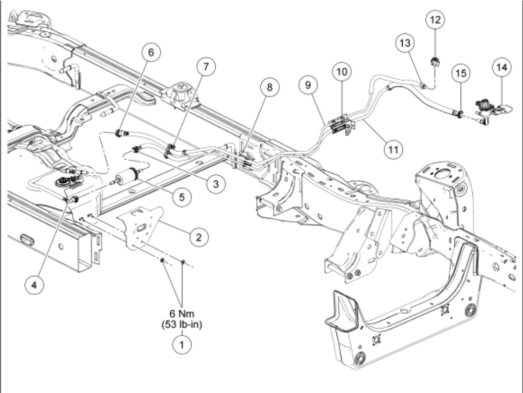

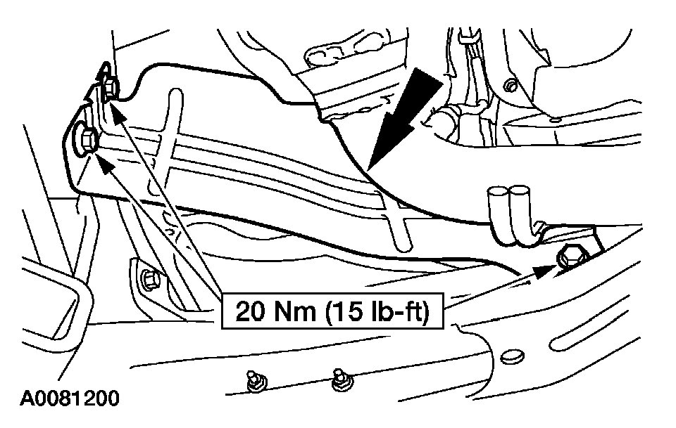

It is in front of the fuel tank behind a protection shield. See picture 1.
Here are the directions for fuel line/fuel filter replacement. The additional attached pictures correlate with the directions.

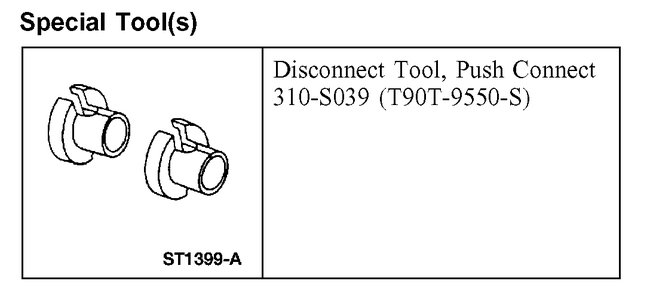

Disconnect Tool, Push Connect
pic 1
SPECIAL TOOL(S)

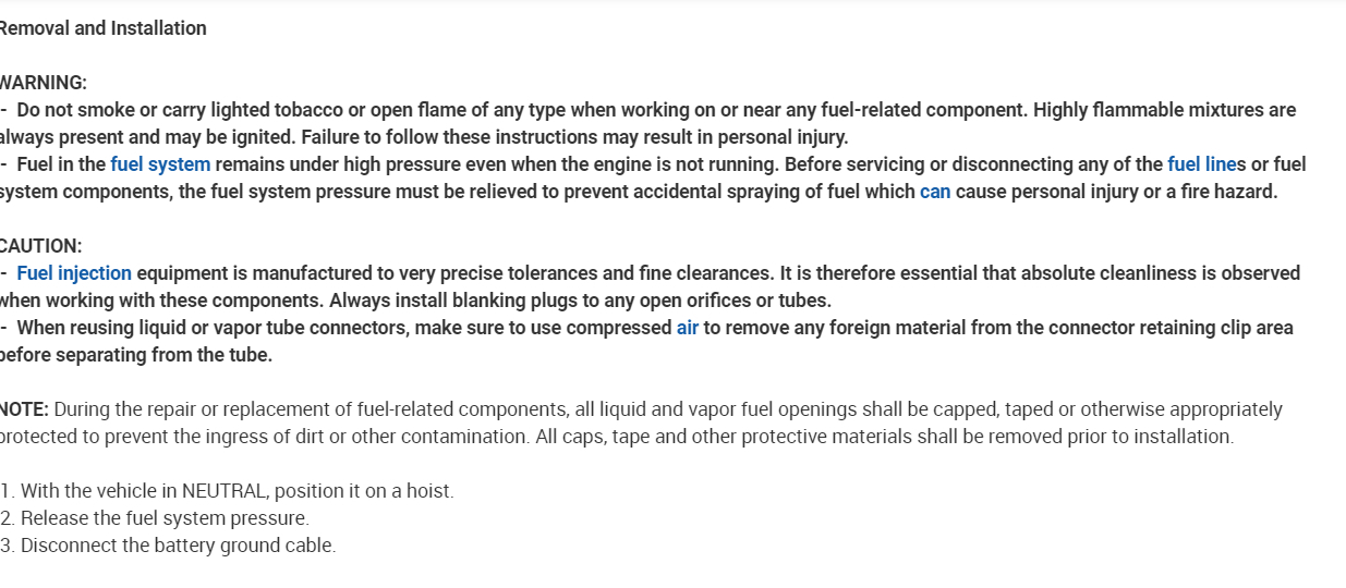

REMOVAL
1. With the vehicle in NEUTRAL, position it on a hoist.
2. Release the fuel system pressure.
3. WARNING:
- Do not smoke or carry lighted tobacco or open flame of any type when working on or near any fuel-related component. Highly flammable mixtures are always present and can be ignited, resulting in possible personal injury.
- Fuel in the fuel system remains under high pressure even when the engine is not running. Before servicing or disconnecting any of the fuel lines or fuel system components, the fuel system pressure must be relieved to prevent accidental spraying of fuel, which can cause personal injury or a fire hazard.
Disconnect the battery ground cable.

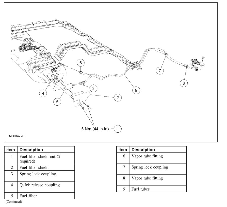

pic 2 and 3

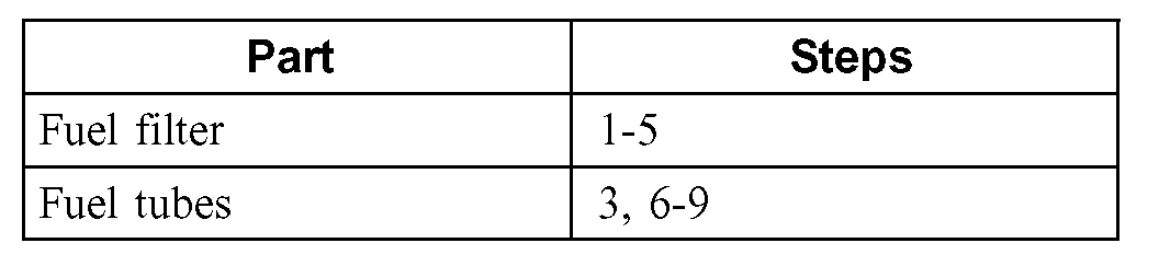

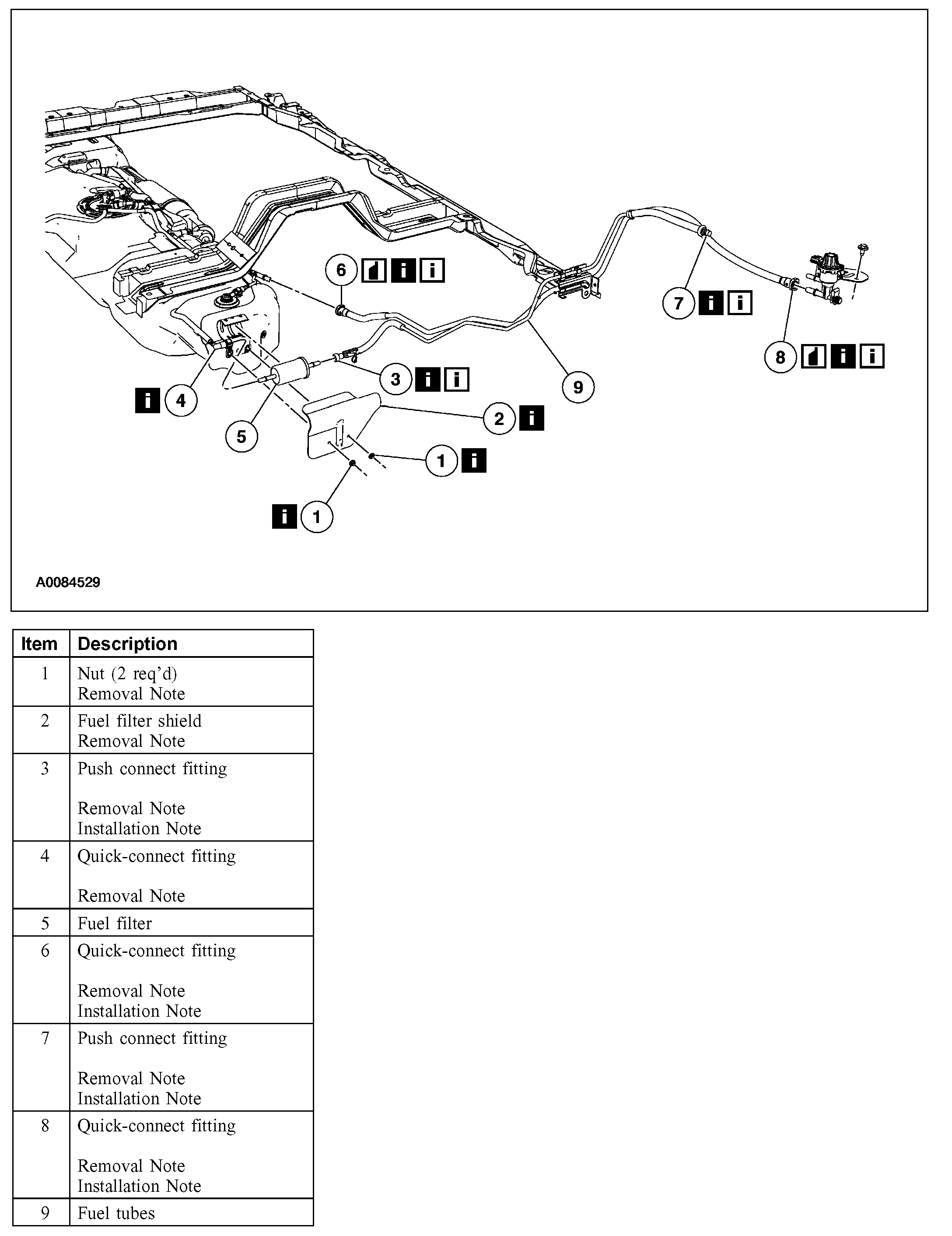

5. Remove the parts in the order indicated in the illustration and table. To remove individual parts, only carry out the listed steps.

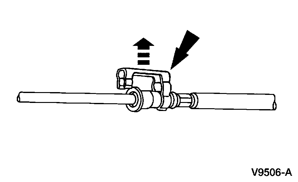

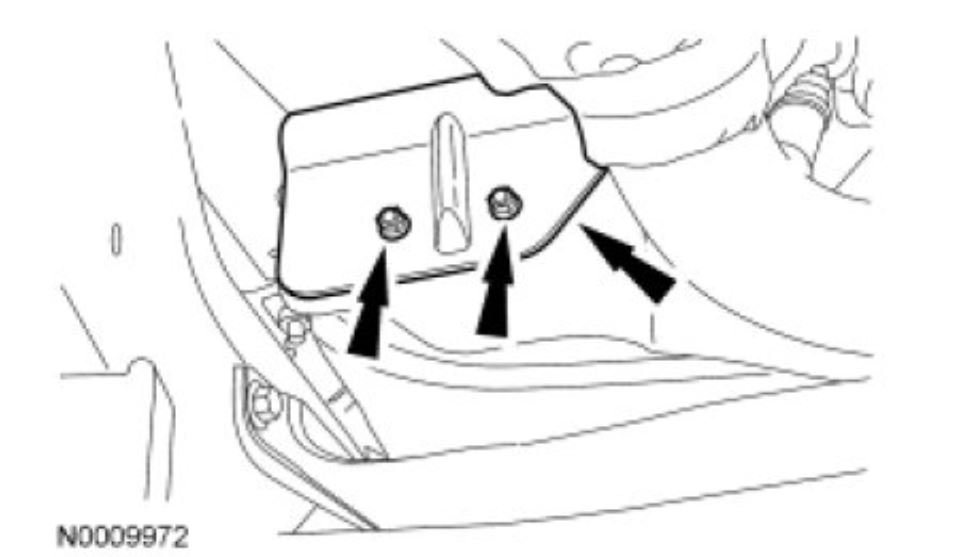

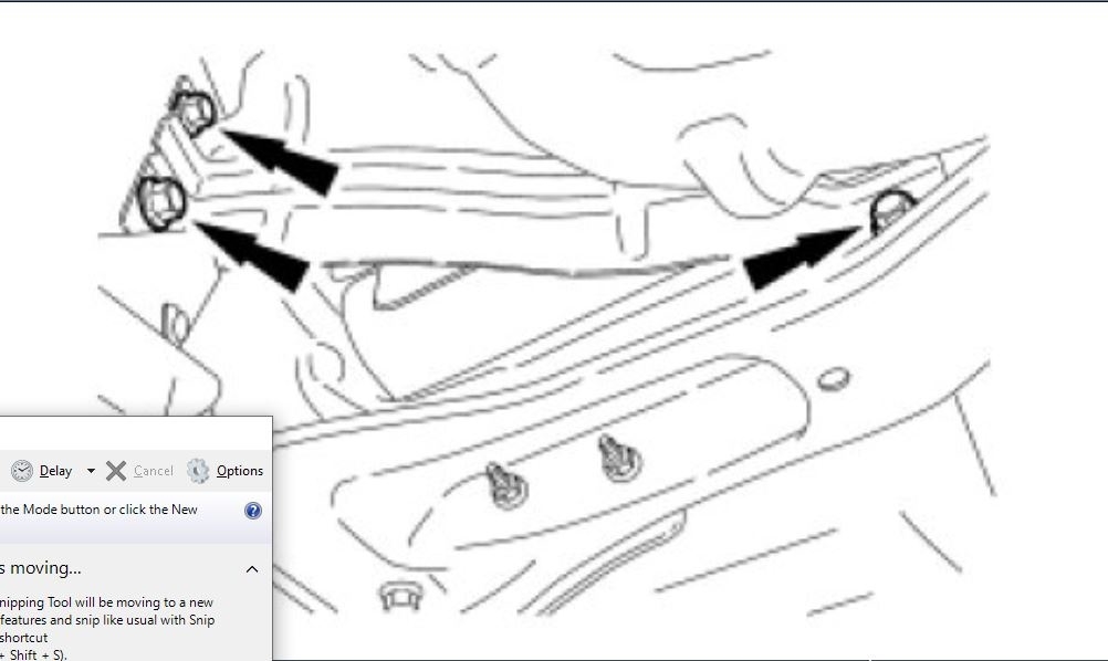

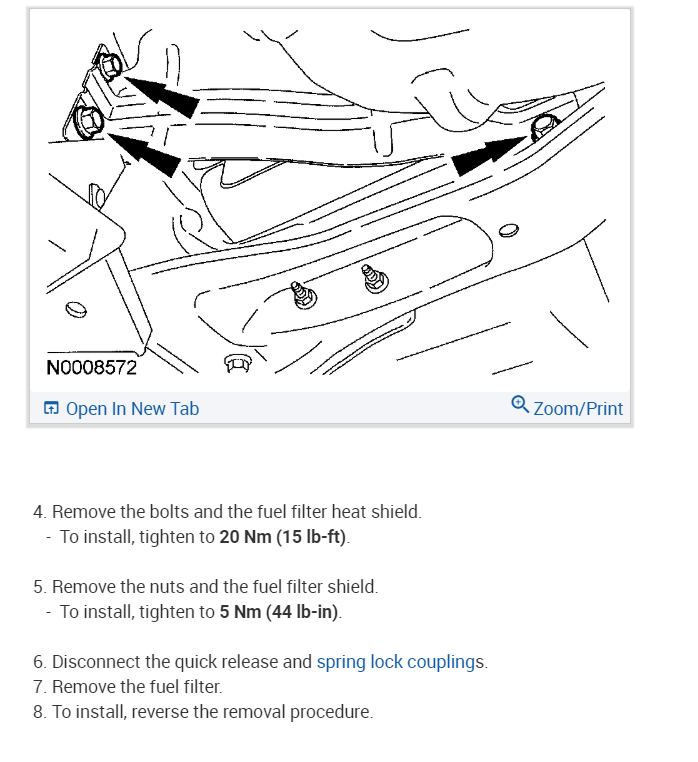

Items 1 and 2: Fuel Filter Shield and Nuts Removal Note
pic 4
1. Remove the nuts and the heat shield.

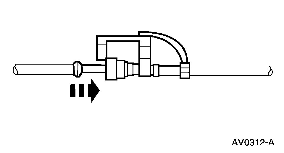

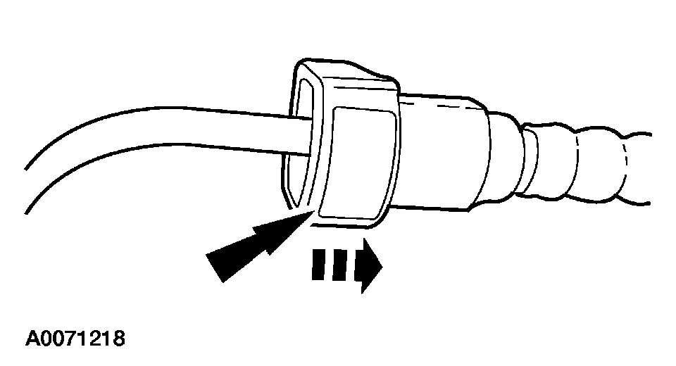

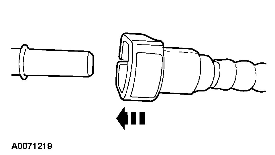

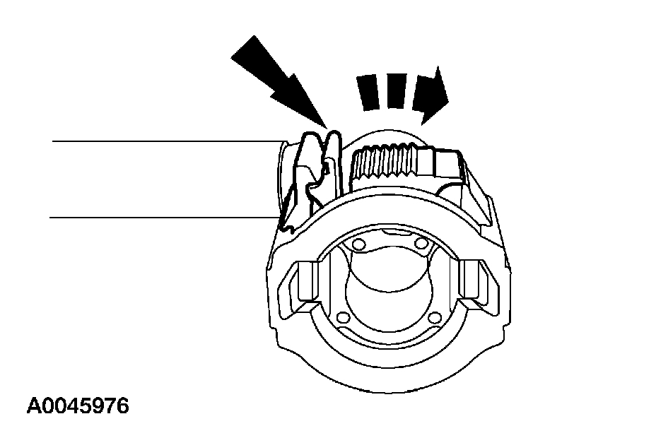

Items 3 and 7: Push Connect Fitting Removal Note
pic 5
1. WARNING:
- Do not smoke or carry lighted tobacco or open flame of any type when working on or near any fuel-related components. Highly flammable mixtures are always present and may be ignited, resulting in possible personal injury.

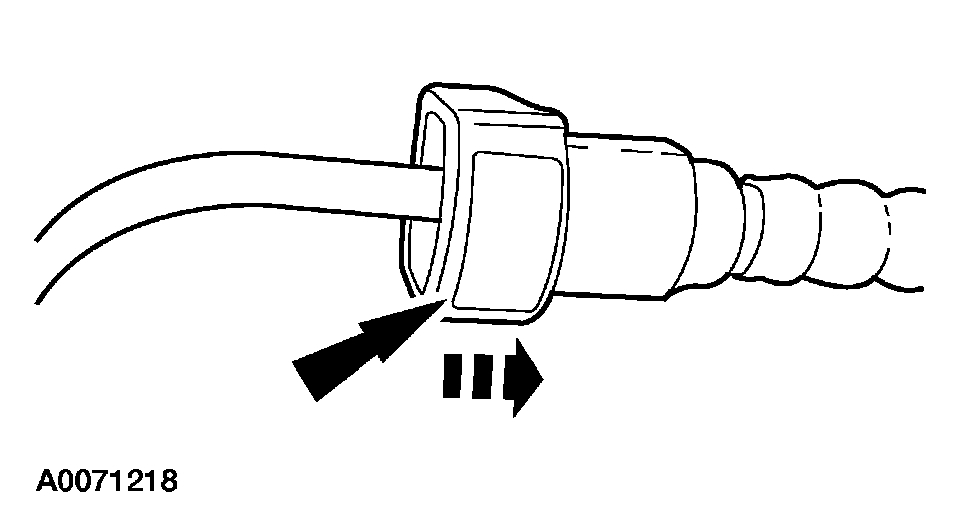

If equipped, disconnect the safety clip from the fuel tube.

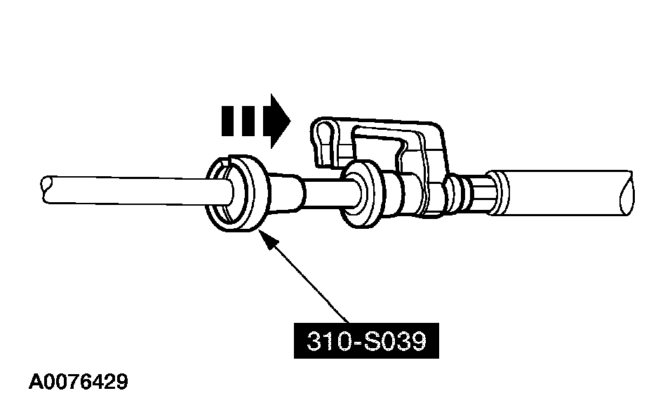

pic 6

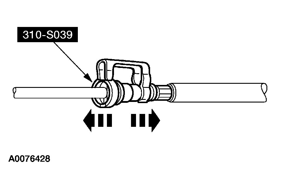

2. Install the special tool and press it into the fitting.
pic 7
3. Separate the fittings.

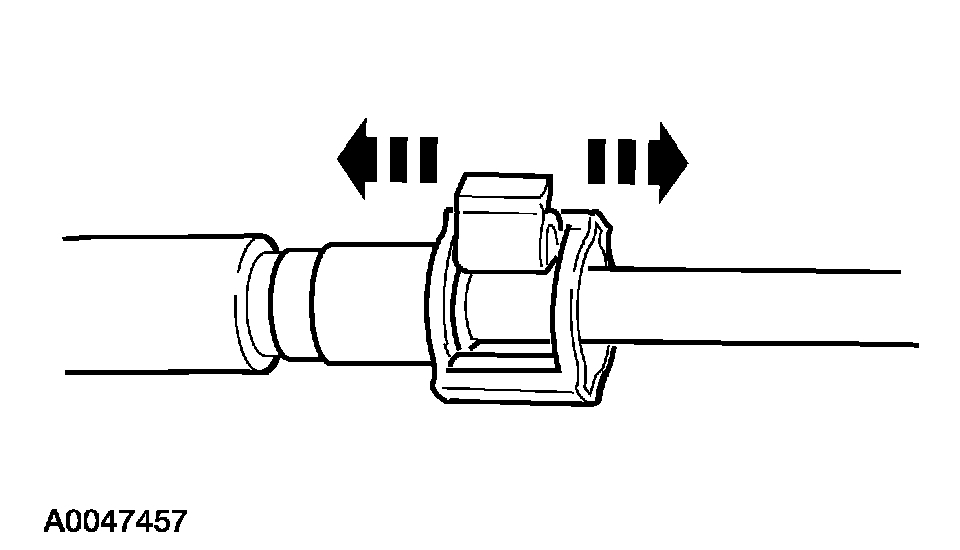

Item 4: Quick-Connect Fitting Removal Note
pic 8
1. WARNING:
- Do not smoke or carry lighted tobacco or open flame of any type when working on or near any fuel-related component. Highly flammable mixtures are always present an may be ignited, resulting in possible personal injury.

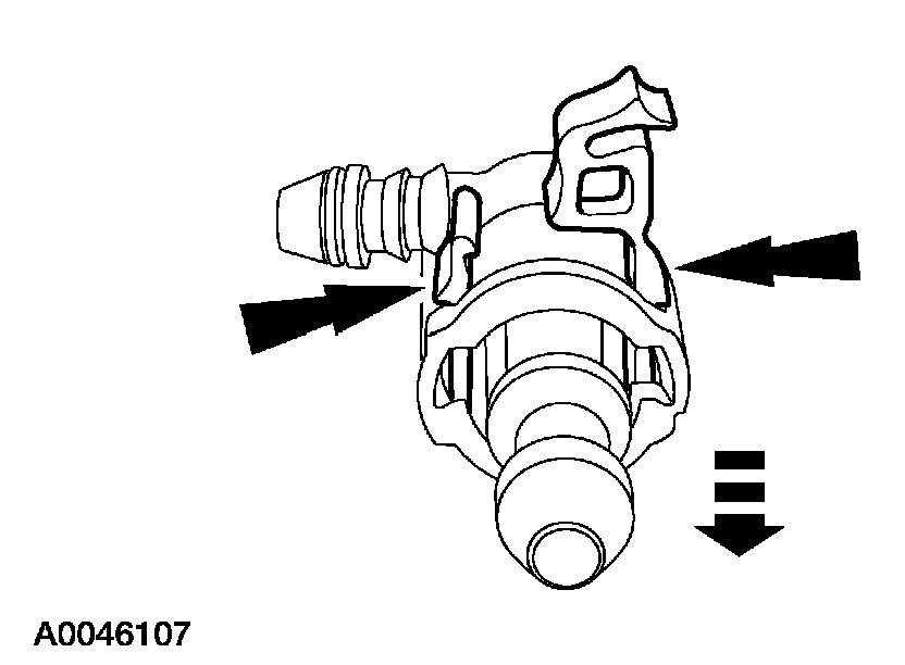

Unclip the tab.
pic 9
2. Depress the tabs and press the clip downward.
pic 10
