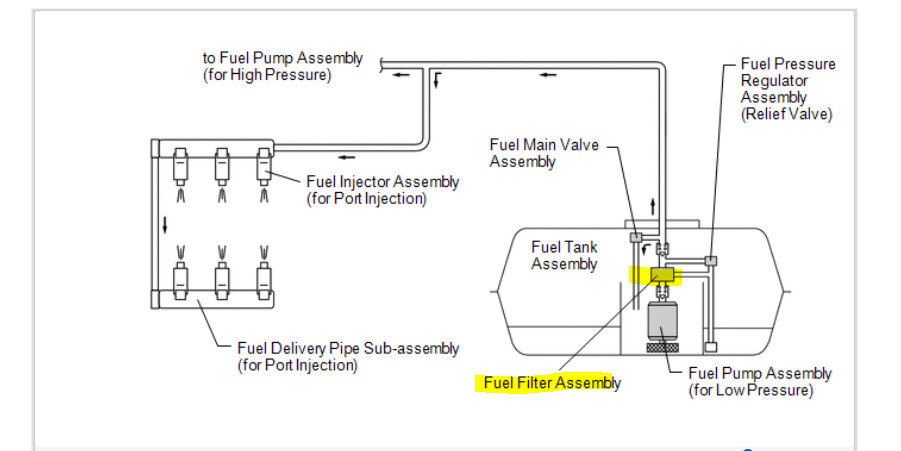

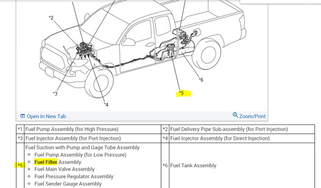

The truck is bogging down when I give it gas and won’t let me go over 20-30 MPH. When I give it gas it’s like it’s not getting enough and it’s shutting off.
Jun 18, 2023 at 12:20 PM
The fuel filter is in the fuel tank and part of the fuel pump assembly. I attached two pics below showing the location.
Let me know if this is what you needed.
See pics below.
