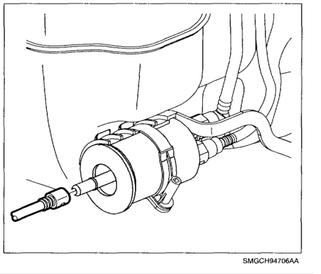

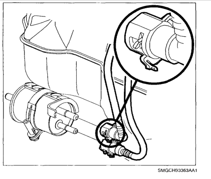

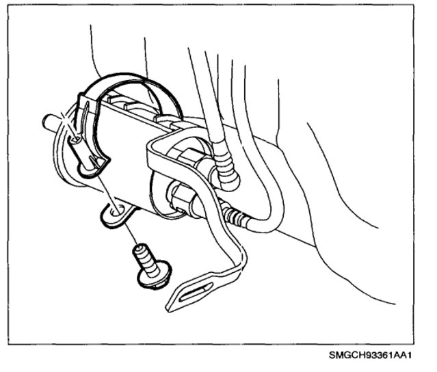

hello, this is my first time. i am try to replace the fuel filter on my car. i do not know how to remove the clips, can you help me on this? i appreciate. Thank you
Sep 19, 2017 at 10:40 AM
Yep those clips can be pesky. See if the new filter comes with new clips becasue sometimes they can break as you take them out. You will need to raise the car up safely before you begin.
Here is a guide that will give you an idea on what you are in for when doing the job.
https://www.2carpros.com/articles/how-to-change-a-fuel-filter
Here are some diagrams on what it is on your car (below)
Have a fluid catch bucket ready because a little gas will come out.
