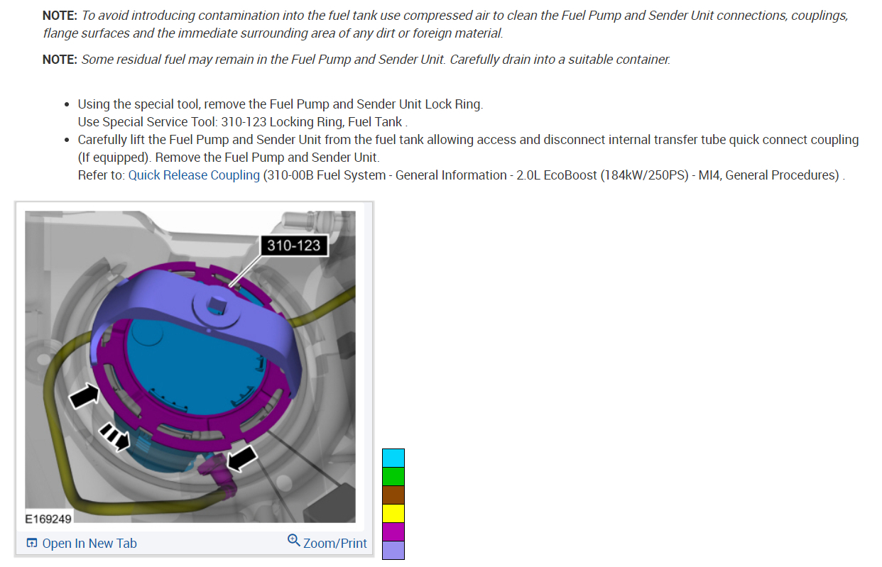

Need fuel filter location on the car listed above SE model.
Oct 21, 2020 at 2:08 PM

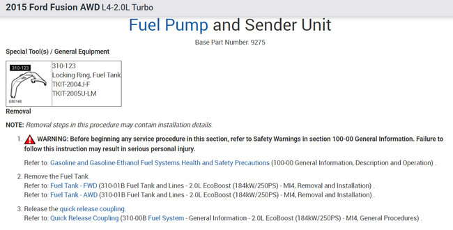

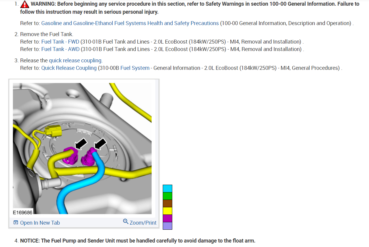

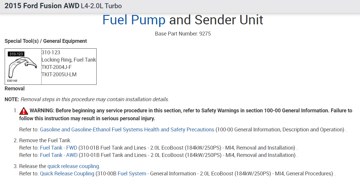

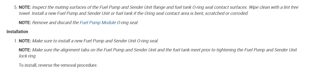

So there is not a fuel filter that is like a typical filter there is a fuel filter in the tank though. here is a guide to help walk you through the service with instructions below to help you with your car:
https://www.2carpros.com/articles/how-to-change-a-fuel-filter
Check out the diagrams (below). Please let us know if you need anything else to get the problem fixed.
