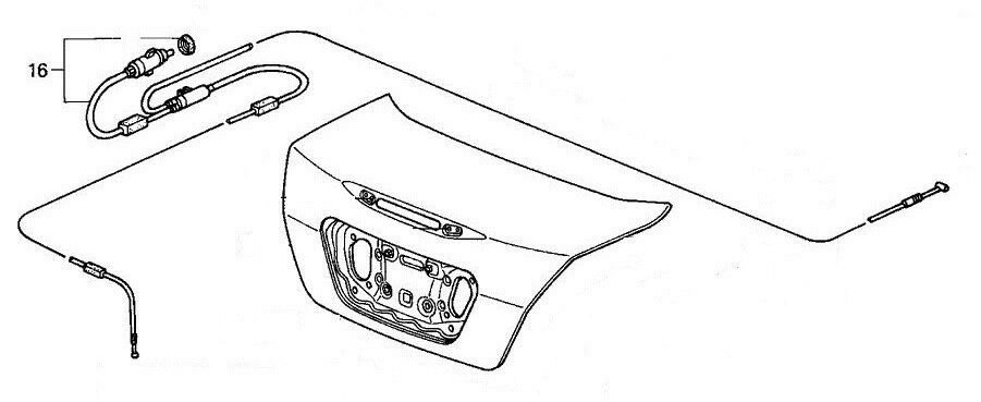

Good luck. Usually getting to the latch is the hard part. If it is a bad cable the trim below the door needs to come out to get at that end. Then the trim next to the rear seat. Or you can do like I have and stuff the replacement cable down through from the rear compartment and guide it to the lever. I generally don't like this design myself because of the latches, they get moisture in them and rust and this is the result. Some part fails and you can fill the car.
If you have any other questions just shout. Honda doesn't show any real good images of the system, just a sort of sketch of the routing.
The part numbers are 74880-SDA-A01 for the 4 door and 74880-SDN-A01 for the coupe. Those replace the entire part for the gas door and the trunk.
