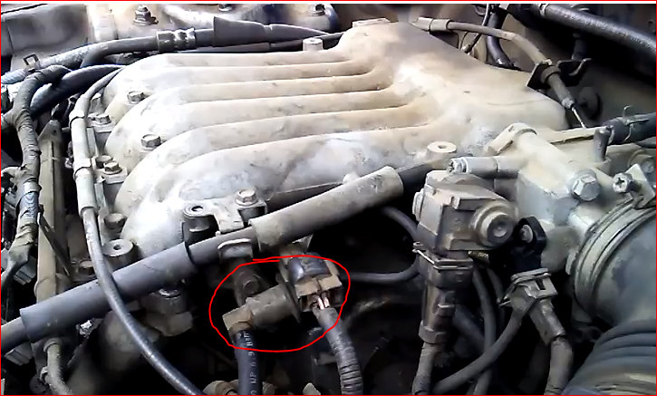

Ran vehicle low on fuel, now it will crank but want run for more than five to ten minutes before it shuts off. It seems to build pressure over night and will crank, I can drive it about a mile before it shuts off.
I pulled the fuel pump and drained the filter, then replaced it and the vehicle cranked and ran for five minutes before them.
I bought a fuel pressure regulator but I am not sure where it is located.
Please note I had a full service done three months ago, with new spark plugs, and wires. The vehicle was running fine until the low fuel incident.
