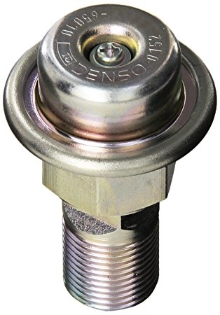

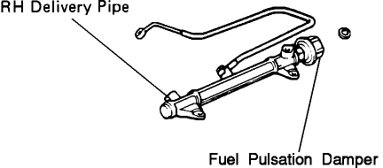

do not really know how long this has been happening bout after a while I noticed the smell of gas for a few months I would look and search for this smells source. After some months it got to the point of me having to find out where this smell is coming from. Finally I found the source and there is no information really about it. Before I knew the name I had to Google descriptions; yellow cap found by spark plug, yellow cap came off? Etc., finally I found something called the fuel regulator by after Googling the part it was not what I was looking at. Trying to figure this out. I saw a screw in the area of the yellow cap and grabbed it with a magnet without being able to really see I stuck me hand in this small space and believed to find where the screw went and after many fails finally screwed it in. I found out after searching for a screw being found the entire piece is called a fuel damper. Now the leak is not as bad. Should I really try to get the screw as tight as I can or is it going to eventually come out again?

It is a piece of metal with the screw in it which is pushed out when pressure is high to release the pressure there is a yellow cap that covers it.
For a long time the screw is in a tight spot so I was not sure if I was not tightening or if it was and popping out. But once I pushed it in by hand it has not popped out but I do have to tighten every now and then?
But the smell still happens every now and then.
Should I get I get in there and get it tight or repack this one hundred dollar piece?

Fuel leaks are never a good thing, many vehicle fires start that way. That screw is not supposed to be moved or adjusted. If it is loose the internal parts are damaged and it needs to be replaced.
Standard Motor Products FPD6
Toyota 23207-65010

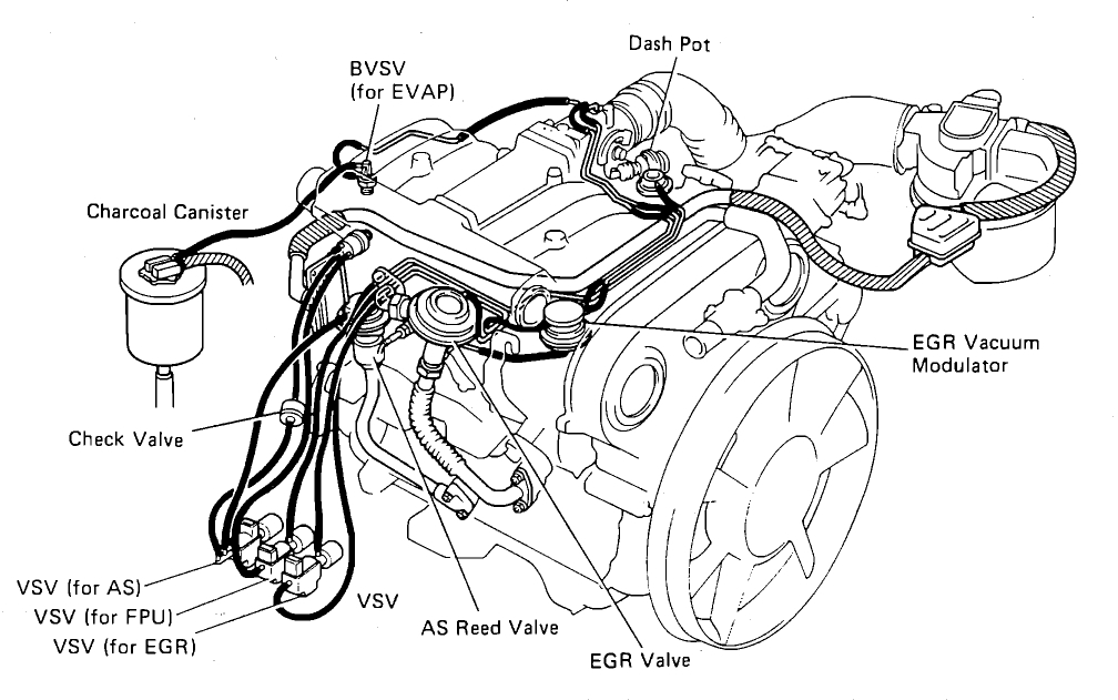

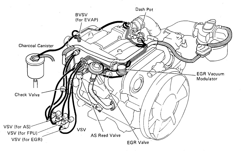

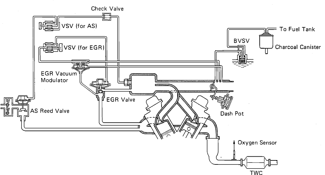

Thank you go the response. I know nothing about vehicles; so the diagram is hard to understand. So if you do not mind I have specific questions.
Vacuum lines:
- There are two lines under the power steering canister. Where do these connect to?
- There isare y PVC pipes what connects to those?
-In front of the damper there was a line that connected the throttle to the black canister. And it has broke? Can I connect the canister directly to the throttle?

Without being the one who removed them or having that vehicle in front of me those are going to be tough to answer. My SOP on vacuum lines is to always mark them because even on "identical" vehicles they are sometimes routed different. That sometimes is not a problem if they are all connected to one vacuum source using a manifold, but others are critical.
I did look online for pictures but most of them are the same diagrams as I posted. There were a few youtube videos that might help you though.
