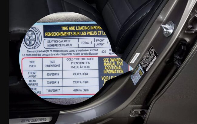

There is a label on your door jamb that will tell you what the manufacturer recommends for tire inflation for the best fuel economy, tire life and how the vehicle rides. In my opinion this is where it should be set regardless of the season.
If they did this you can check the label on the door jamb, (I will add a picture for you) and make sure they are inflated properly.
You should be able to view your tire pressures through your instrument cluster. It should tell you what each tire is at.
All tire pressures should be set and checked with the tires cold. But if a customer comes in say off the highway or has been using the vehicle in general the tire pressures will be higher than the specified value from the manufacturer because the tires are warmed up. So, it is possible they reduced the tire pressure, affecting fuel economy.
So, I would check the label and see what they are supposed to be at. Your vehicle should be around 34 PSI front and 34 PSI rear. But check the label on the vehicle as it depends on the weight of the vehicle and this label should always be followed.

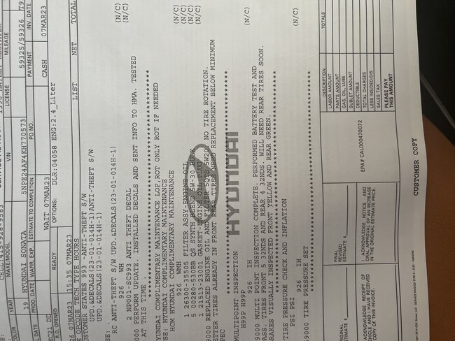

The next thing I would check is the slip they gave you and see what oil they put in it. A lot of dealers put what is known as bulk oil in vehicles. Hyundai recommends either 5w20 or 5w30 but says for better fuel economy 5w20 should be used. So, if they put 5w30 in it will affect fuel economy.
**Note that this vehicle should be under warranty and bulk oil should not be used.**
The reason for this is the 5w30 is thicker when the engine is at operating temperature.
Most dealerships will have 5w30 in bulk because it goes in most vehicles and is cheaper for them.
So, I would double check your tire pressures and I would check the paperwork they gave you and see what oil was put in your car.
Please let me know if any other work was performed, like air filter replacement.
Let me know what you come up with and message me back so we can go from there.
