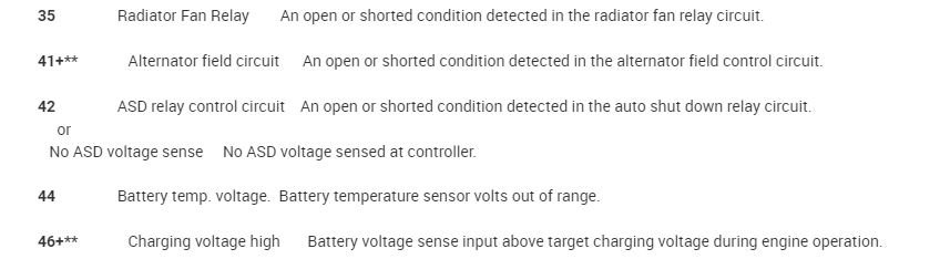

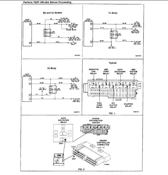

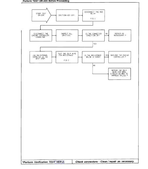

Replaced the fuel pump but now fuel gauge won't move at all. it won't start even if I put fuel straight in the carburetor. It show code 42 which is auto shut down.. If the fuel gauge isn't coming on but that keep the engine from starting.
