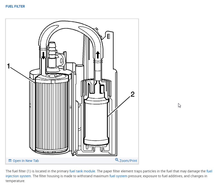

Need to locate the fuel filter on the vehicle listed above.
Sep 11, 2020 at 4:37 PM
The fuel filter on this engine is part of the fuel pump assembly located in the tank. Take a look at the attachment.
The filter only requires replacement when the tank is dropped for another reason or there is an issue that requires its replacement. It is not a maintenance item.
Let me know if there are other questions. Thanks
