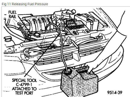

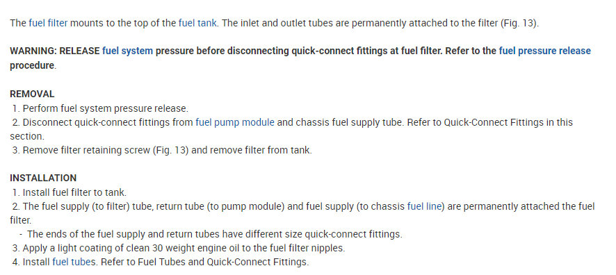

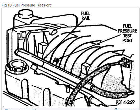

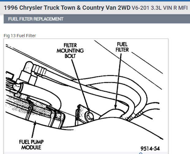

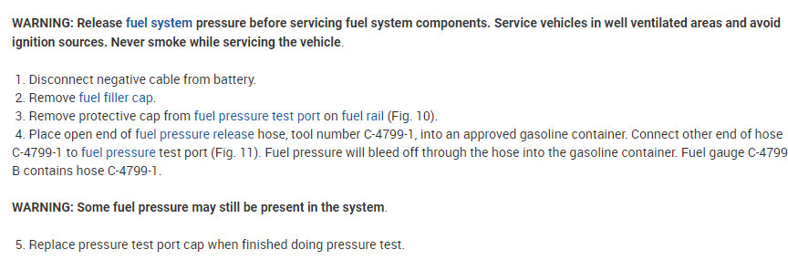

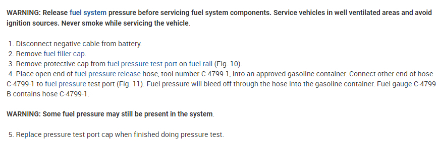

The fuel filter is attached to the top of the fuel tank. The special tools you will need are for disconnecting the fuel lines and are available at any auto parts stores. here is a tutorial showing how to replace a fuel filter:
https://www.2carpros.com/articles/how-to-change-a-fuel-filter

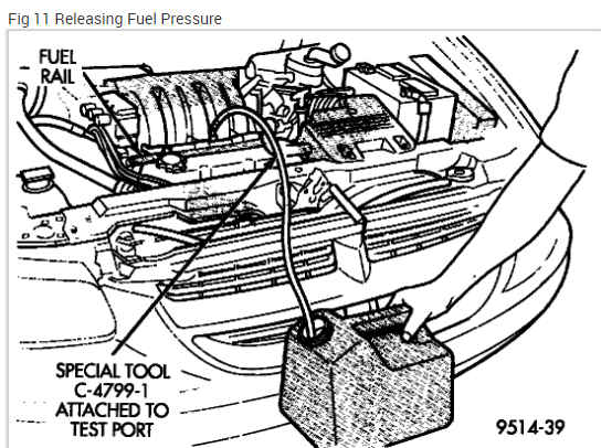

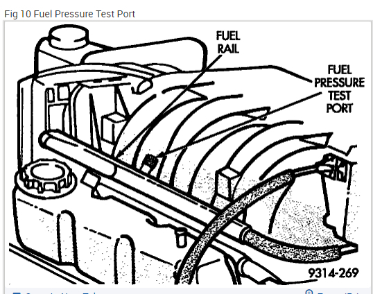

I've attached picture steps below showing the fuel filter location, replacement steps, and how to relieve pressure from the fuel system on your van. Hope this helps and thanks for using 2CarPros.
