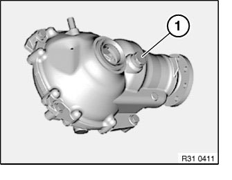

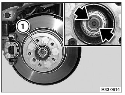

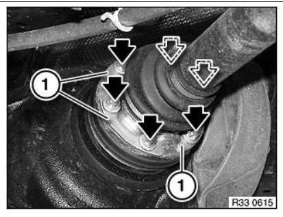

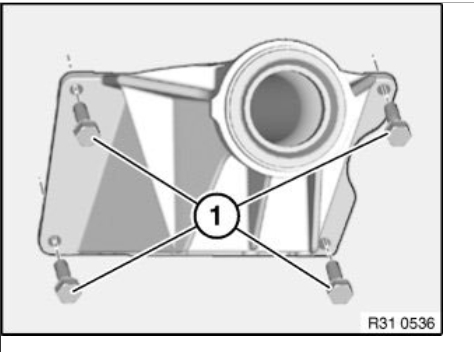

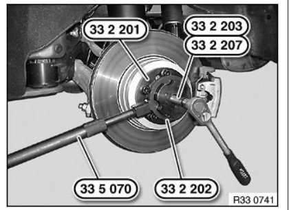

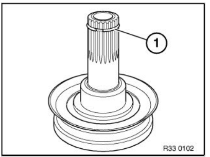

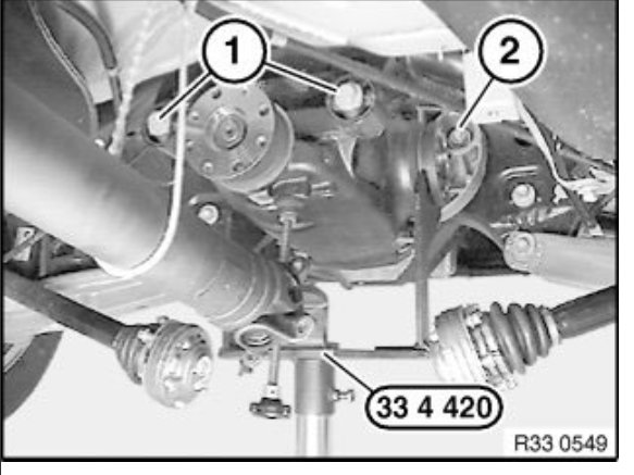

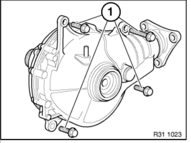

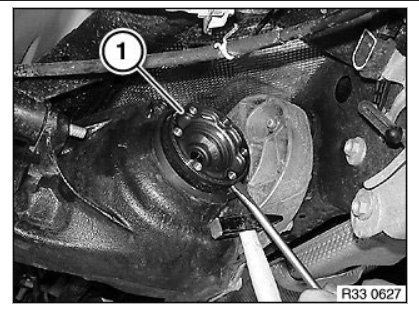

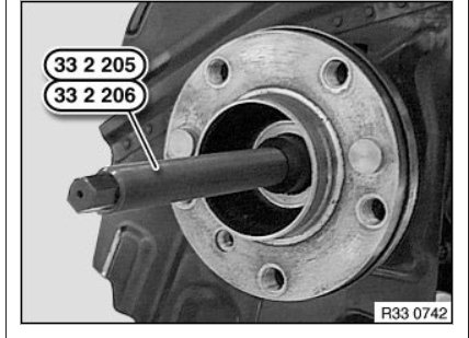

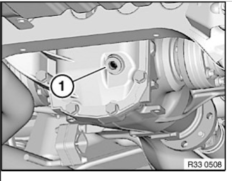

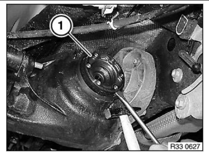

Yep I will need to go with F4I_GUY and say it is a differential that is having a problem. I would remove the Here are some diagrams to help you see what's going on. Try to isolate the noise front or rear of the car.
I would get a sample of the gear oil to see if one has more metal in it than the other this would be the differential that has the bad bearing.
Here are some diagrams (Below) to help you sew what you are in for when checking the fluid and removing the differential for service.
Please run some tests and get back to us.
