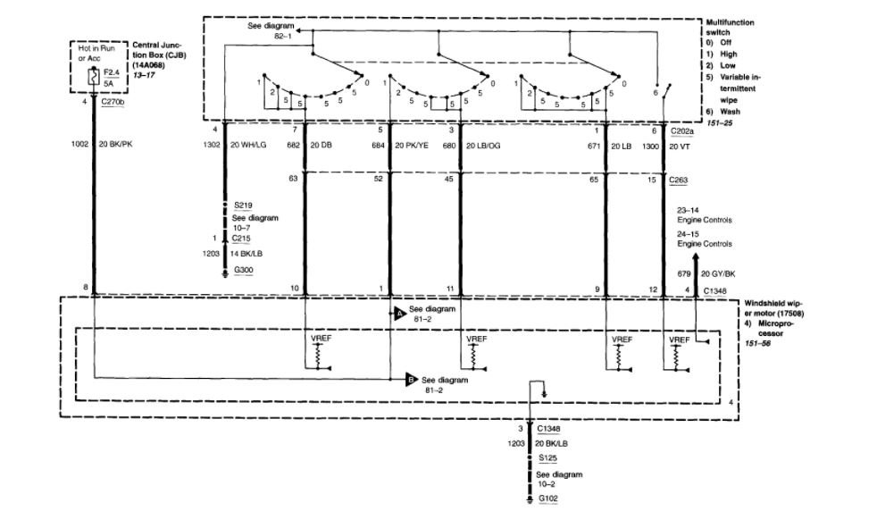

The front wipers only work on high and will not park and the front washer does not work. I changed the column mounted master switch assembly that controls front and rear wipers turn signals and hi lo lights, no difference. then i changed the wiper motor still no difference. i am at a loss for what else to check or change. thank you for your previous help it definitely pointed me in the correct direction.

Let me get a diagram for you.
Dec 19, 2017 at 8:25 AM
Okay, check the dark blue wire coming out of the switch at the motor for power with key and wipers commanded to high.
If you have power, motor is bad. If you do not then the multi function switch is the failure.

no, to the motor. Want to make sure proper signal is being sent to the motor

this has nothing to do with changing parts. We are trying to determine if there is a wiring fault. That is why I am asking for voltage checks.

If there is power, it indicates a wiper motor issue. If there is no power it is either the multifunction switch or wiring
