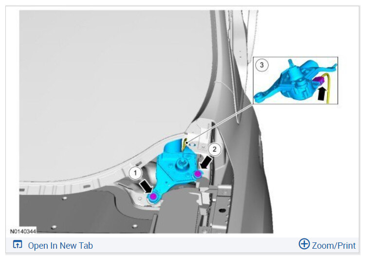

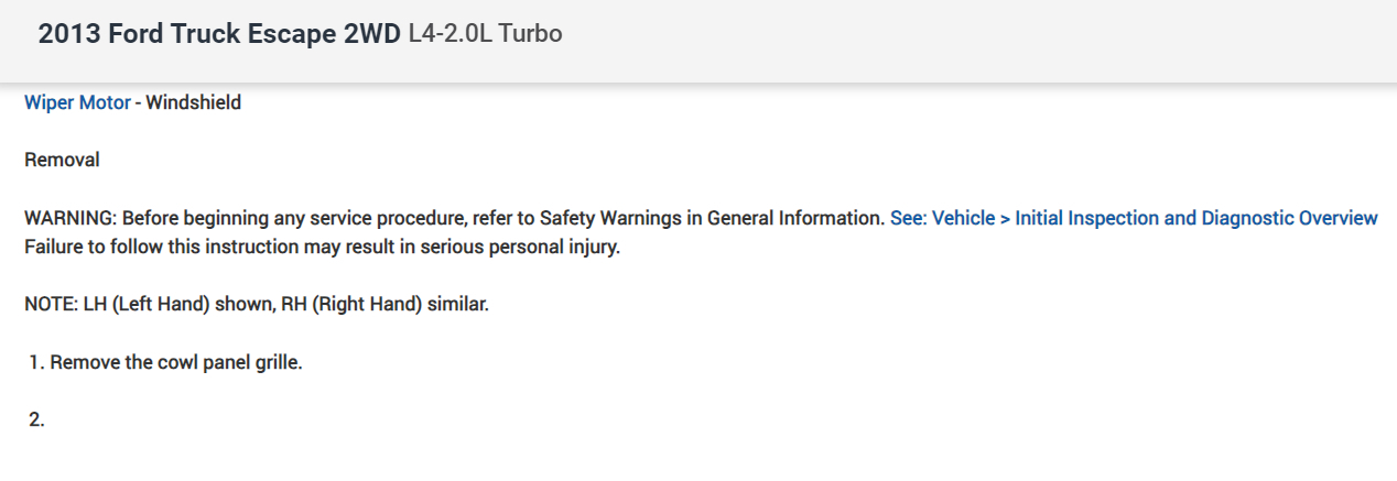

Yep, this is common, the driver side wiper motor needs to be replaced. here is how the job is done to fix the problem. Check out the images (below). Let us know if you need anything else.
