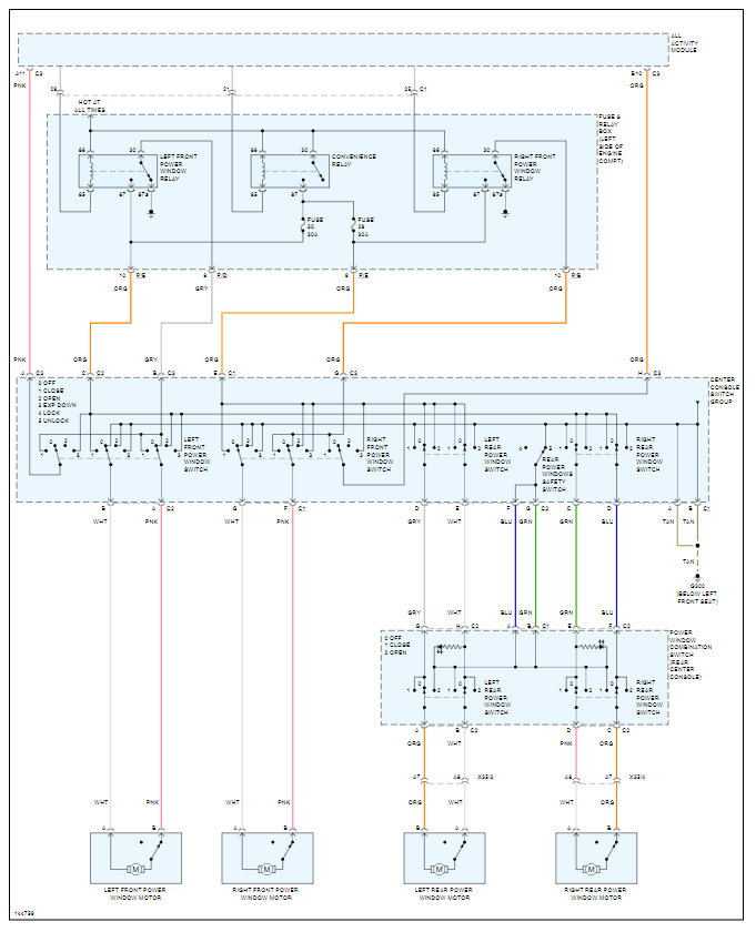

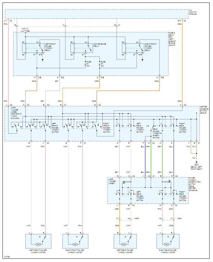

Take a look at the wiring diagram. If both front stopped working at the same time, I suspect the driver window switch is the issue. They each have their own relay so it is unlikely that they both failed at the same time. So that means the switch is the most likely issue. We need to test voltage coming out of the switch and coming into it from the relay. If you have it going in and not out then the switch is the issue.

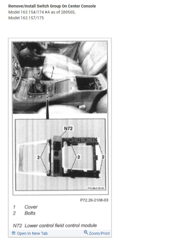

I am attaching the process on how to replace this switch. Let us know what other questions you have. Thanks
