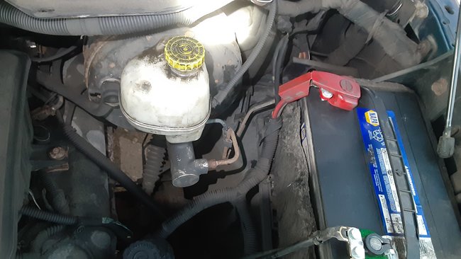

The worst case is if a brake releases when you loosen the steel lines right at the master cylinder. That is caused by brake fluid contaminated with a petroleum product such as engine oil, transmission fluid, power steering fluid, axle grease, or penetrating oil. That contamination causes rubber parts to swell. A clue is the rubber bladder seal under the reservoir's cap will be blown up and mushy, and you won't be able to pop it back in place. In the master cylinder, the rubber lip seals grow past the fluid return ports and blocks them. Another clue is since the brakes are dragging, they get hot, and that heat migrates into the brake fluid causing it to expand. Since it can't get back to the reservoir, it applies the calipers harder and harder.
I don't think you're going to run into this contamination, but if you do, the only proper repair is to remove every part in the hydraulic system that contains rubber parts that contact the brake fluid, flush and dry the steel lines, then install all new rubber parts. That includes the master cylinder, calipers, rubber flex hoses, combination valve assembly, ABS valve assembly, and when used, wheel cylinders, ABS controller, and rear height-sensing proportioning valve. If any rubber part is not replaced, the contamination will leach out of it and recontaminate the new brake fluid.
