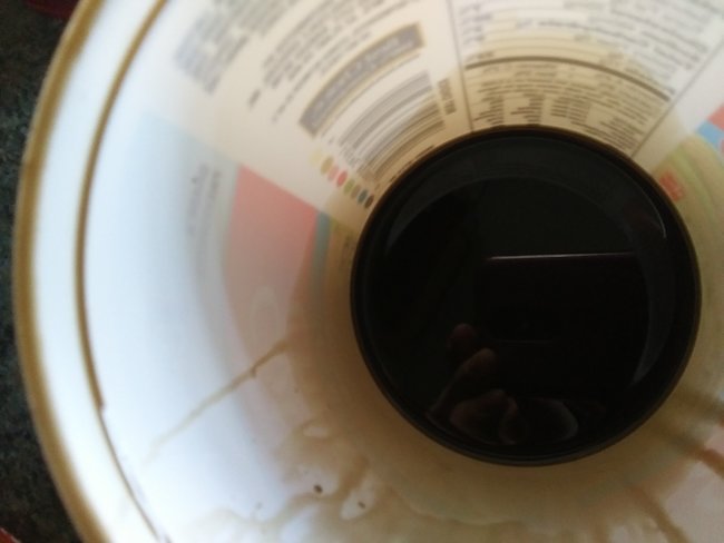

Hey Joe, yesterday finally got under front end of Blazer. I found that my car has both upper ball joints ready to fall out. Opened up gear box no oil in there or pretty close to none. I am in shock I had a tie rod end done and was never told about ball joints.
Could these be the focus of my issues?
How hard are these to do?
Mar 27, 2019 at 6:04 AM
CHARLIEGIRL223
  • 8 POSTS
This is all that was in it. not good huh?
Mar 27, 2019 at 7:07 AM

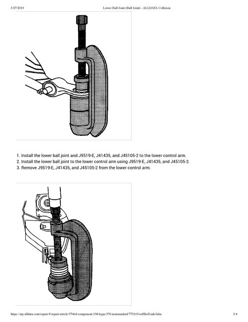

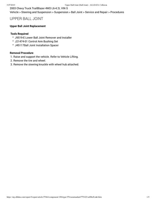

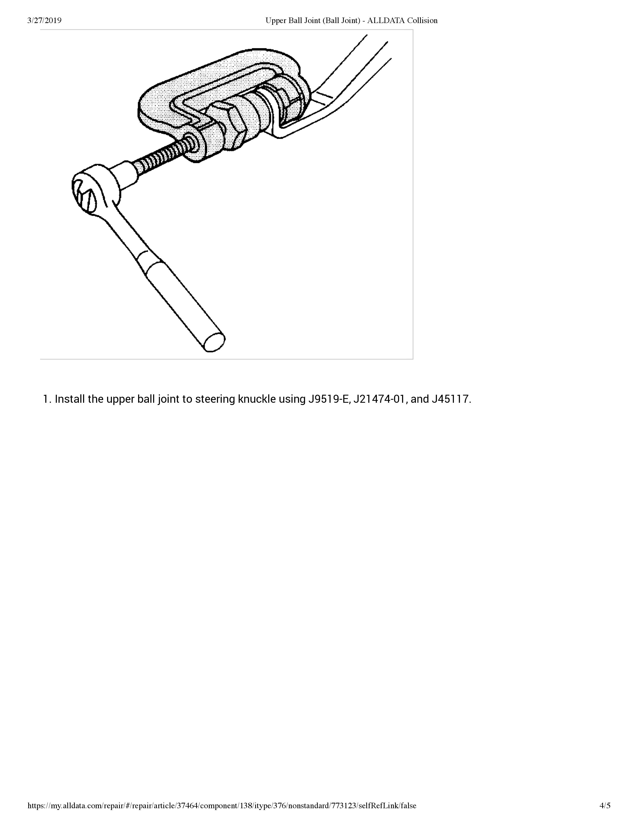

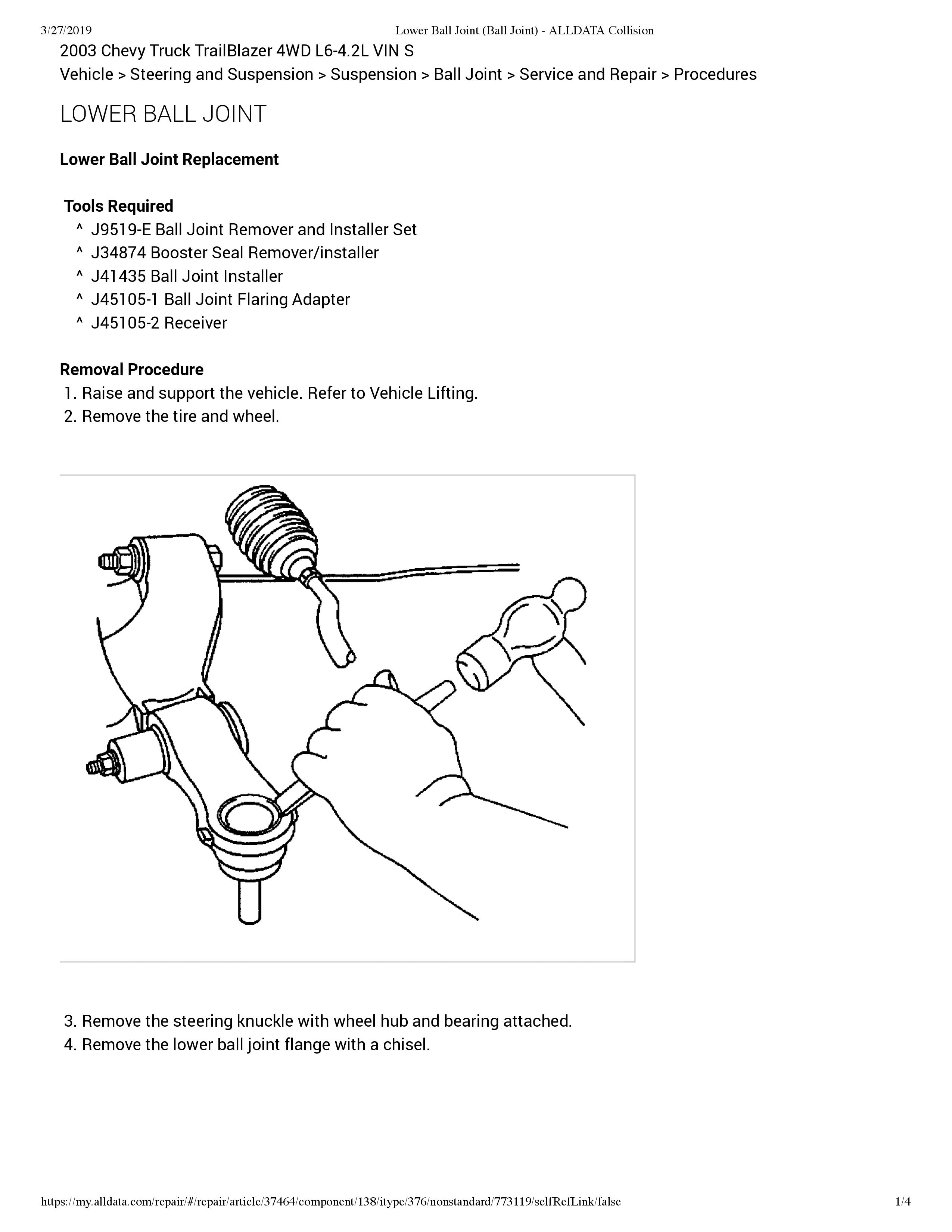

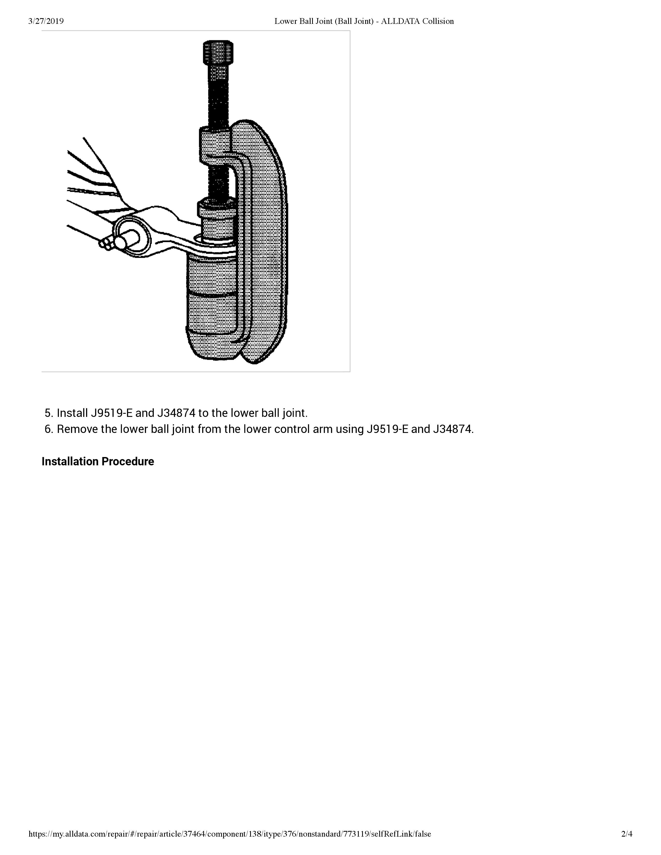

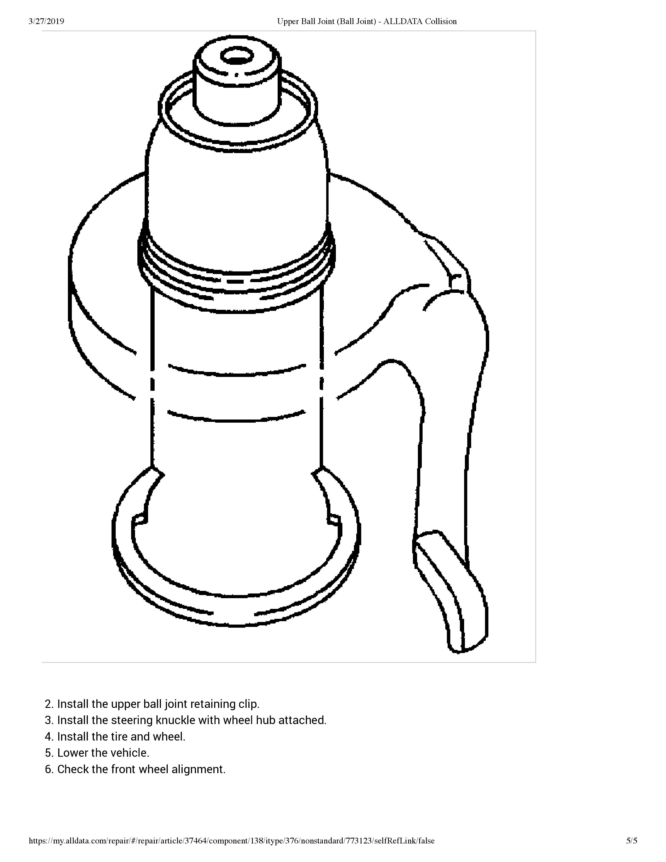

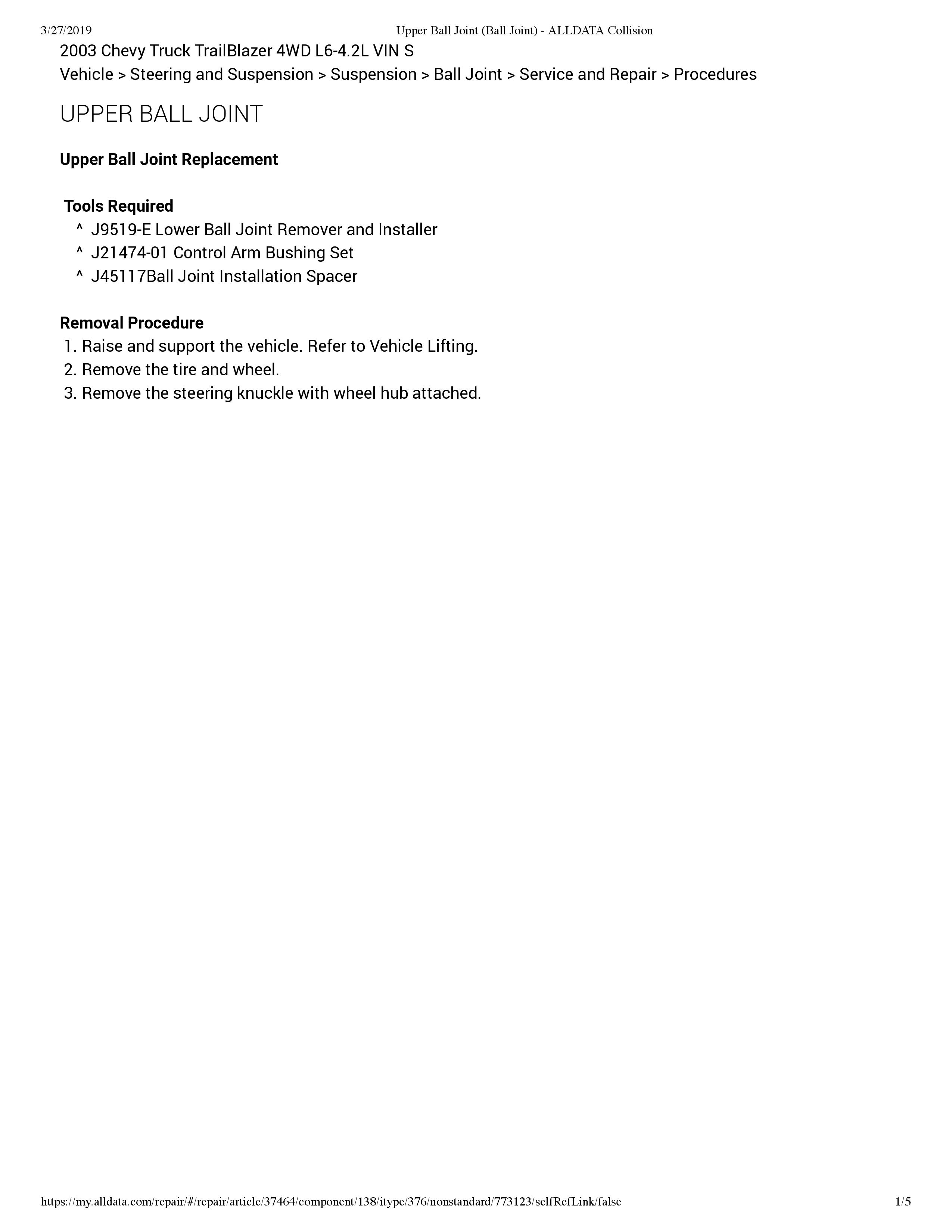

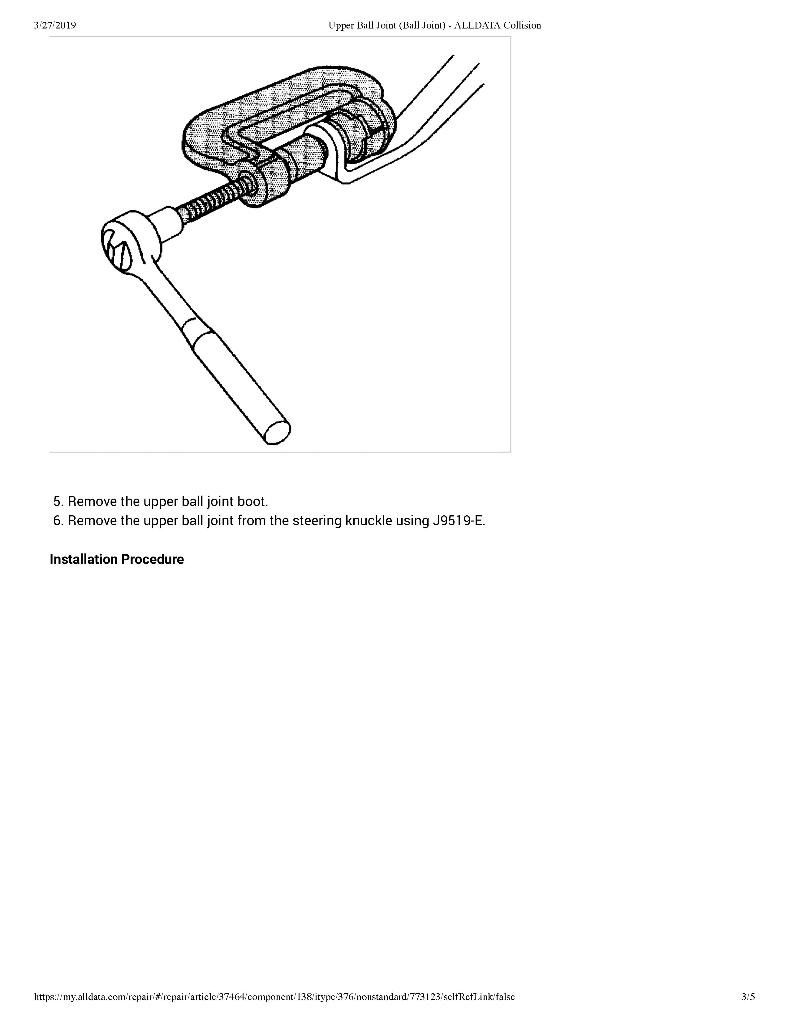

JOETECHPRO
  • 705 POSTS

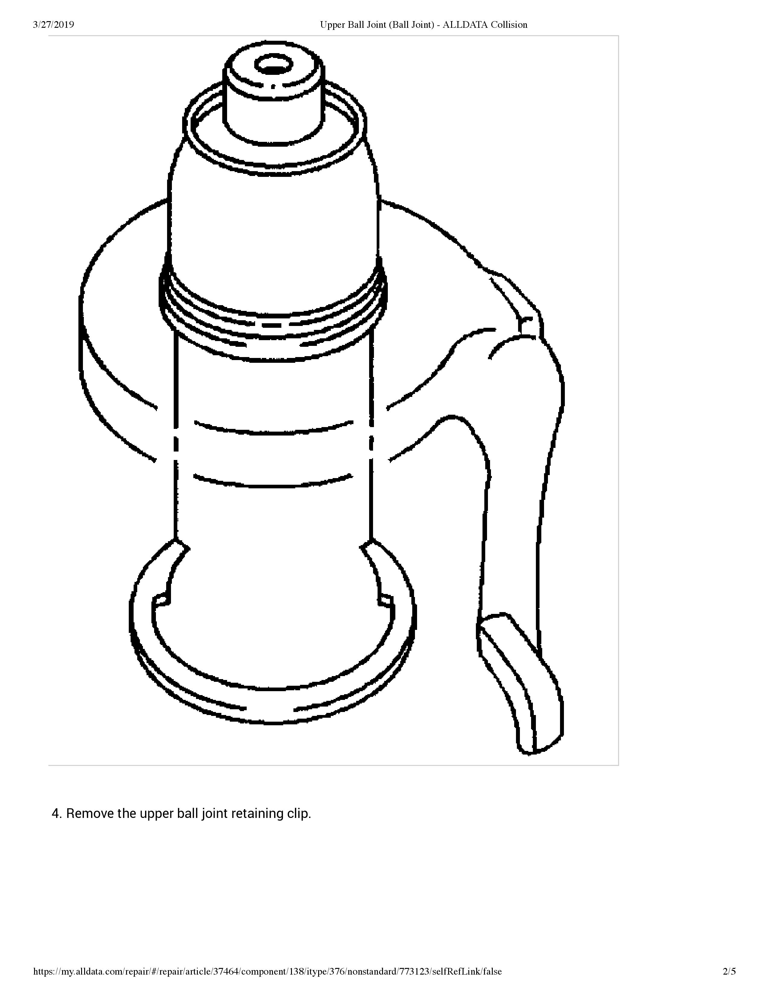

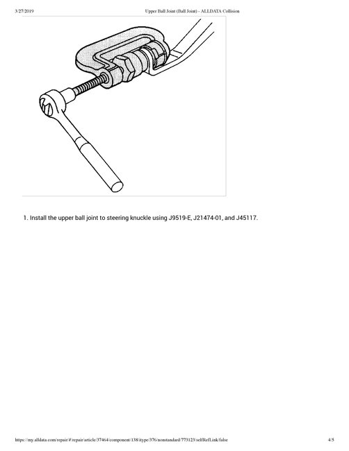

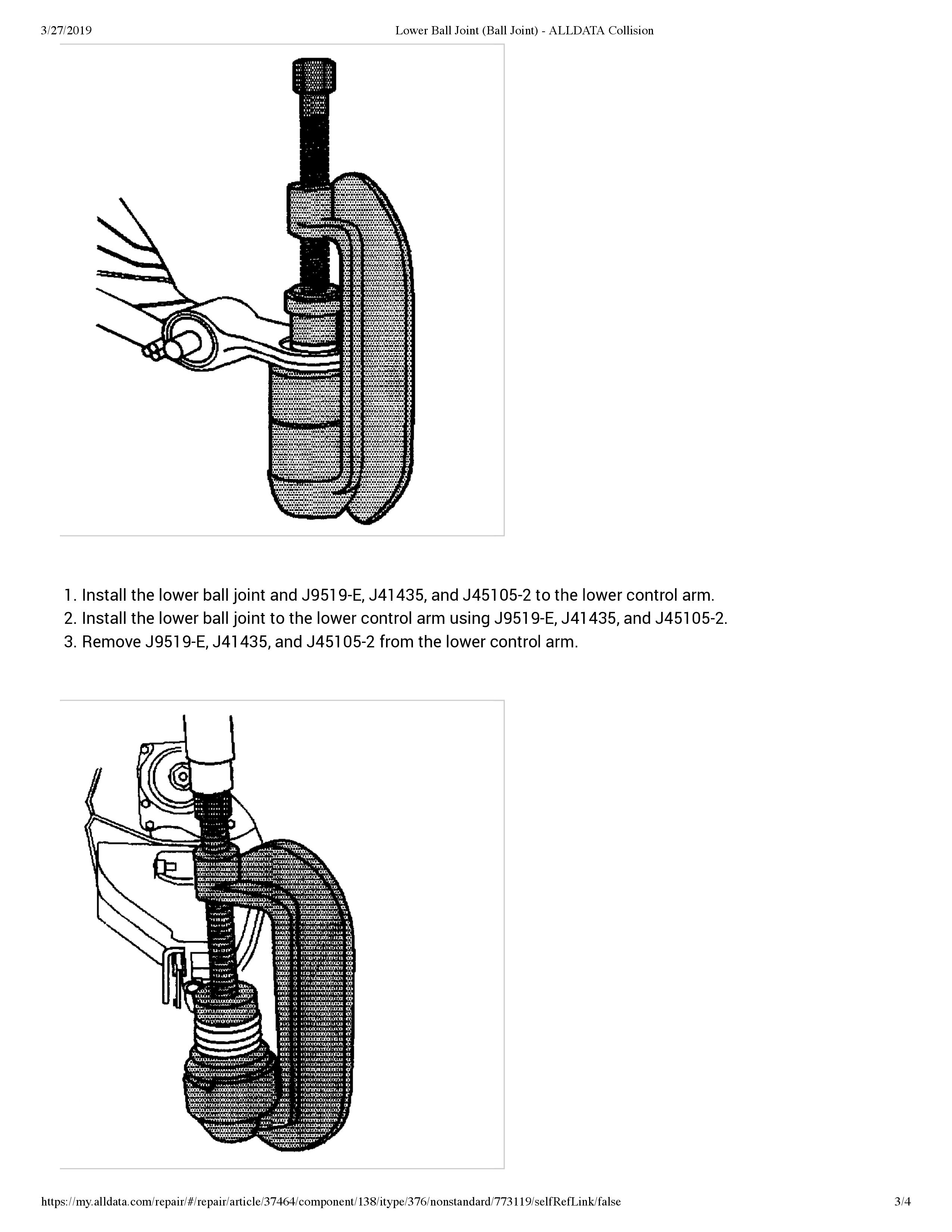

Hey CHARLIEGIRL223,
Ball joint repair instructions below for the lower and upper.
Regards, Joe
Mar 27, 2019 at 10:40 AM

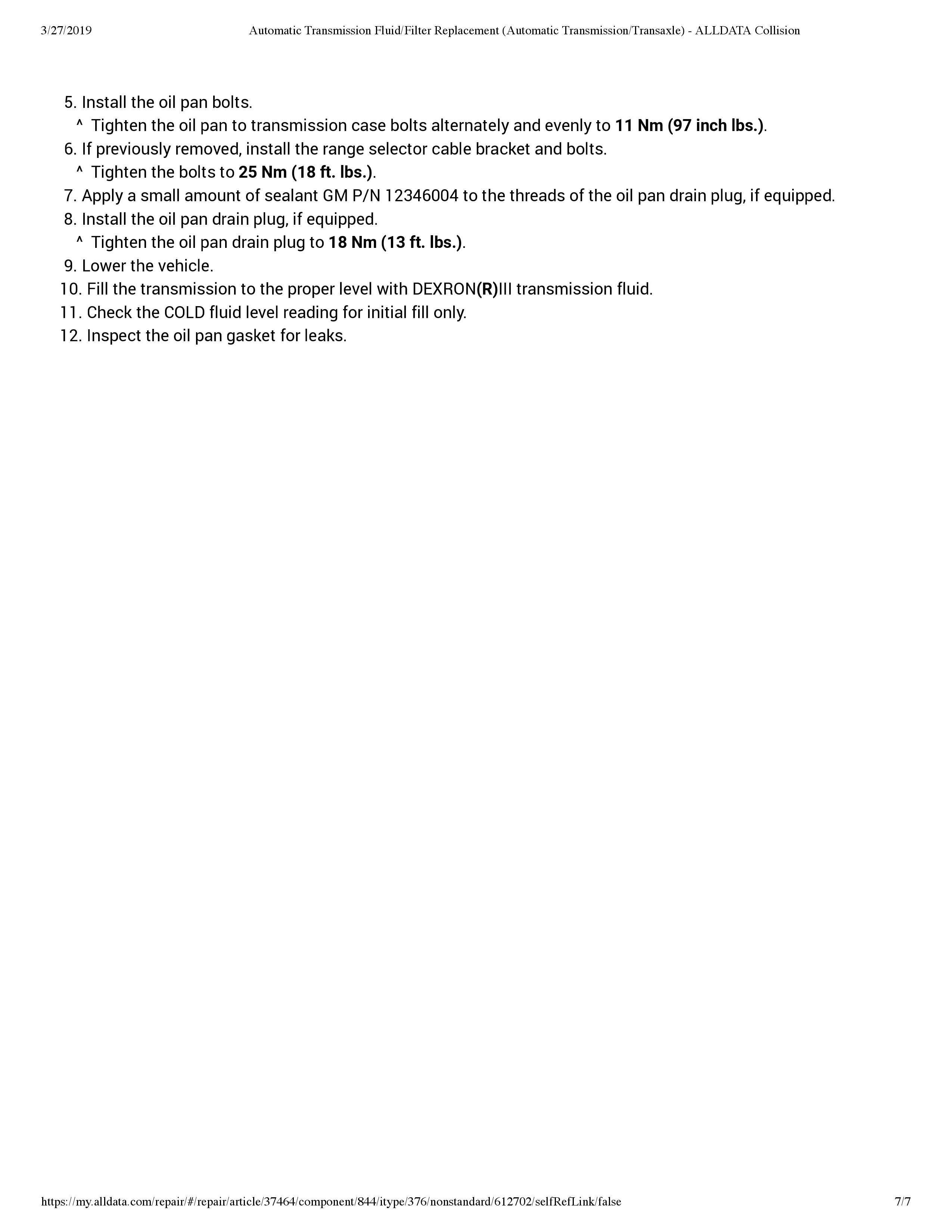

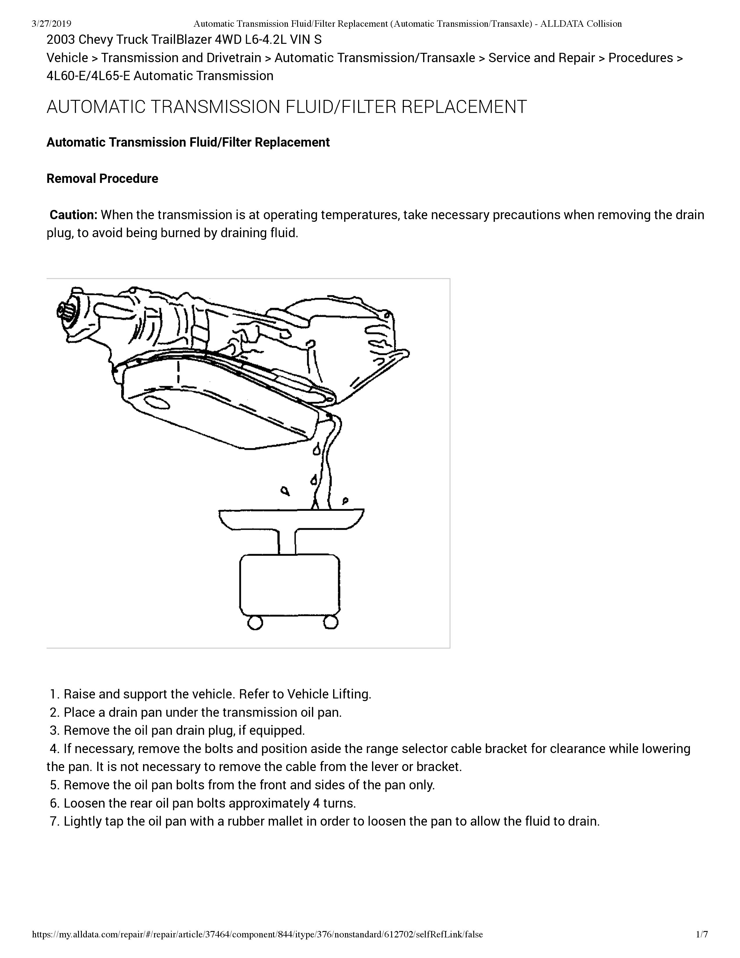

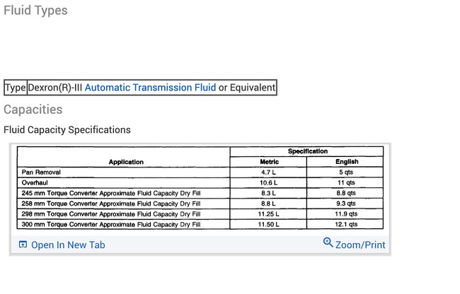

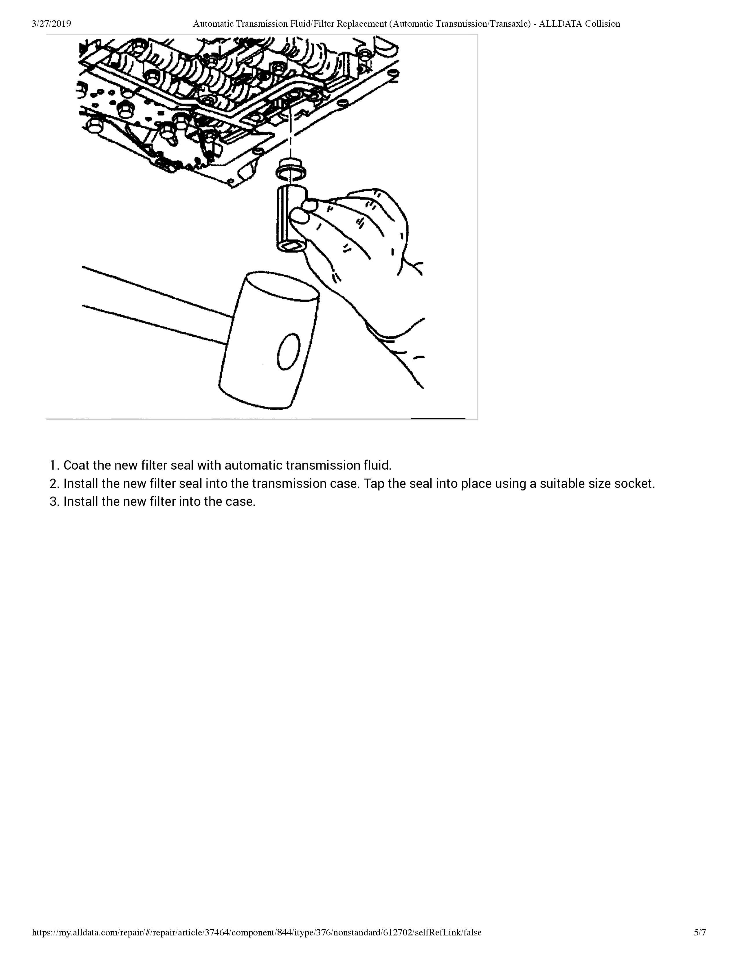

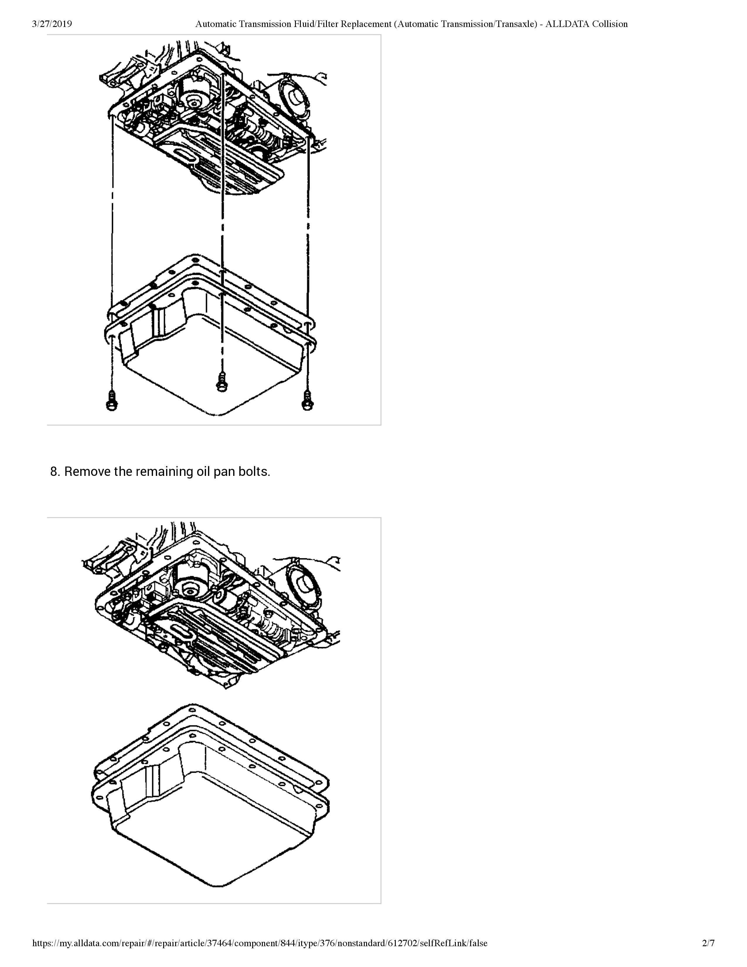

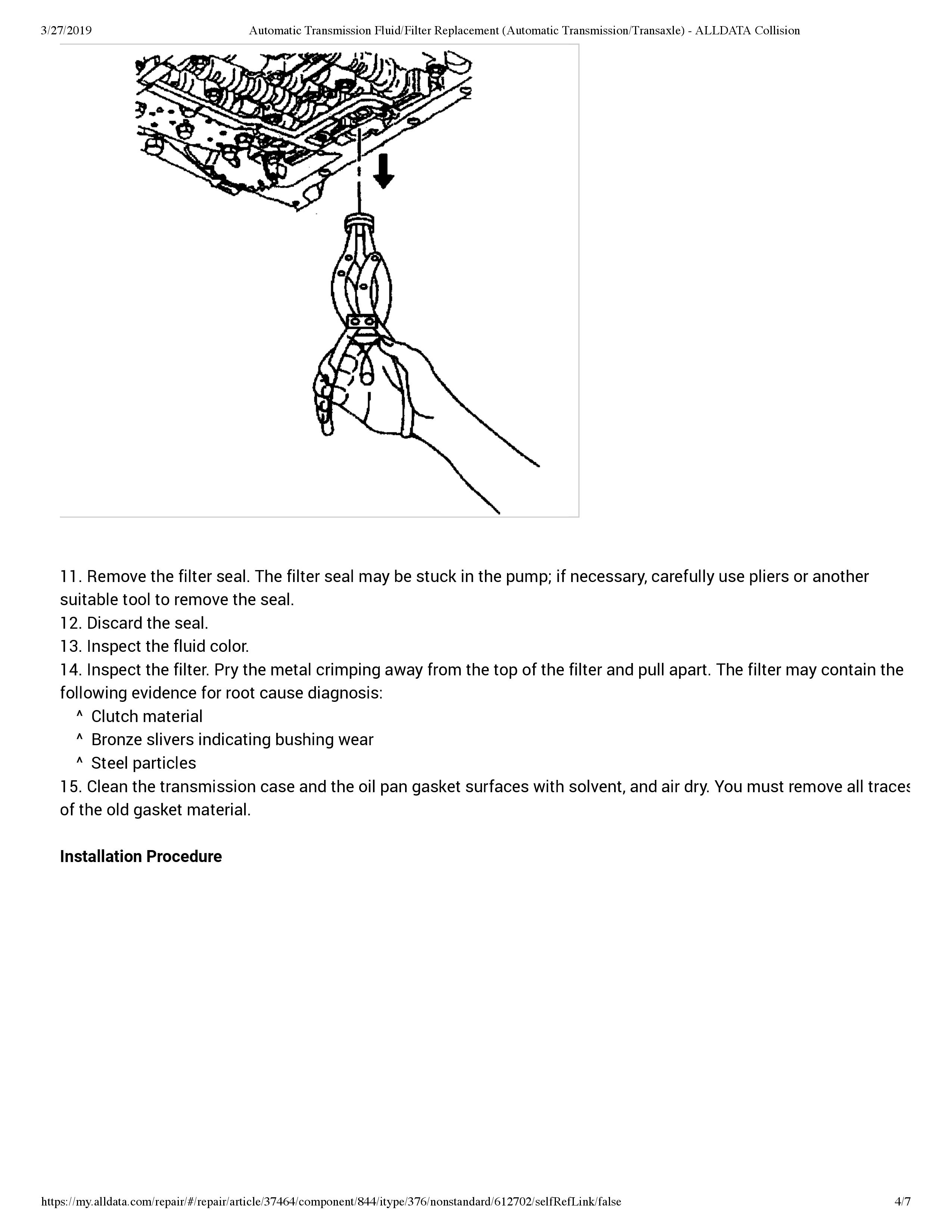

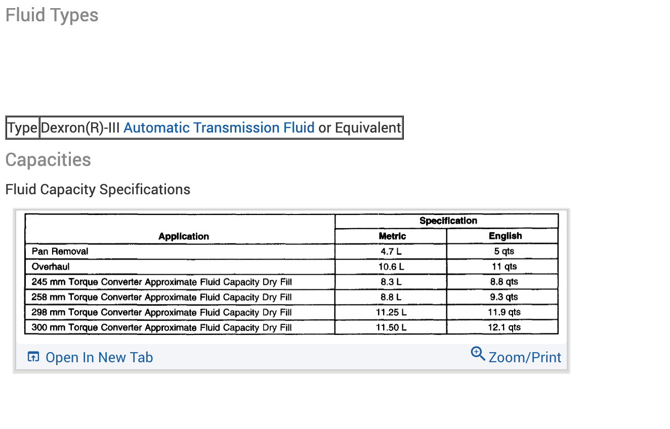

JOETECHPRO
  • 705 POSTS

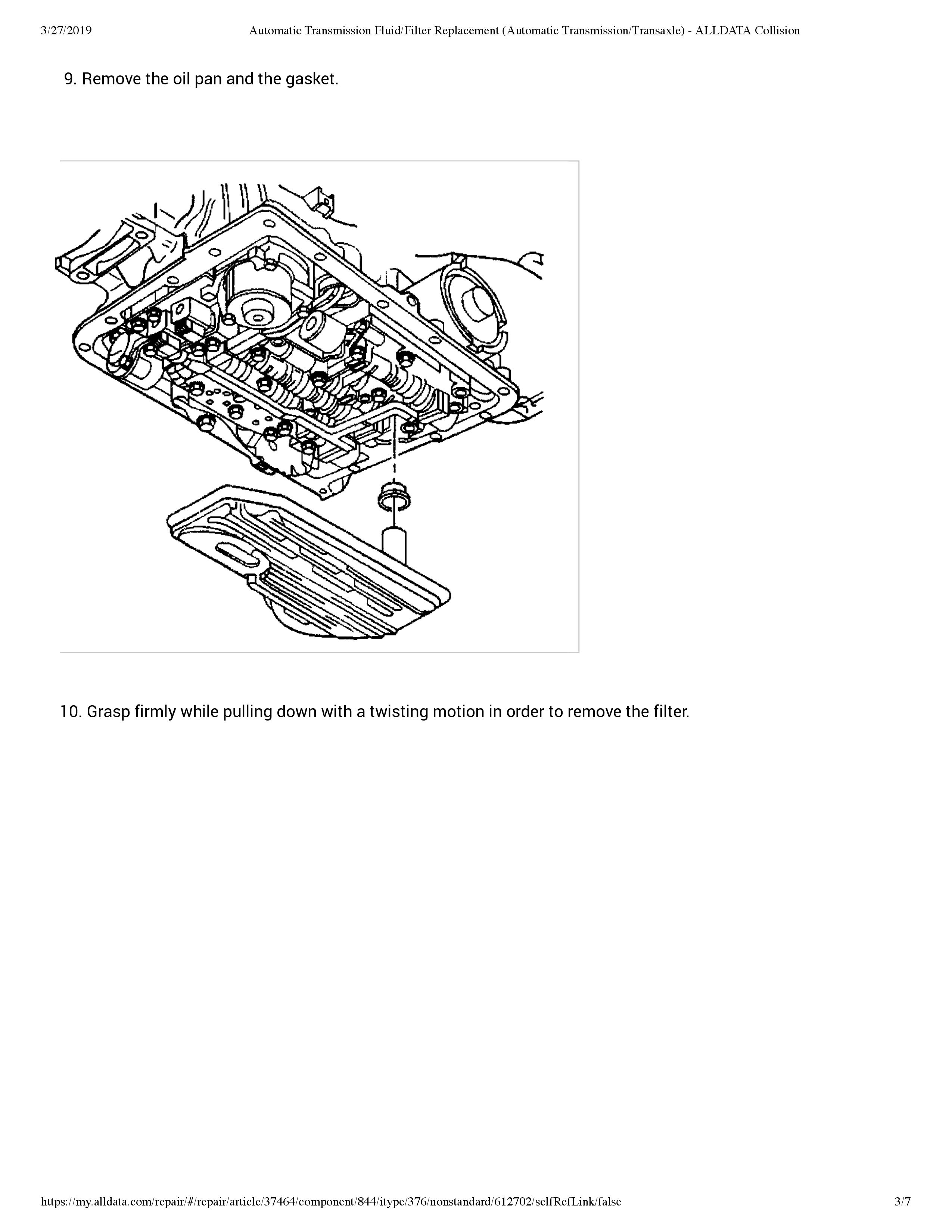

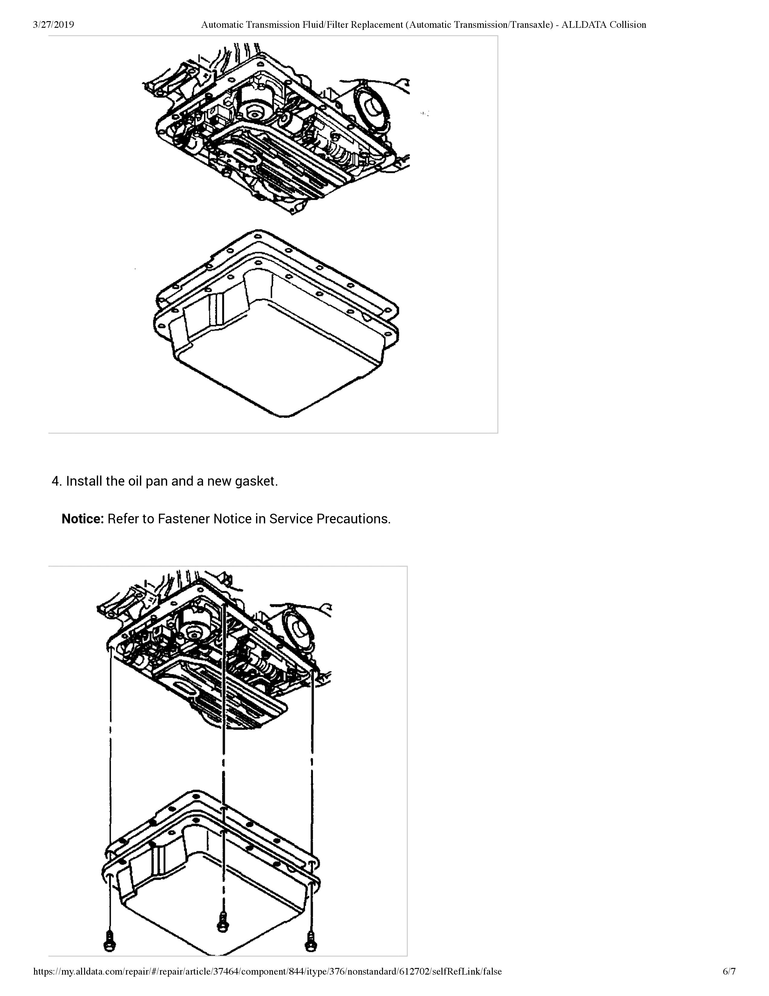

Hey CHARLIEGIRL223,
Instructions on replacement of transmission oil filter and refill below.
The transmission should take 4.7L of oil after filter replacement.
Regards, Joe
