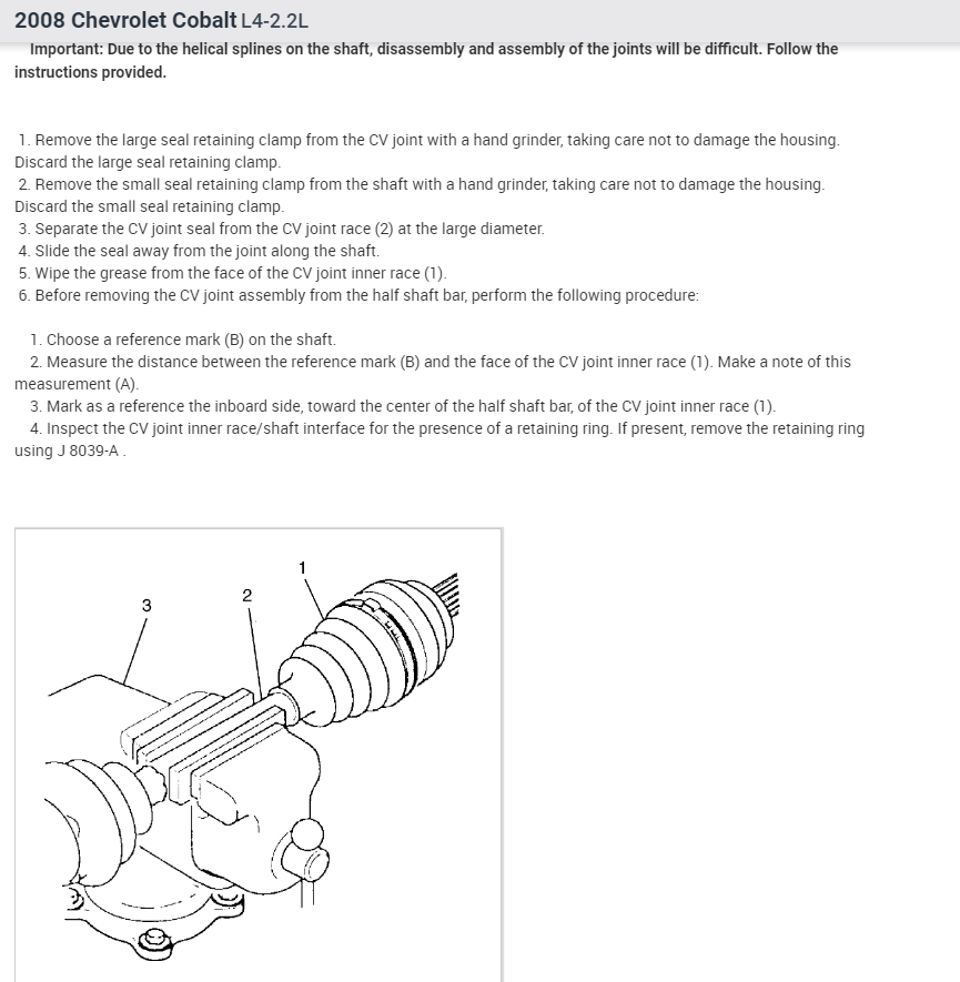

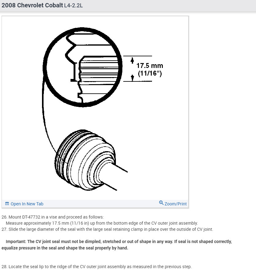

Can you clarify if you are talking about a torn CV boot or a tie rod bushing?
https://www.2carpros.com/articles/clicking-sound

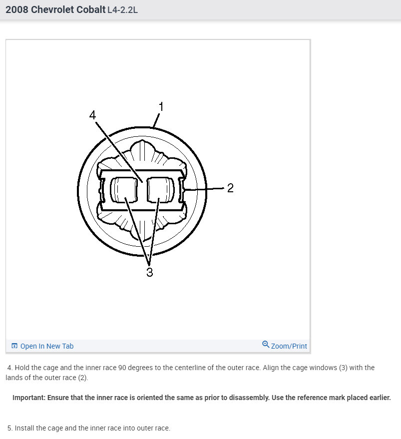

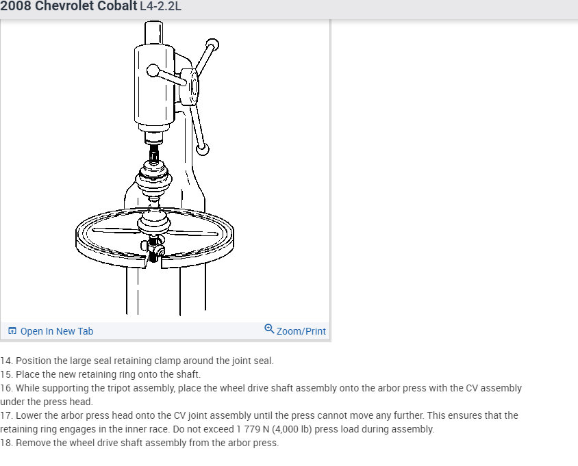

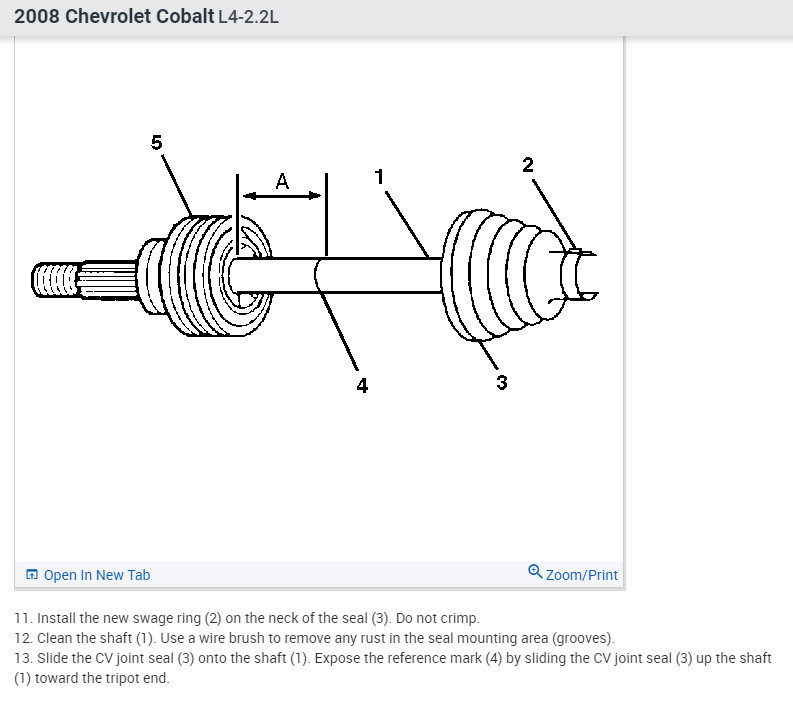

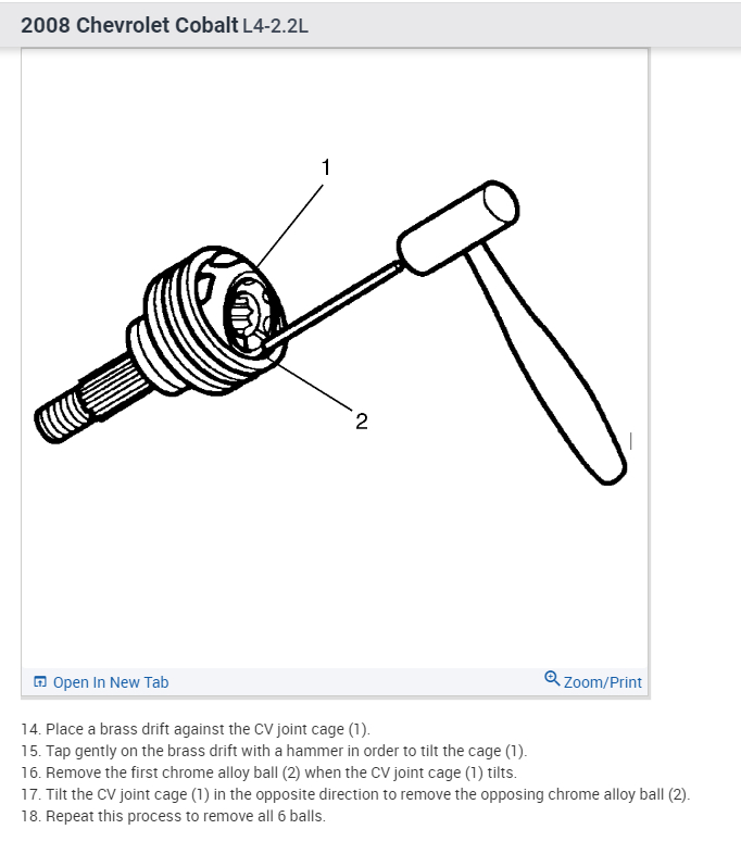

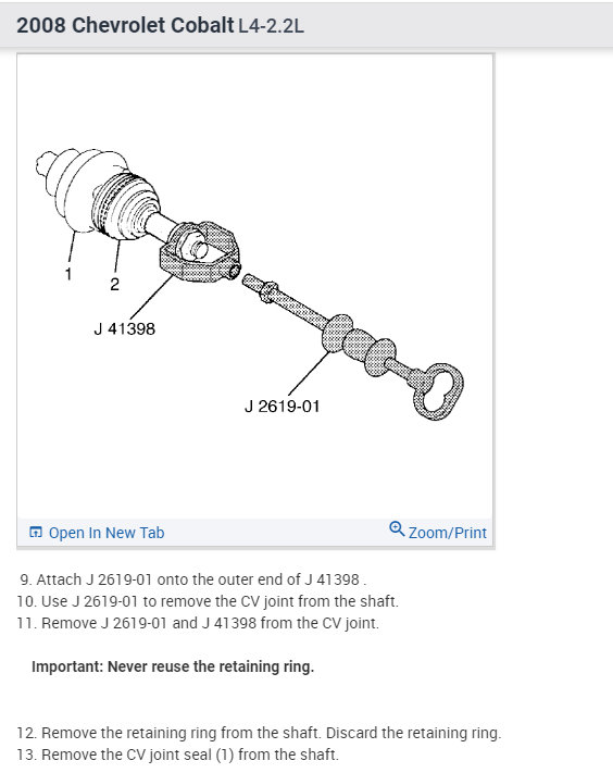

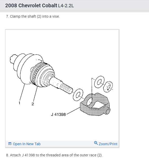

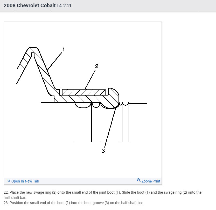

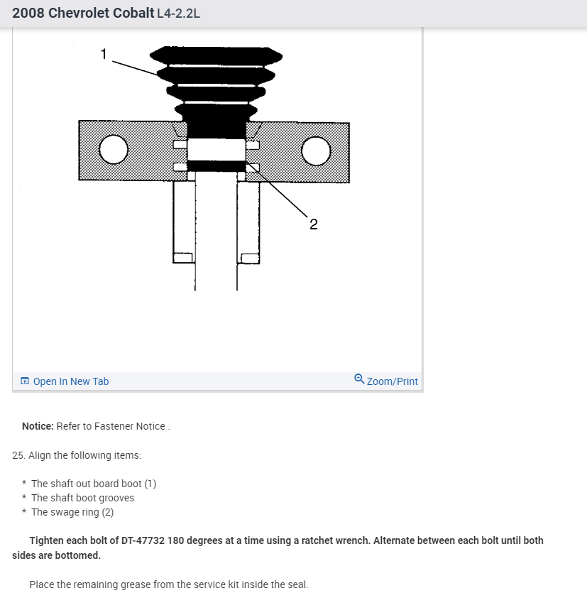

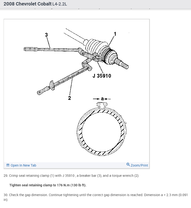

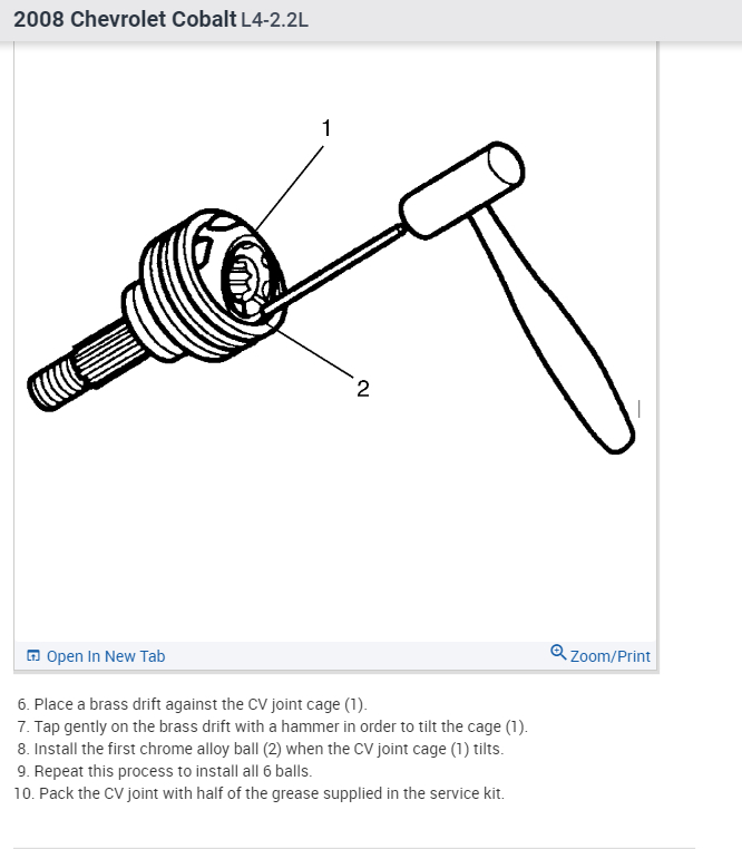

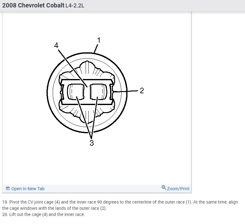

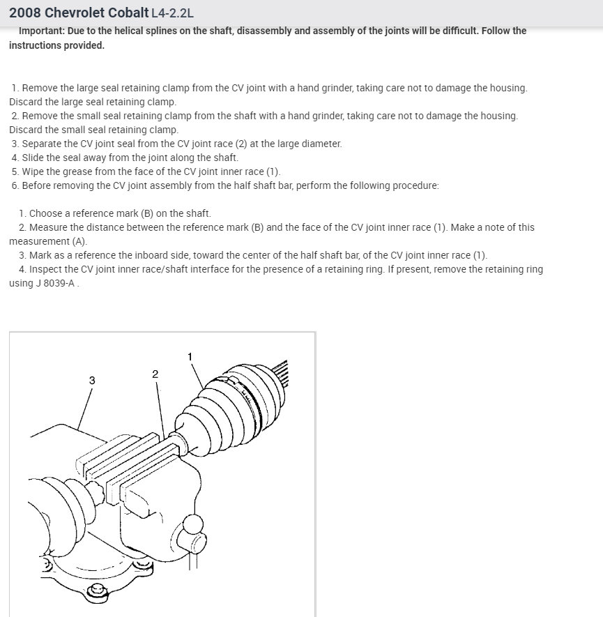

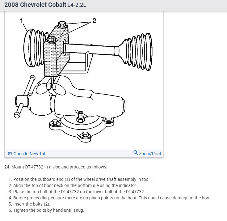

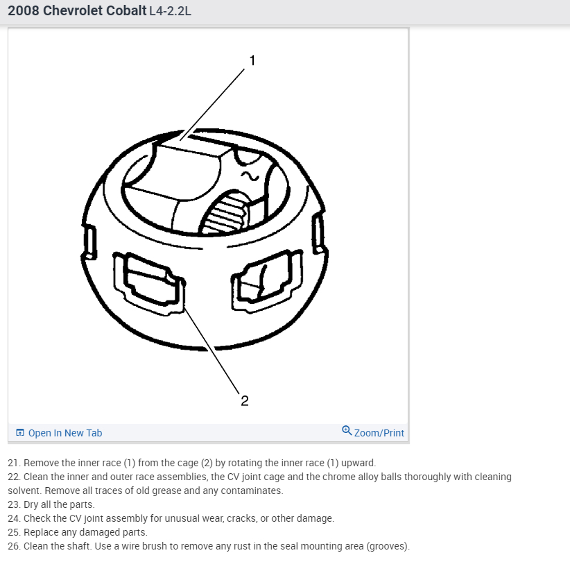

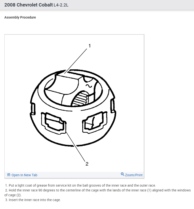

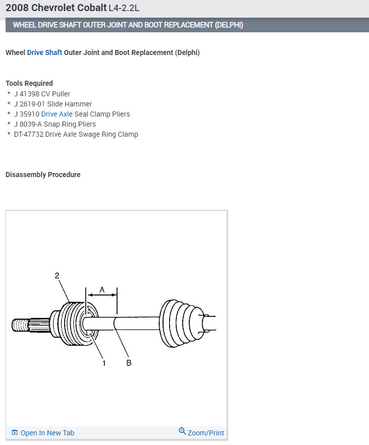

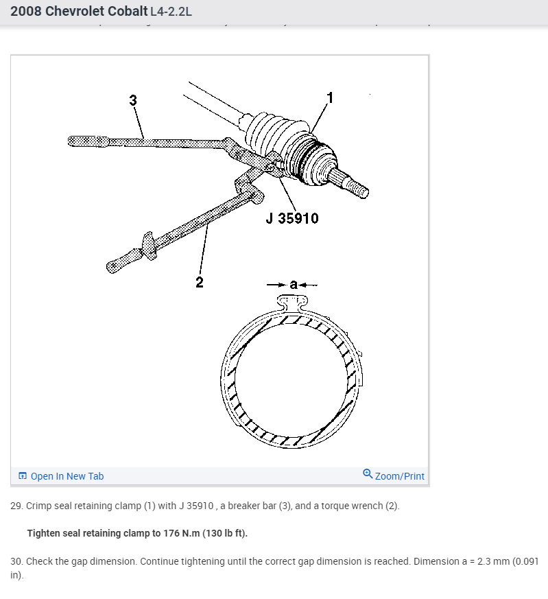

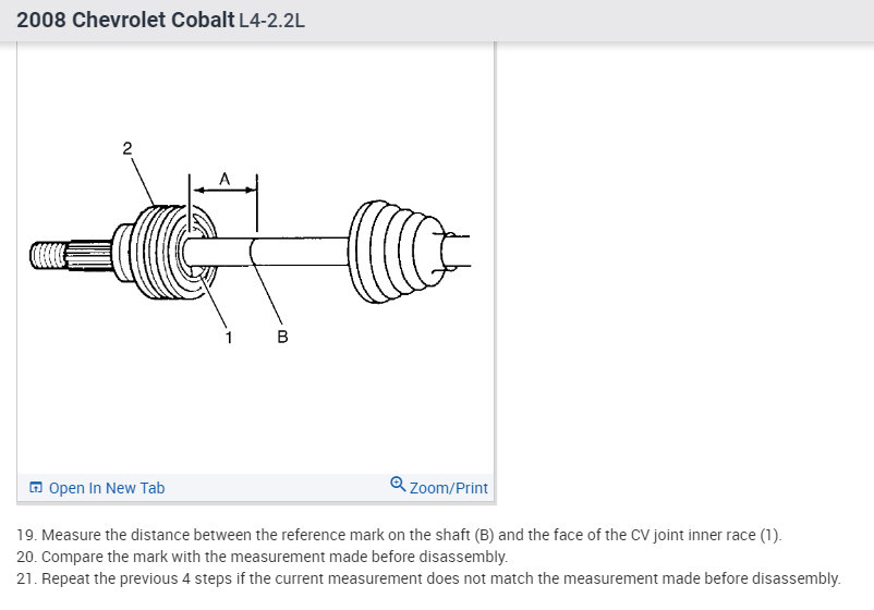

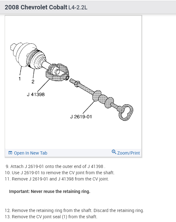

If you have a torn CV boot, you will have grease all over the components. And yes, that can be replaced without changing out the CV axle. However, if has been torn for a while it is possible to have damage to the CV joint that the boot covers and in that case, it will need to be replaced.
I have attached the boot replacement procedure below.

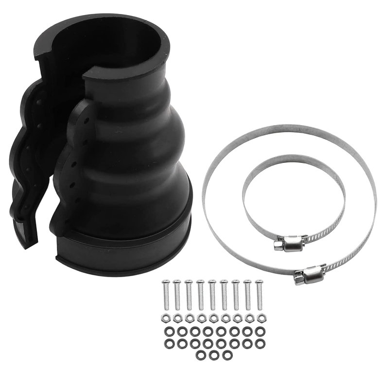

Also, there are quick boots that can be purchased and installed without removing the CV shaft to save time (see the last picture for reference).
Let me know of any questions.
Thank you.

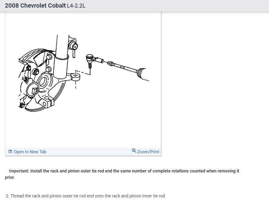

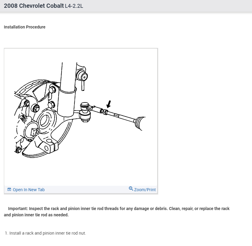

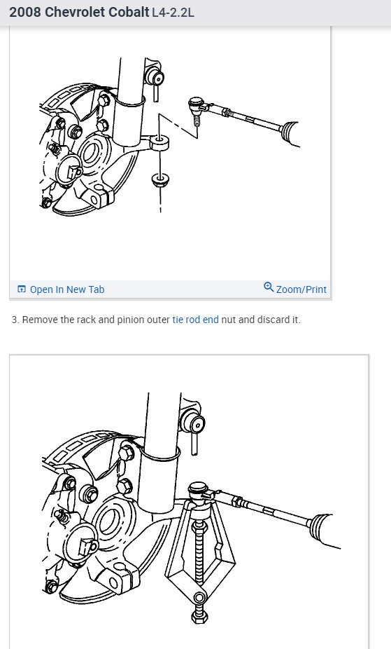

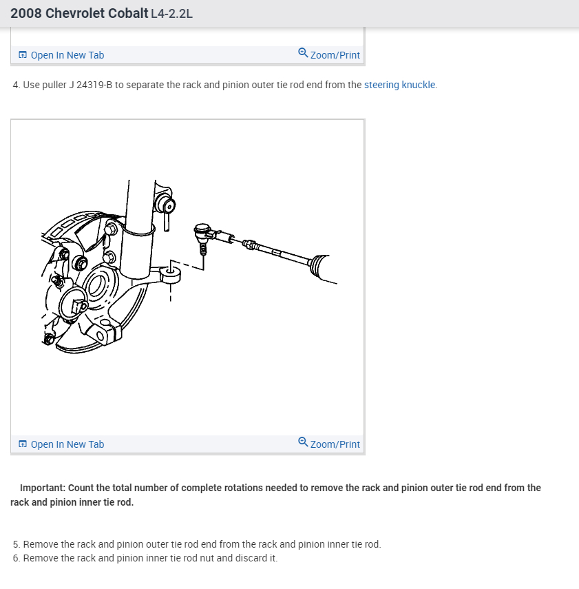

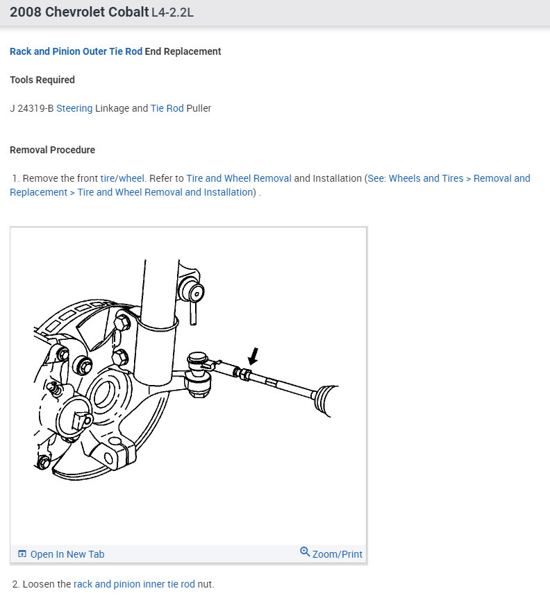

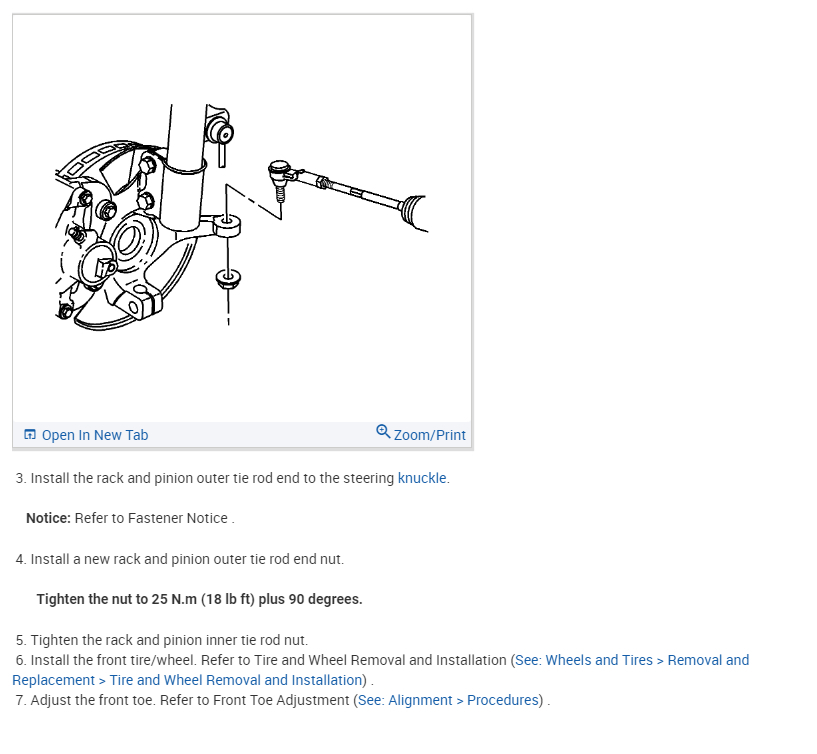

The tie rod end bushing comes with the tie rod and and gets replaced as a unit.
See attached replacement procedure.

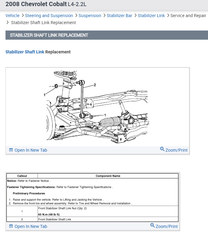

I'm sorry, I keep getting those mixed up tie rods ends with the Sway bar end links.
May 18, 2022 at 11:06 PM
AZDANNO04
  • 343 POSTS
That bolts on the strut and bolts on the sway bar.
SQM
  • 6,383 POSTS
No problem. The sway bar links are easy to replace. See attached.
