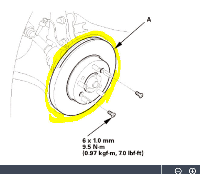

I listened to the video and couldn't hear anything. If it sounds like a metal-to-metal sound, check to make sure the dust cover behind the brake rotor wasn't bent and now touching the brake rotor. It is really easy to bend. Oftentimes, when removing the wheel, the weight of the tire/wheel drops, and it hits the dust cover and bends it. See pic 1
If that isn't the case, let me know if the sound changes when you press the brakes.
See pic below.
